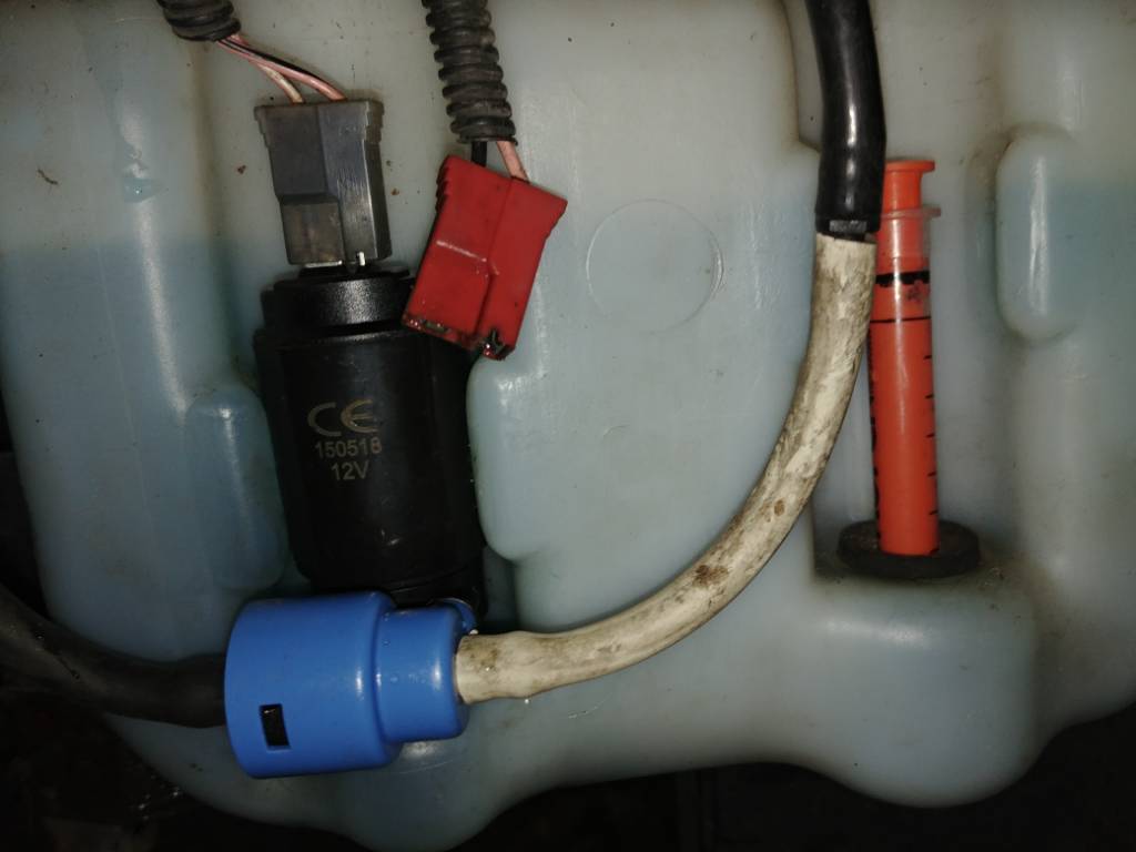

To add to WMFs accurate statements, it is possible to get the wires round the wrong way. I know because I've done it. Unfortunately it's a pig to get to and you need to take off the front bumper. Not especially difficult - just time consuming.
In the photo below the connectors are round the wrong way. Oh and where the calpol syringe is should be the headlight washer pump. [emoji2] 20181206_191026.jpeg
Thanks for all your replies, I have also looked at the handbook now, it would appear that my wires are crossed or more likely pipes on the wrong way round as the windscreen washes when you push the stalk away from the wheel, still strikes me as bizarre how the rear wiper operates automatically with a washer squirt but the front doesn't - that's the Italians for you ??
Don't swap the pipes over mate, cos if you push the wash stalk towards the screen and your fronts operate it's WIRED the WRONG way round, it should operate the rears when you push and the fronts when you pull.
