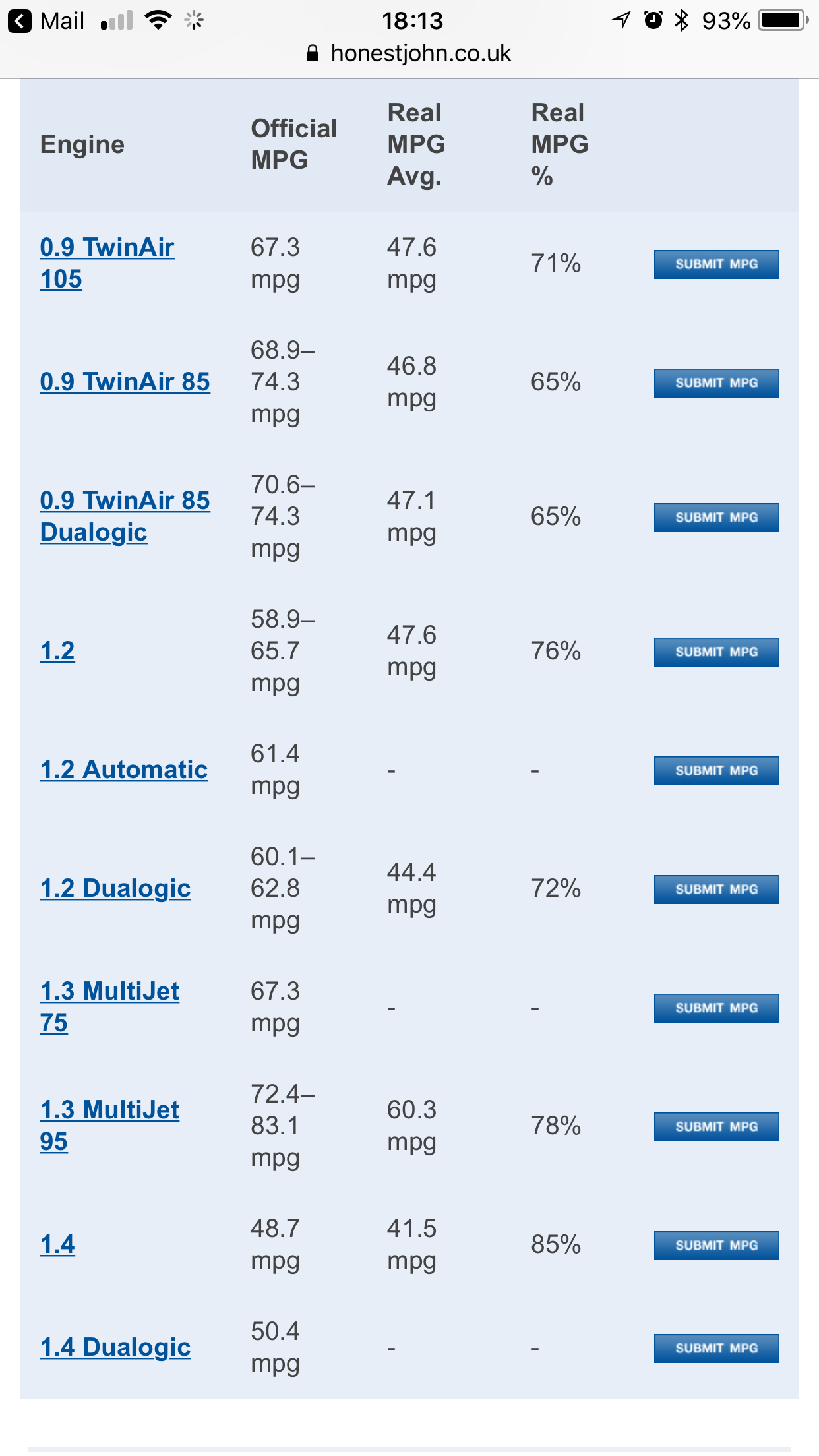

The survey says no unfortunately. The whole point of tests is to give people a good example of what their car will do in the real world, the Twinair is clearly a fail in this regard.
