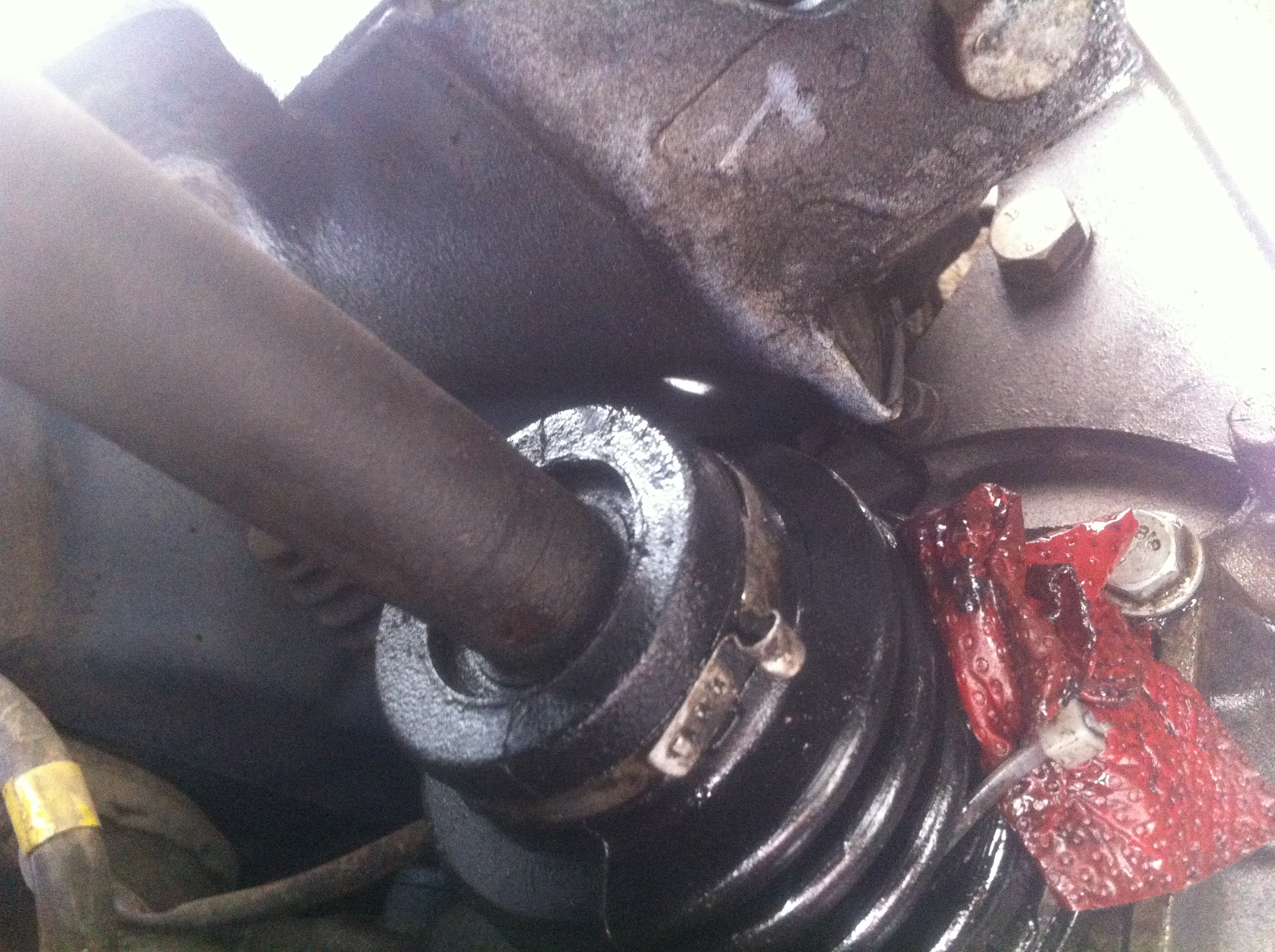

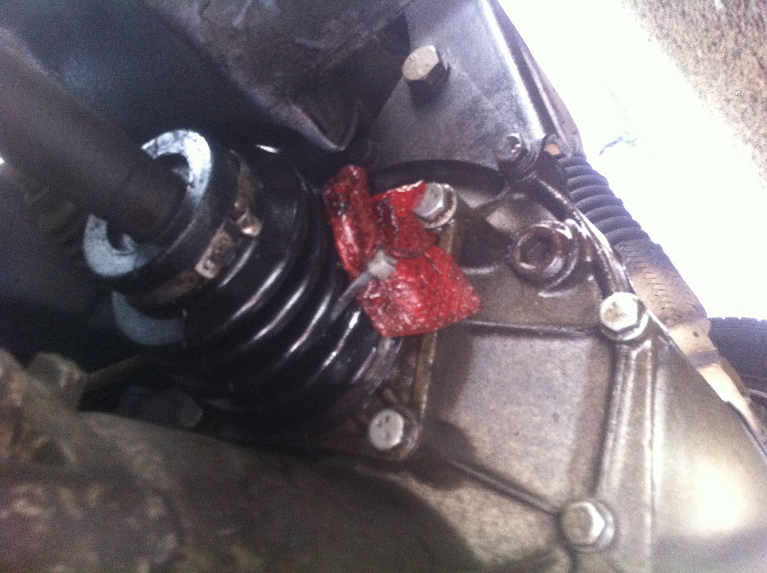

Hi. Thanks for swift and detailed response. Still confused what cv gaiter to get if I avoid the fiat dealers with bearing included for £33.
Ive attached some photos of my gaiter (complete with temp oil stopper!) can anyone direct me to right part as i want to do this wkend if possible.
europarts store near me has a boot kit that may be right but 19mm/93mm/58mm
I measured mine and its 90mm long, small inner diameter going over bearing 30mm, and other end roughly 80mm ? cant see any online with these rough measurements. Do I have to cut a universal one.
Thanks and sorry to be a newbie pain, but this job will test me to the core !

That looks very much like a non-Sporting (wet shaft) box. If it is, chances are you don't have a Sporting, but an S or SX, and don't have a reverse detente (or a rev counter).
Forget eurocarparts, get onto Mick at eurocarcare.net in the morning. No idea where you are (you didn't fill in the form to tell us) but he's in Derby. Your Vin is on the V5 (logbook) or on the plate on the front of the car.
Keep a check on the gearbox oil level -- if it gets too low, the gearbox will be toast.

Hi. Im in Cardiff.
Yes sorry I realise its a seicento S not sporting. I have been topping up oil level. Ill try eurocarcare then with my VIN. Thanks. Just wanted to get one from a store for wkend if possible!

When I did mine a couple of years back I just went to a local motor factor and they got a boot from my chassis number. Was only about £6 if I remember right and came with grease and new clamp metal ring thingy's (whatever they're called).
Ian.
