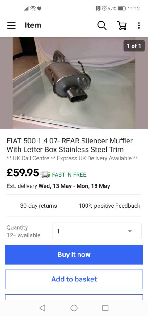

Cheers mate, the reason I'm so confused is our car parts shop before it closed down said there was 2 a normal one for 45 quid and a sport on for 70 quid. It has sports mode so dose that make any difference [emoji848] I know if you press it it goes like the clappers lol [emoji1787] pressed it for the first time the other day and nearly took off [emoji851] quickly turned it back off. I seen this one on eBay.
The pea shooter but the oval lounge chrome ended one was only about £10 more.
As its the 1.4, its most likely different. The oval one on the 1.2 looks exactly the same but I've never had a 1.2 so I'm not sure. There are others on here with 1.4s I'm sure who will be able to advise.
Maybe the diameter of the main pipe is different, i.e. a wider bore. Not sure, sorry.
