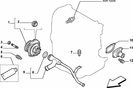

From the front of the car, it's bolted on to the right hand side of the engine, item 11 in the picture

The diagram in post #2 is for the previous type without the temperature sensor that's used in the Euro4 1.2 up to mid 2010 (and likely earlier ones still). This type tends to fail open (there's an internal seal that perishes, allowing coolant to flow when the thermostat is closed).
