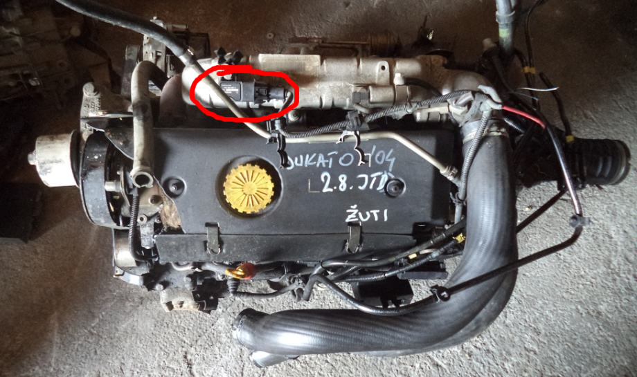

Here is MAP.
A 2004 2.8l will be a 2.8jtd, on which EGR was an option.
The Mass Air Fflow sensor (MAF) is only included when EGR is fitted.
Even if EGR not fitted, a 2,8jtd must have the MAP sensor on the inlet manifold, as @Kahcorp has stated easy to see,look towards the RHS of the vehicle.
