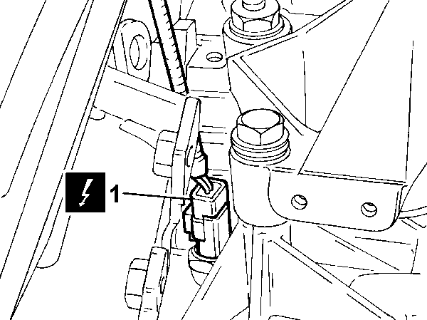

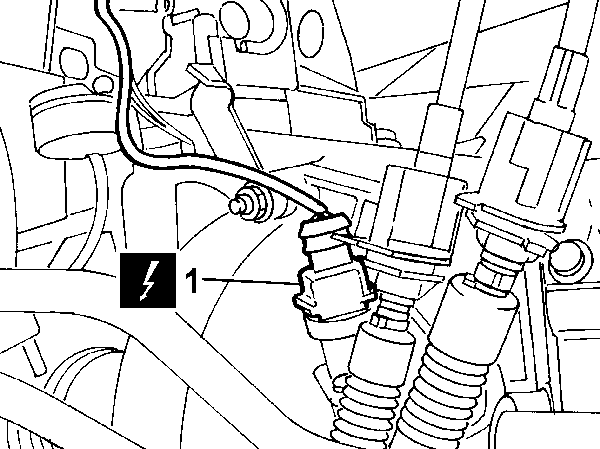

Hi
the way to fill the gearbox is through the speedo sensor ( which is on the back side of the gearbox from underneath the vehicle ) but there is a special tool for the correct level - it holds 2.7 litres & you must use the same specified oil namely TUTELA ZC 75 Synth API GL5, MIL L 2105 LEV
Attached pics - left side speedo sensor near the gearshift cables, the right is the reversing light which is on the front side of the box under all the intake pipes.
