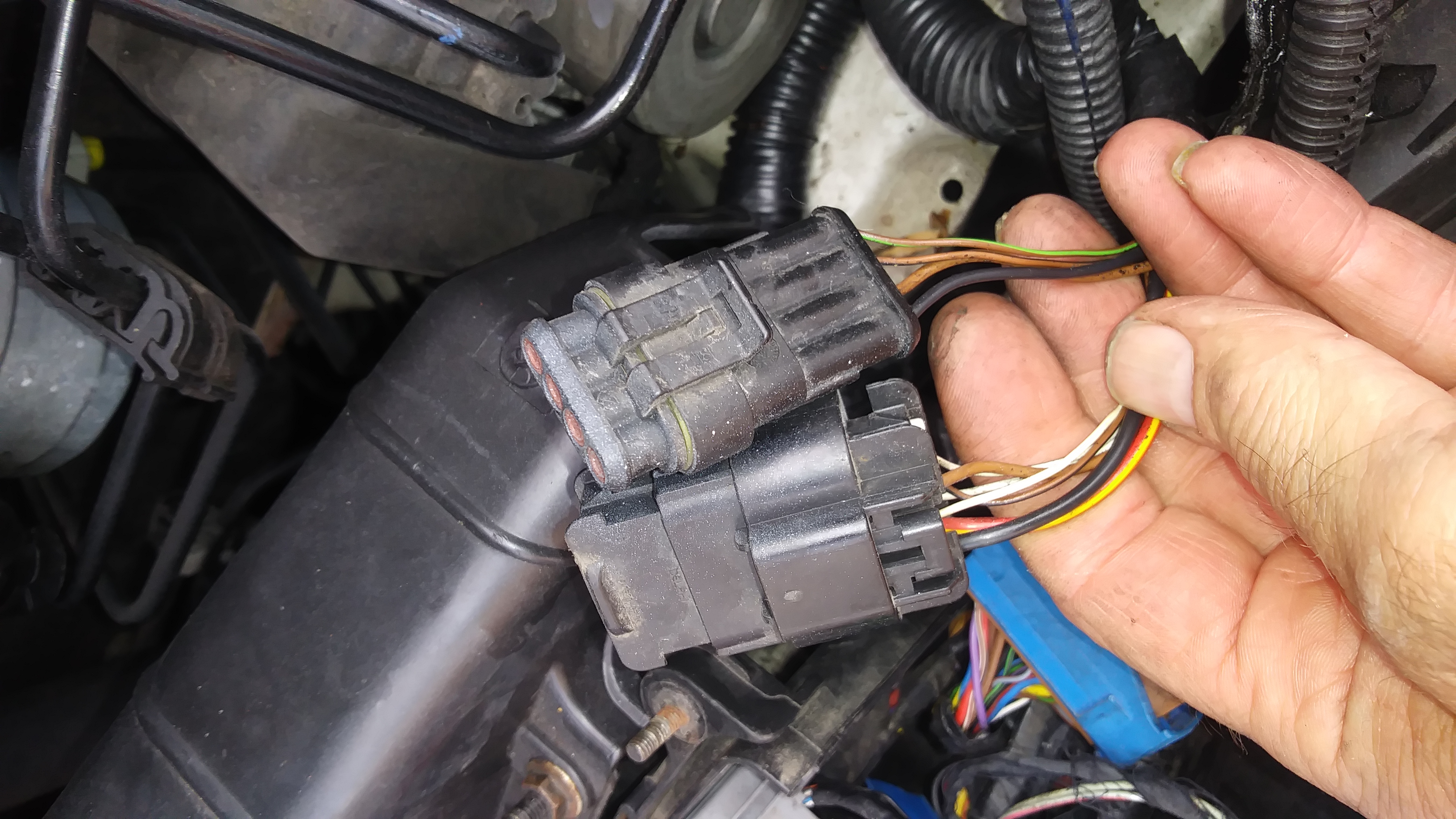

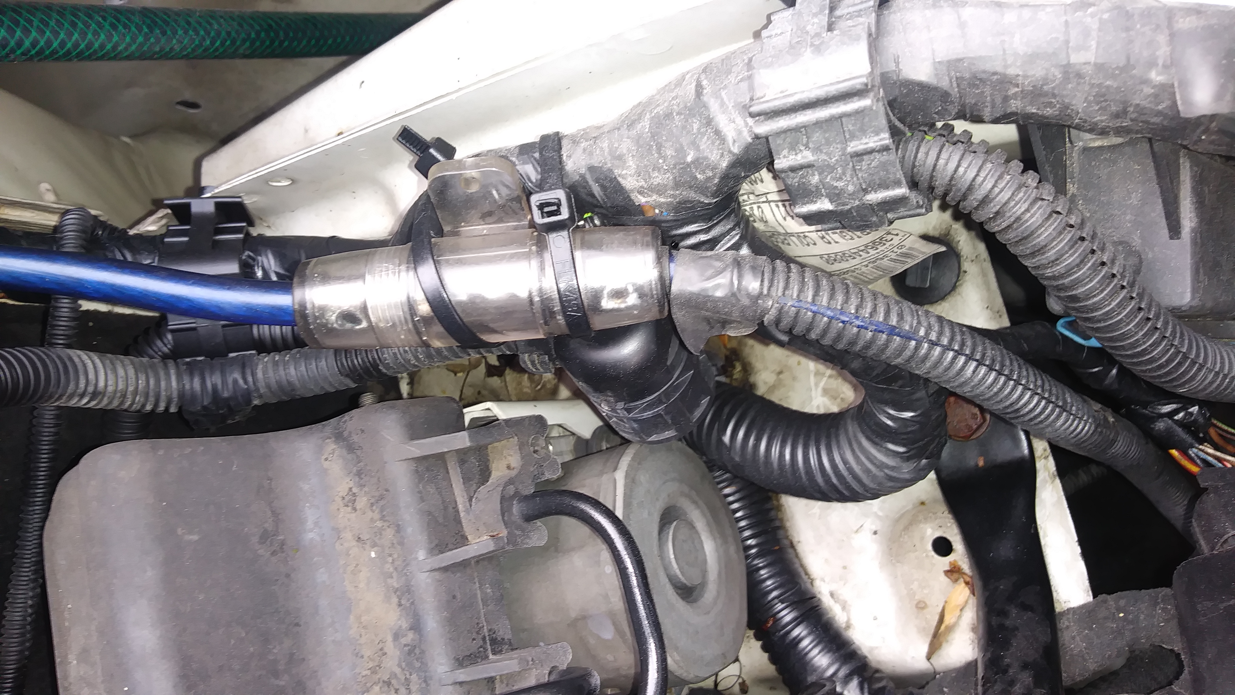

Can anyone tell me what the big fuse serves and the 2 capped off wiring parts I am holding ?

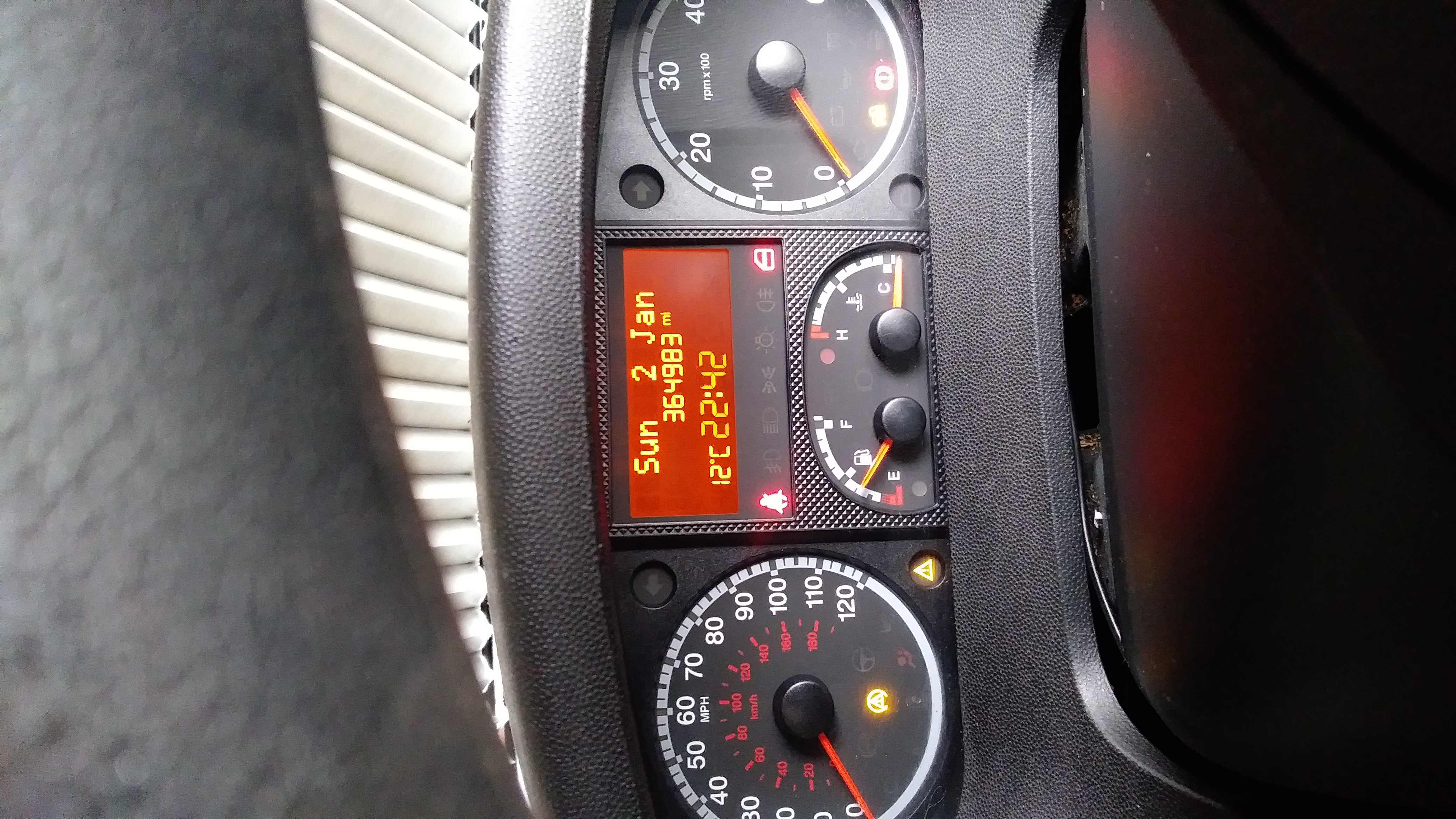

Lock symbol. Do you mean key symbol with CODE written on it?
That is immobiliser on older vans. Fuel will not pump if this is lit.
Check and replace earth leads around engine or add some too! Try disconnect earth lead for battery count to ten and try engine again..... Cures mine temporarily.

what i have done so far is remove ns headlight, clean up everything, nthing really looked amiss. Checked all fuses, made proper any shabby cable coverings. removed the old earth strap and replaced it with a new 6mm pure copper strap, scraping to bare metals for good connections before fitting.

i have added some pics of the log book and the dash lights, if you need more just let me know.
i wondered whether it could be to do with the starter motor but would that cause the immobiliser problem. it just turns over and over and the light stays put !!!!

I have continuity between pin 87 of T10 relay and pin 1 of pump.
I have earth at the relay T10 but no 12v.
I have no pos at pin 2 of the fuel pump in tank.

Tonight after 5 nights of cleaning, testing, contnuitying and all other sorts of tasks i tested for a positive at the plug on the ECU. Pin 91 which i understand is the power to the relay T10 in the engine fusebox to be exact. I had no feed there either so dejected i put the plugs back into the ECU, put the cover on, put the fuse box cover on and tidied up. As i have done every night i tested the ignition and wow, off went the pump and after 4 or 5 turns of the engine it fired up. Now i have no idea what the problem was, or indeed still is.

when the van started tonight he had not tightened the injector properly and i had diesel spraying all over the engine and bonnet cover, i had a quick dash warning mentioning the diesel filter but turned the engine off. After that it would not fire again so i had a go at the injector with a 17mm spanner and got a slight movement tightening it. I tried the engine again and it went straight away. The symbols have disappeared off the dash now and the injectors are sound.
