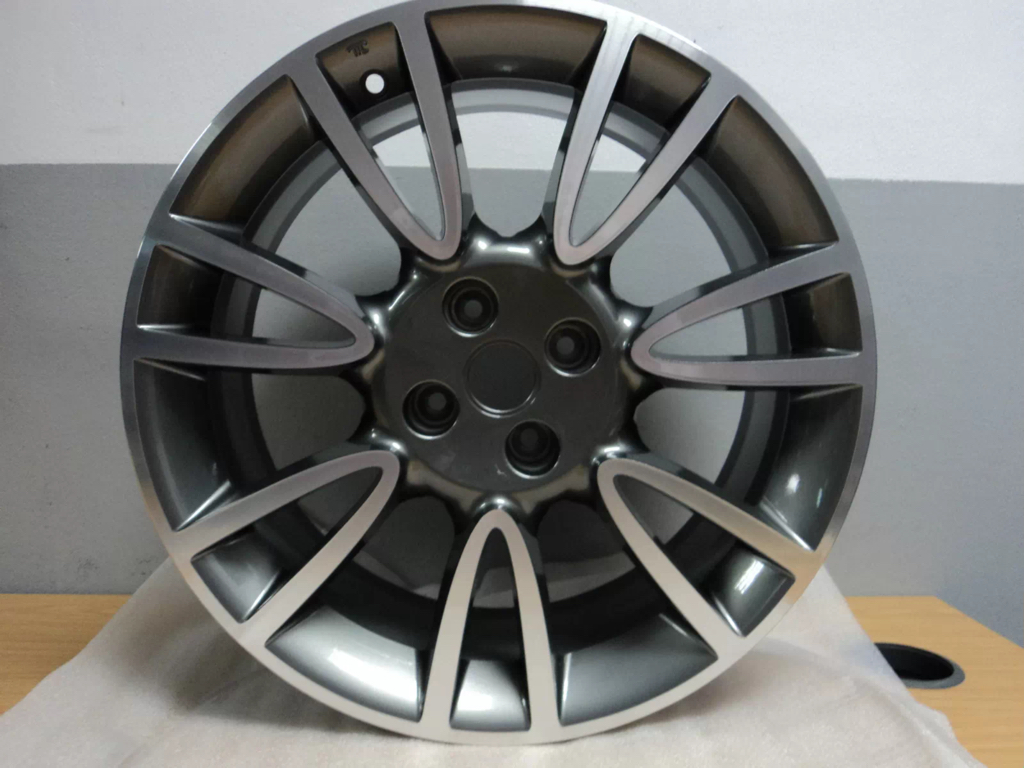

hammy1990 New member Joined Aug 13, 2012 Messages 57 Points 13 Location Wrexham Dec 23, 2014 #1 Hello everybody, can anybody help find the size of the centre bore and offset of these wheels I have on my bravo, as I am going to buy some new alloys.
Eklipze3k No strings on me Staff member Parked in the garage Written a guide Joined Nov 18, 2007 Messages 18,438 Points 4,435 Location Huddersfield Dec 23, 2014 #2 Centre bore is 58.1mm, the offset will be stamped into the back of the wheel somewhere, something like ET35
RobW fast Fiat fan Parked in the garage Joined Mar 19, 2002 Messages 6,124 Points 1,177 Location Surrey, United Kingdom. Dec 23, 2014 #3 bare in mind that you have have to go for a slightly different offset if the wheels are different/wider you need to trial fit and allow for the purchase of longer bolts
OP OP hammy1990 New member Joined Aug 13, 2012 Messages 57 Points 13 Location Wrexham Dec 23, 2014 #4 I was hoping to get some 3sdm 0.05, I'll do some calculations and use 1010tyre site first before I buy any alloys. Thanks for the replies btw
