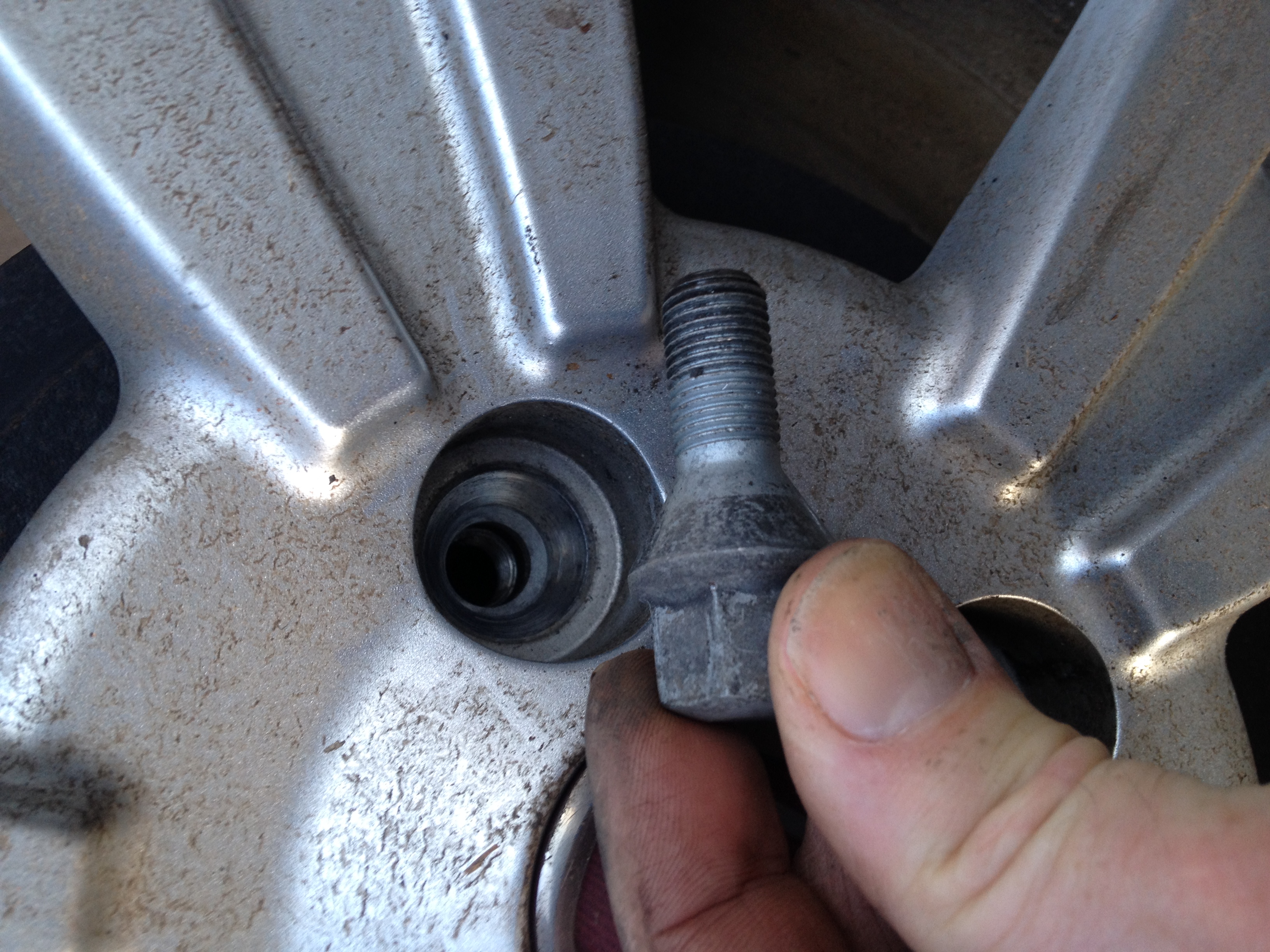

I have the standard alloys on my Qubo and today swapped over to winter tyres on the old steels from the Fiorino.
Can anyone say if the bolts for alloys are different from steel wheels' bolts? The sockets on the alloys are deeper than on the steels although they tightened up ok. Just wondering...
Alloy wheel and the bolts from those alloys showing the deeper socket

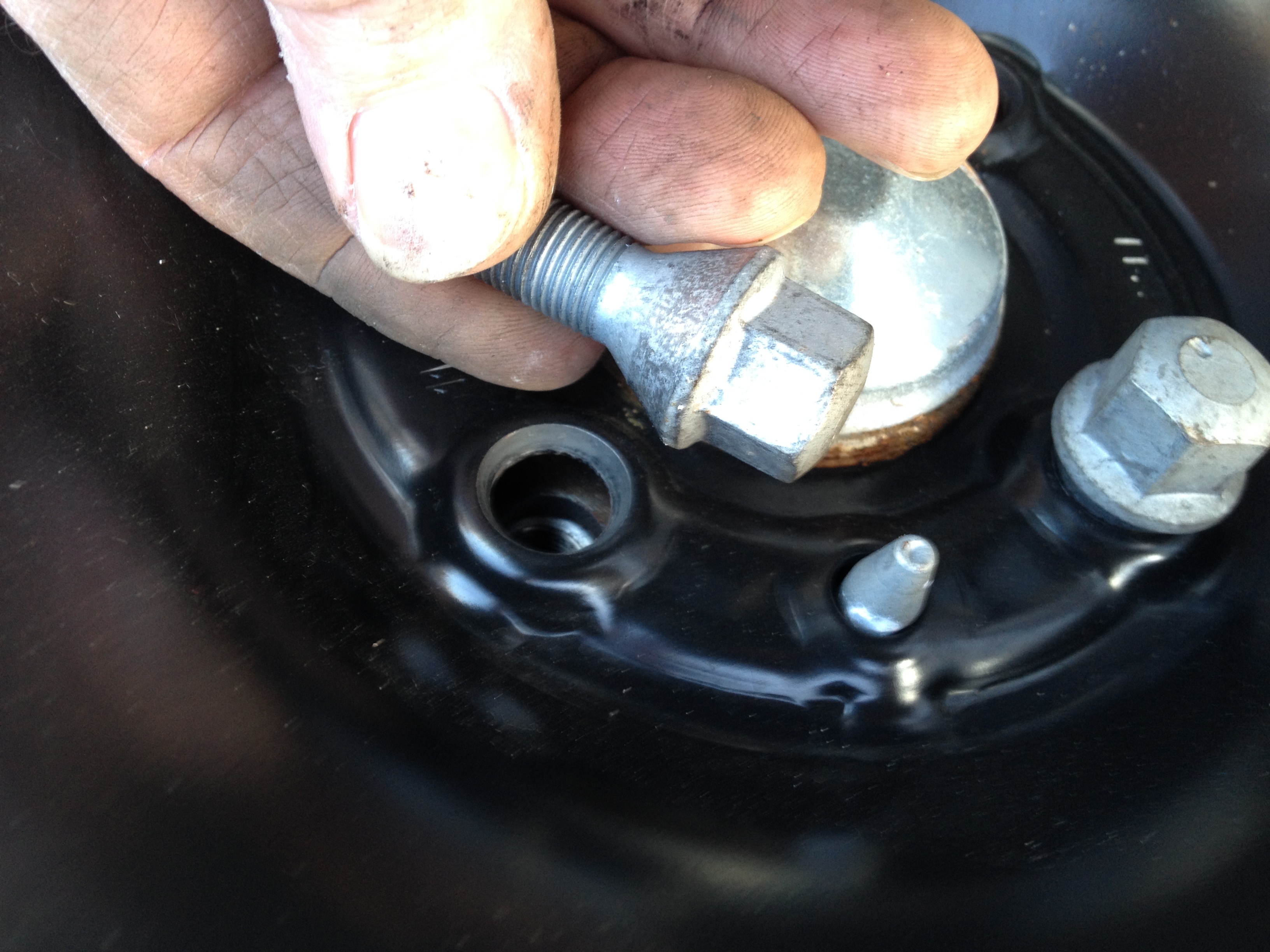

Bolt next to the steelie bolt hole

Yes I agree with MEP, they'll be fine. I have the same alloys as RVM but a steel spare and they fit OK. (y)
