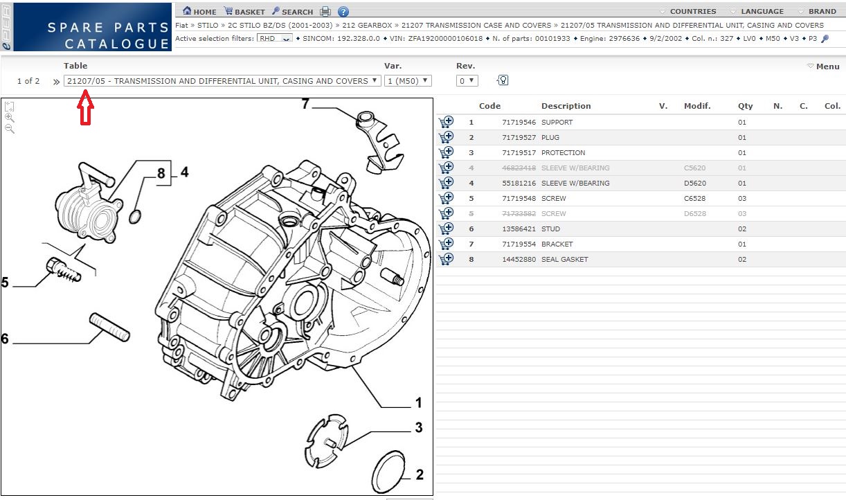

SGR.21207 is not a part number, it means that the concentric clutch slave cylinder is shown in section SGR.21207 of ePer.

Hi Davren,
thank you very much for that info.
I took that ref. and apparently the VALEO 837005 has the release bearing that i'm looking for, with the Valeo reference 804521.
Appart now from the flywheel and the clutch release bearing only the clutch kit doesn't line up with the same reference that i have.
I starting to feel confident that the Valeo 837005 is the Fullpack i need to have but i still have that itch in the back of my head telling me that the clutch refs dont line up.
