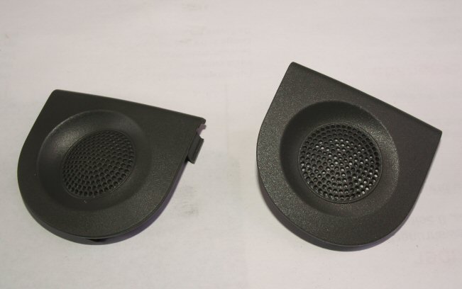

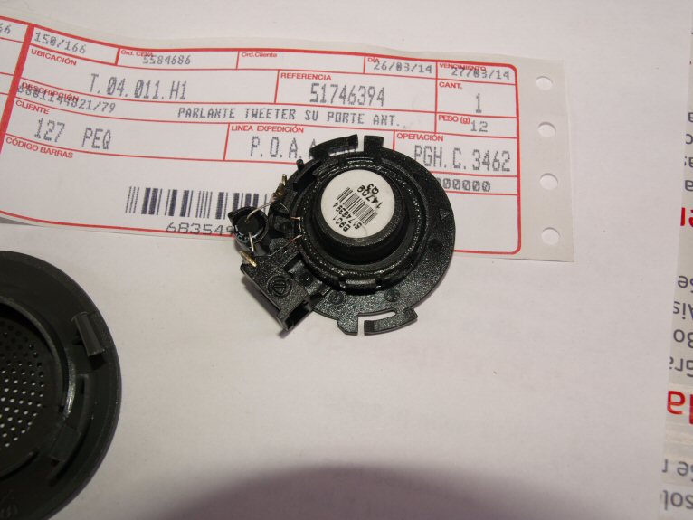

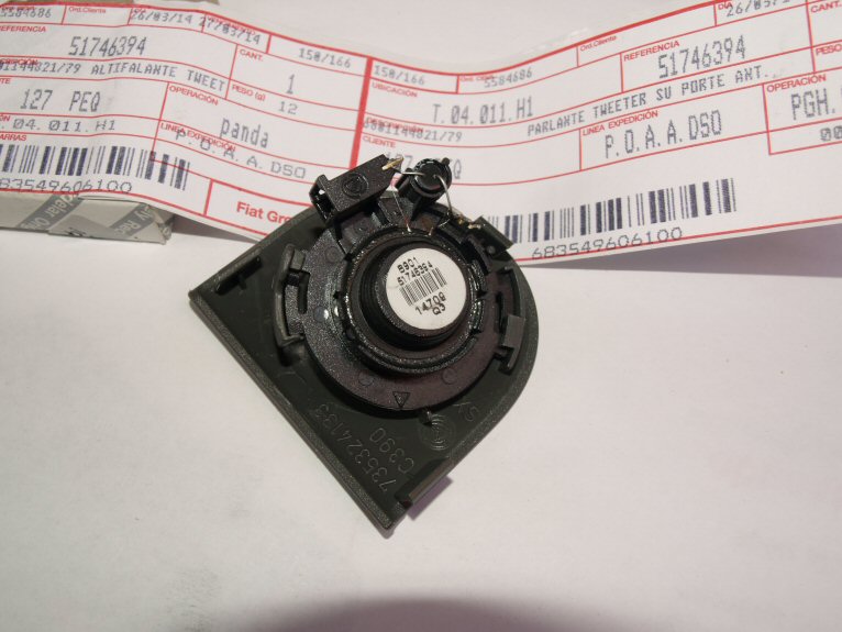

Well, parts arrived - made in Poland and Italy - Here are some images, fairly self explanatory I think...
old 'dummy tweeter' cover, new proper cover, new tweeter, and how they fit to new cover. 37 Euros inc tax for the pair - Fiat (of course) - bargain !.
Nicely made.... as they should be.
Love the filtering (y), so simple.. 4.7 uF capacitor (electrolytic) in series... capacitive reactance at 5 Khz starts increasing causing LF roll off, zilch at 15 Khz so it can pass through - simple high pass filter, way to go...
Well made and simple to fit.
here are the pics..
