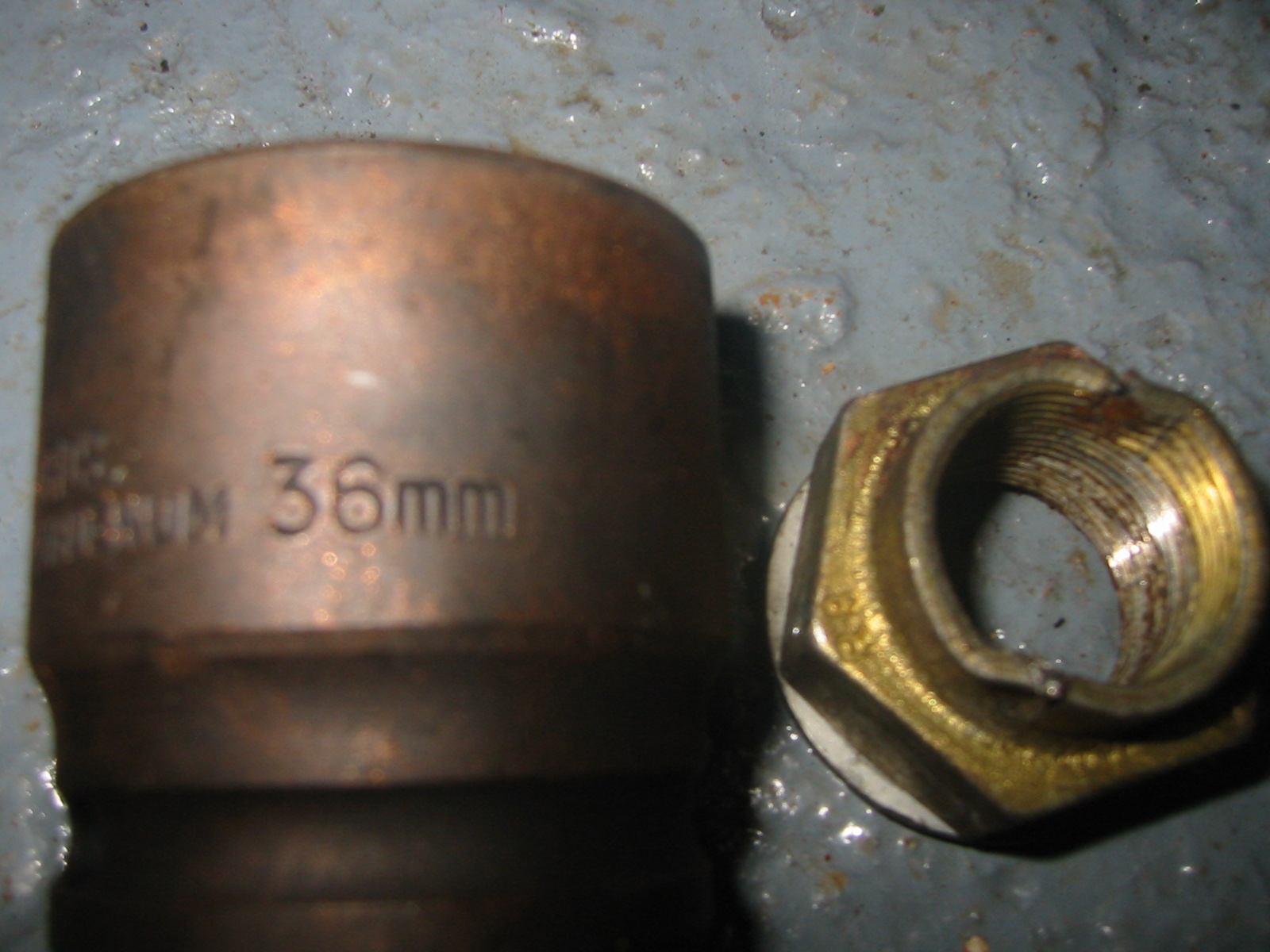

Here is the 36mm which my dad modified to enable it to fit the tapered recess in the hub. The hub nuts, badly mangled by the PO, were removed in seconds by using the brakes with the front wheels on the ground.
Thats a neat job, mine looks like a shark had a go at it lol. But it done the job.
