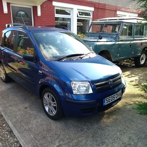

I have just tucked my 50 year old Land Rover in a corner so I can pop the front wheels off the newly acquired panda to try find what's binding and examine everything else.
The Land Rover was my daily driver but has to come off the road as I'm getting the gearbox out and doing some other jobs.
Hope the panda doesn't need anything urgently as my Renault scenic is just about to get discs and pads all round.
So what cars share your drive with your panda?

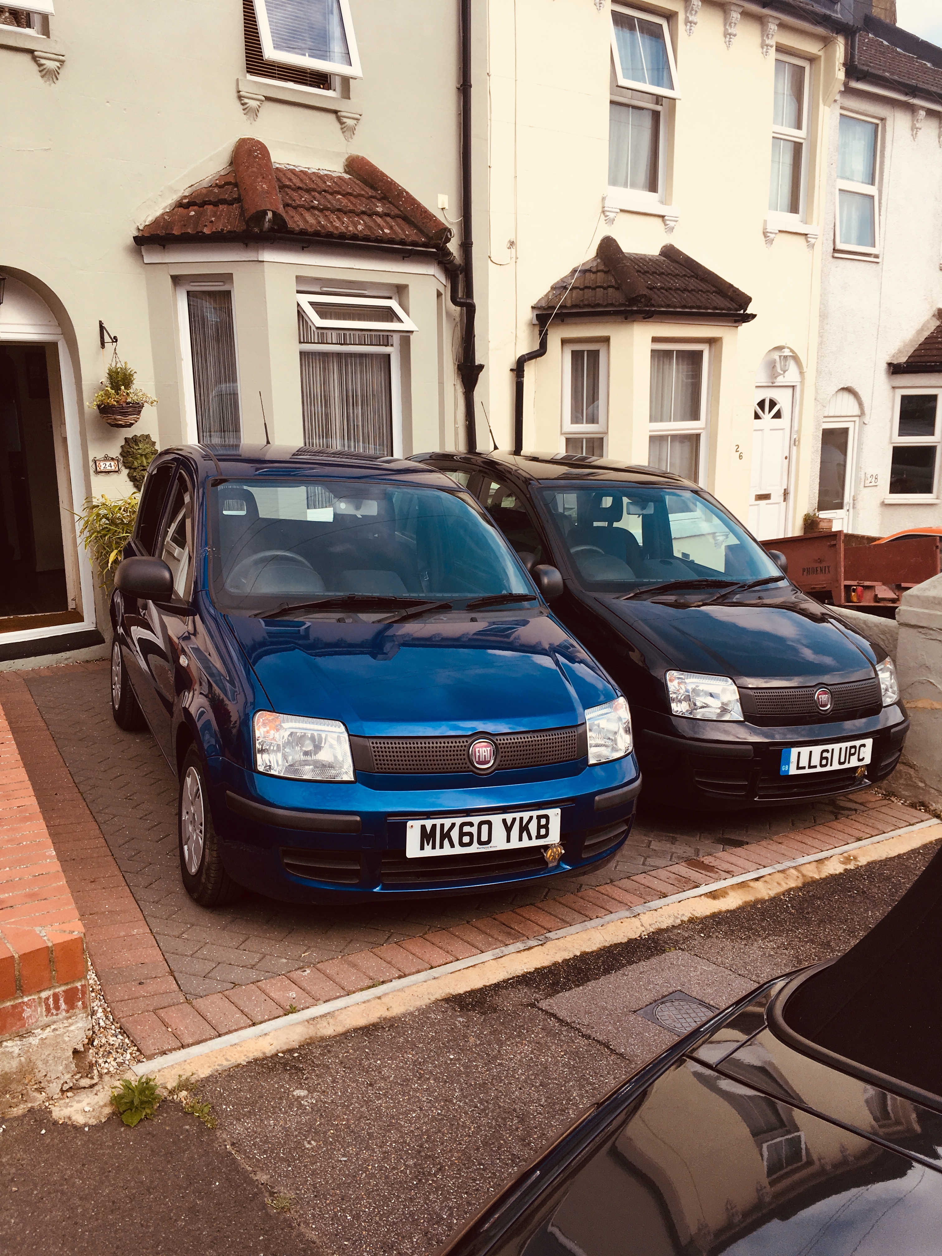

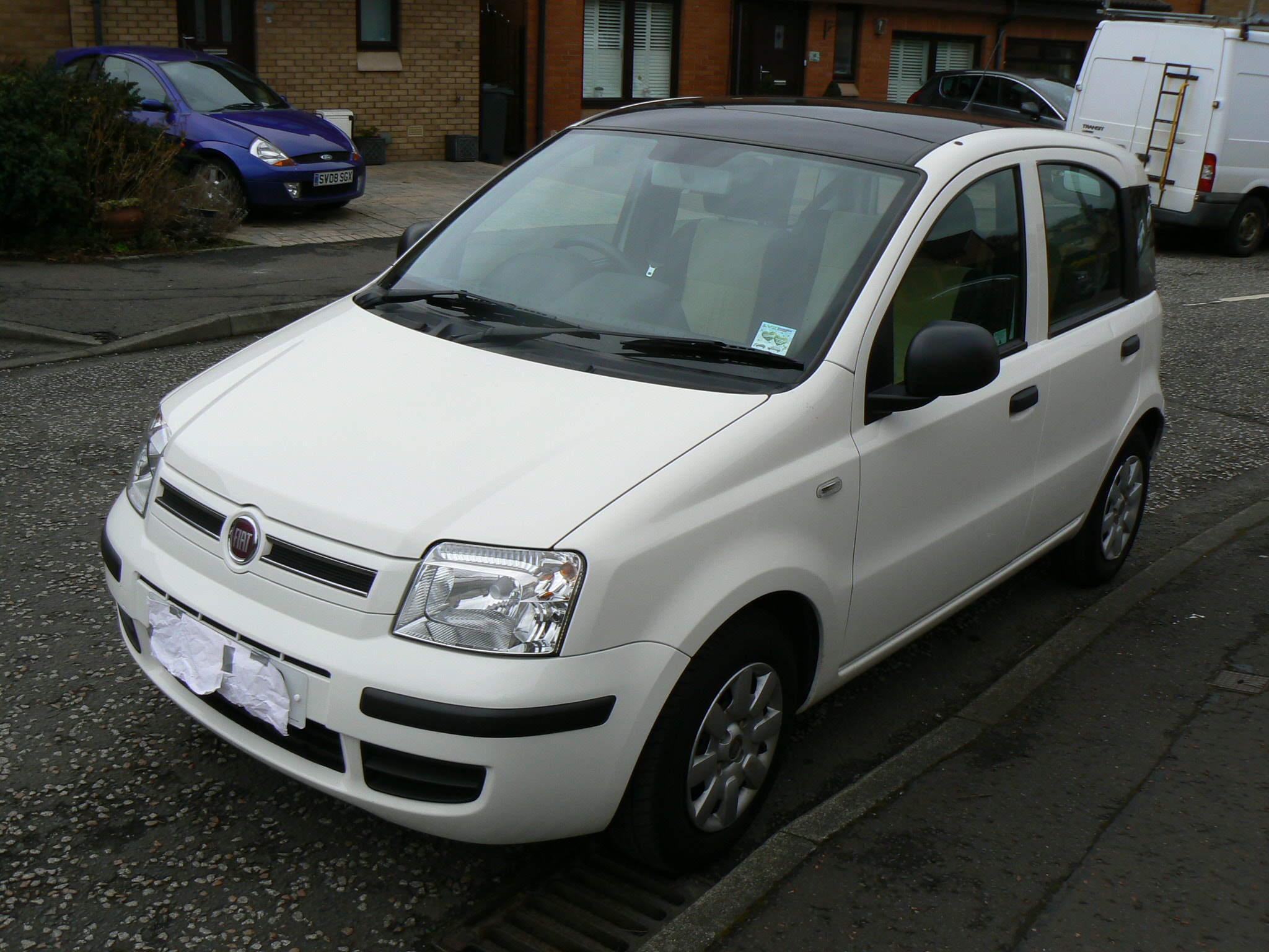

This is Becky:
And this is Twinkle:
Usually Becky would be sitting where I was standing when I took Twink's picture but she's parked by the kerbside because Mrs Jock left her there when she returned from shopping and found me working on the lawn mower.

My Panda likes company, so shares the drive with either my Mazda, or another Panda.
it's a bit of a squeeze mind :eek:

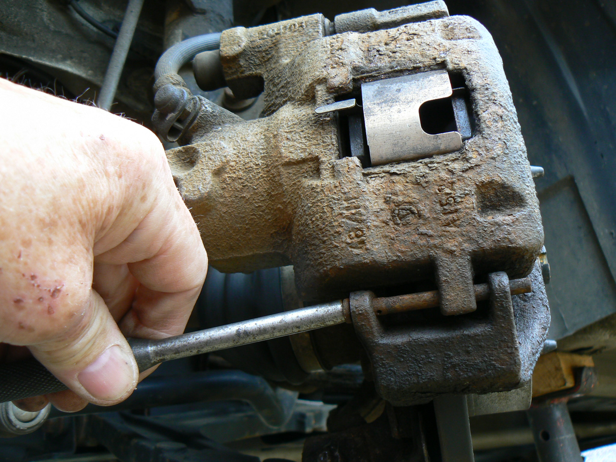

Had the panda front wheels off and then it rained. Dragging front brake so may see if it's a caliper issue (discs are harder to fathom than drums!).

We've had Pandas for many years and semi seized front calipers are common. The old mark ones with their wedge type calipers seemed particularly prone but even our newest one, Becky (I'm afraid all our cars have names) needed attention when we bought her. Usually I find it's just a good clean up and some anti seize (ceramic Ceratec these days) but it's always worth just pushing the piston back a little to see if it's free moving. Not too difficult to do but if you have the type of caliper like mine, with the pin at the bottom, if it's badly seized (ours was) then don't hit it too hard with a hammer/punch as it's easy to break off the little lug. Here's a picture just for illustration. Of course you would be punching the other end of the pin to remove it.
I'm pretty sure there is another type of caliper which uses two bolts to hold it on (as many do these days) which might be easier to deal with.
somewhere I've got a post on here from maybe a couple of years ago about freeing of Becky's front calipers if you can be bothered trying to find it. If I track it down I'll post here.
PS Hey, I found it already - the bit about Becky's brakes - Type into the search bar "Becky's brakes - a few surprises" and it should come up.

Cheers for the help and advice I will try fettle the calliper tomorrow. The passenger side is ok so hopefully that rules out the master cylinder.

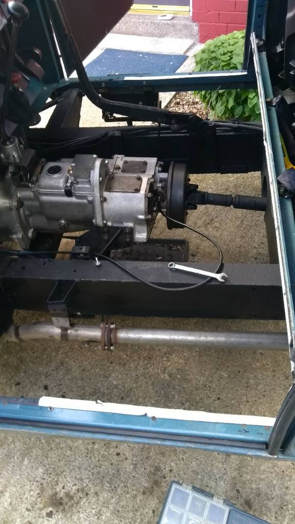

I'll be getting the LR gearbox out the passenger door as the cross member stops me dropping it down. Getting it out is a lot easier than lining it up to get it in!

Regarding that little lug which can be so easily sheared off. It's part of the caliper carrier not the caliper itself so if you break it off you're probably going to be spending some time rooting around in scrap yards looking for one that can be saved (and if you find one it may well have a seized pin in it!) Just annoying.

I got the caliper cleaned and seems to be ok but only time will tell. It does have brand new pads which is good and the discs are good too. The rear drums are super rusty but seem solid also. If I get time I may wire brush and paint them when I do the rear axle.

The LR has a drum handbrake on the back of the transmission box. Fortunately that bits relatively easy to do but the inside of gearboxes us witchcraft to me. Usefully I have a mate who currently repairs commercial buses but was a Land Rover Master Technician until recently and knows pretty much everything.
