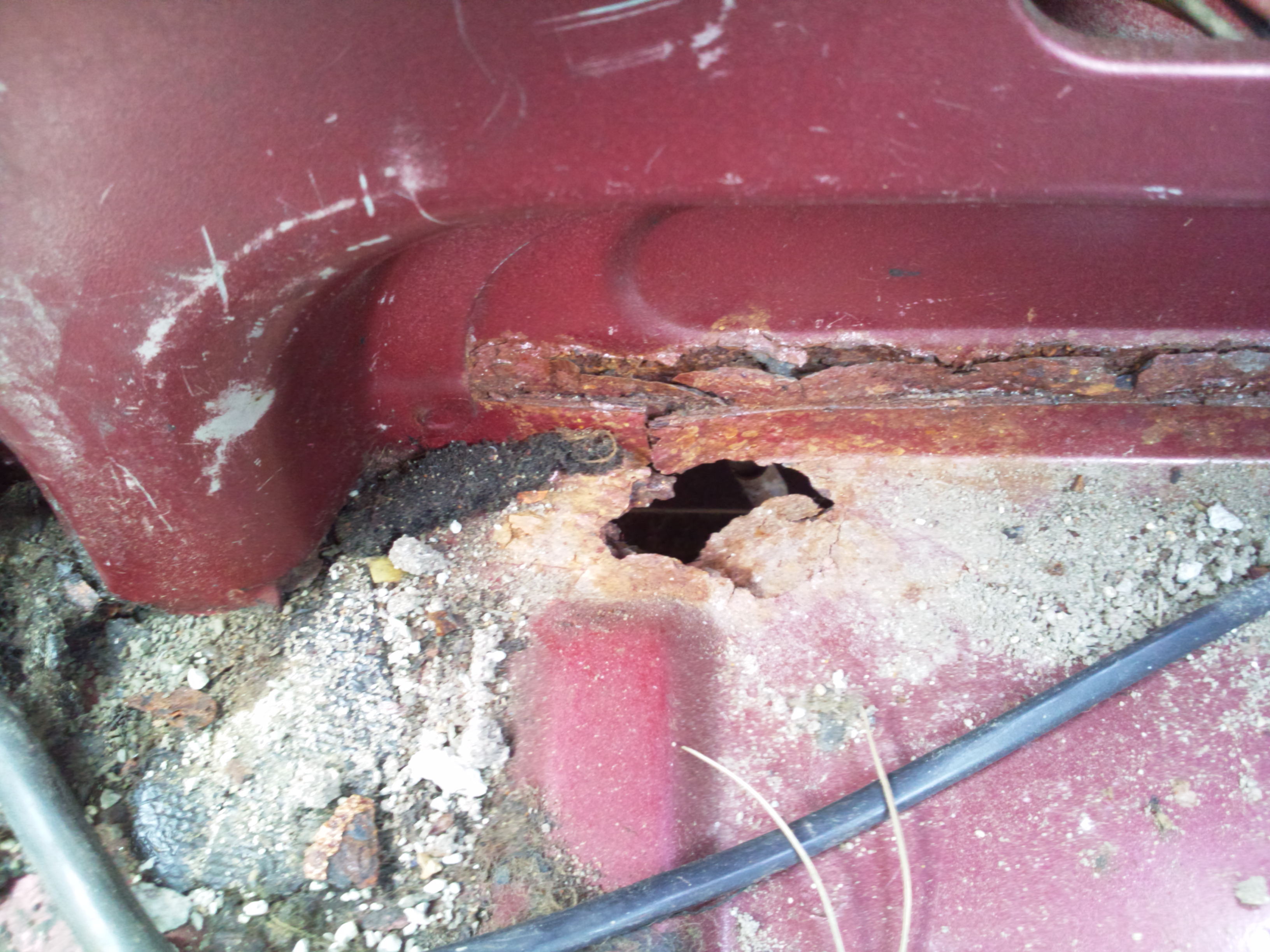

Just cleaning the Sisley up ready for eBay and noticed this
So much for a clean car

Sorry MEP don't like the look of that!
Hard to imagine that that is on the inside of the car!
Get the welder out and cut your losses
Must admit its the first place i look at when getting a panda...iv been lucky so far...
Looks like an MOT failure if its more than just the hole..although im no expert...why not see how much it is to be welded..then at least you could mention the cost on the listing if its quite cheap...
That's what mine was like. I expect the rot will have got into the structural rear cross member too, so it would be an MOT fail. That said mine passed an MOT in a pretty bad way the year before with a lot of rot on the rear cross member.
Hope she sells ok, but that will definately devalue the car. Might add lots of value having it patched up in time for the auction end. But obviously it is up to you. I expect if you find a good (value wise) welding place then it would be around £80.
Unfortunately, the buyer will probably make their mind up when they collect the car anyway, making a long-winded description pointless. My buyer collect the 4x4 today and admitted he hadn't read the description before buying it! He was over the moon with what he found though!
Rust needs to be in "structural" or load bearing places or in a "prescribed area". Namely 30cm of the sill, any seat belt anchorages (rear lower seat belts in your case) or suspension pick-up points. As others have pointed out, it the inference of more rust that is most worrying, rather than just the bit we can see.
