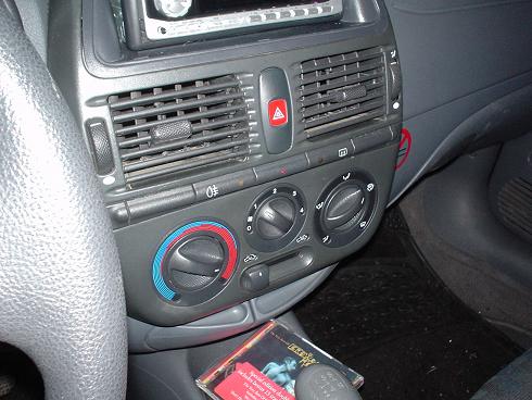

I bought a Brava 1.6 '96 a few weeks ago. I noticed this red LED (in the middle of the picture). I have no idea what it's there for and I have never seen it lit.
Can anybody tell me what it does? :confused:

Hmm... there shouldn't be an alarm installed - atleast not as far as i know.
Think I better take it apart and see if there is any wiring behind it :)

He he... no :) - just about an inch below it... you can't see it on the thumbnail, but click on the image for the larger version.

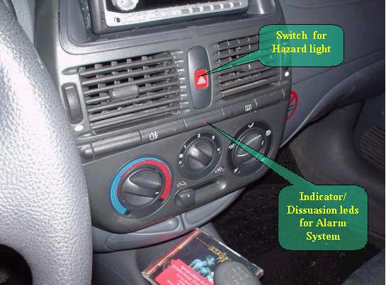

see photo....
The dissuasion Leds is able to notify the user of any anomalies in the system thru number of flashes 4Hz. If an anomaly of fault is present, the system causes a dissuasion LED to flash to indicates which sensor triggered an alarm during surveillance. E.g.
Constant Light= Transmitter battery flat (in the key)
1 pulse= right front door…2 to 8 pulses....etc, etc
9 pulses= direct power source
10 pulses= At least 3 causes of alarm

i has the same thing on my bravo 1.6 that i bought on monday. book says its an alarm indicator but i think that its been disabled because the previous owner never had the key for the alarm.
i have the same thing in my brava, - i have no alarm and it is not connected upto anything! i believe its there for an alarm if one were fitted!
- i had planned to wire it upto an alarm i bought from alfa nige but that alarm didnt get on with me and is now disconnected! (long story)
