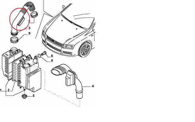

Pipe between number 3 and 7 - there's a box on the underside of the piping - what is inside it?!

Pipe between 3 and 7 is the main pipe to throttle body..the pipe 4 is the one that sucks air in from under the bonnet to filter box..if you look hard on the car you will see a little slit where it sucks air in.. the box on the underside of the pipe you refer to is there as a baffle/resonator and the one on the pipe 4 does the same.. (y)
Main airbox has a replacable filter when it gets dirty.. thats your guided tour of your cars filtration system..:p
Now dump it and get a gsr one..lol

Yeah, i understand the ventilation system, I was confused about what's in this particular box (below)! Basically, if i lop it off and redo the intake system then will anything untoward happen?!

I replaced mine with a BMC panel filter which improved the airflow at the top end of the rev range, because i don't think the old one had ever been changed, all flies and crap fell on my face when undoing it :yuck:
Nope, I'm investigating various options in improving the efficiency of the intake system, all those bends, and the box especially, are losing efficiency and ultimately performance

Reverse to the flow it comes out of the throttlrbody doing about a 90 degree turn going forword and doing about a seventy degree turn going downwards ending up below the battery with the filter element.
