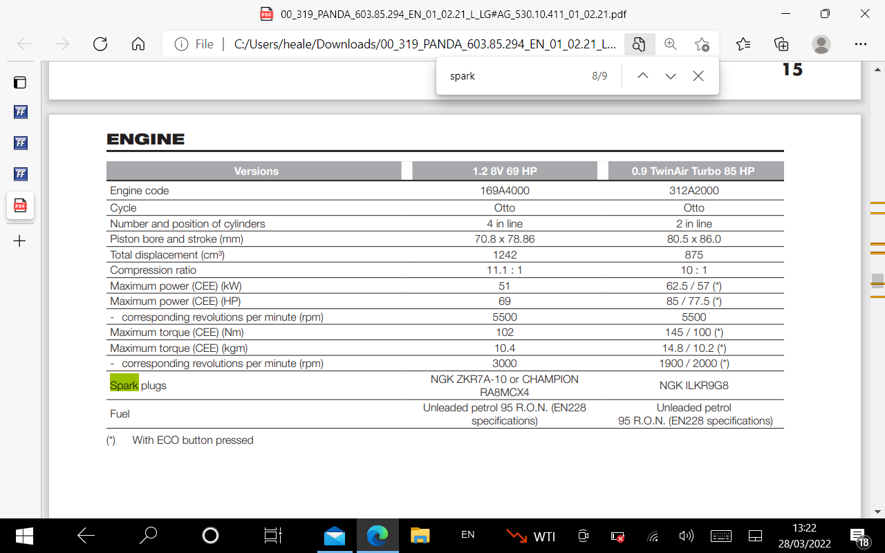

is there a crossover date or engine code / serial number
in the later manuals
hi
when you check that page it says the upgrade from ZKR7A-10 to iridium is ZKR7AI-8 and is gapped at 1mm gap (pre-set), but the code -8 denotes a gap 0f 0.8mm, would this then cause, bad combustion/spark hesitatiion etc.
I tried thesse and returned them because of hesitation and poor economy (4mpg less), motor factors said not to adjust the gap else warranty would be lost, so went back to ZKR7A-10 and no problem, still would like to upgrade my plugs hense the question.
in all honesty I have no idea
