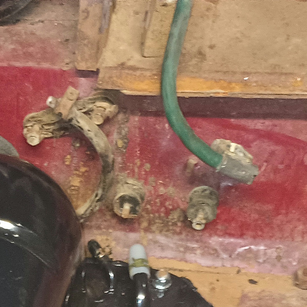

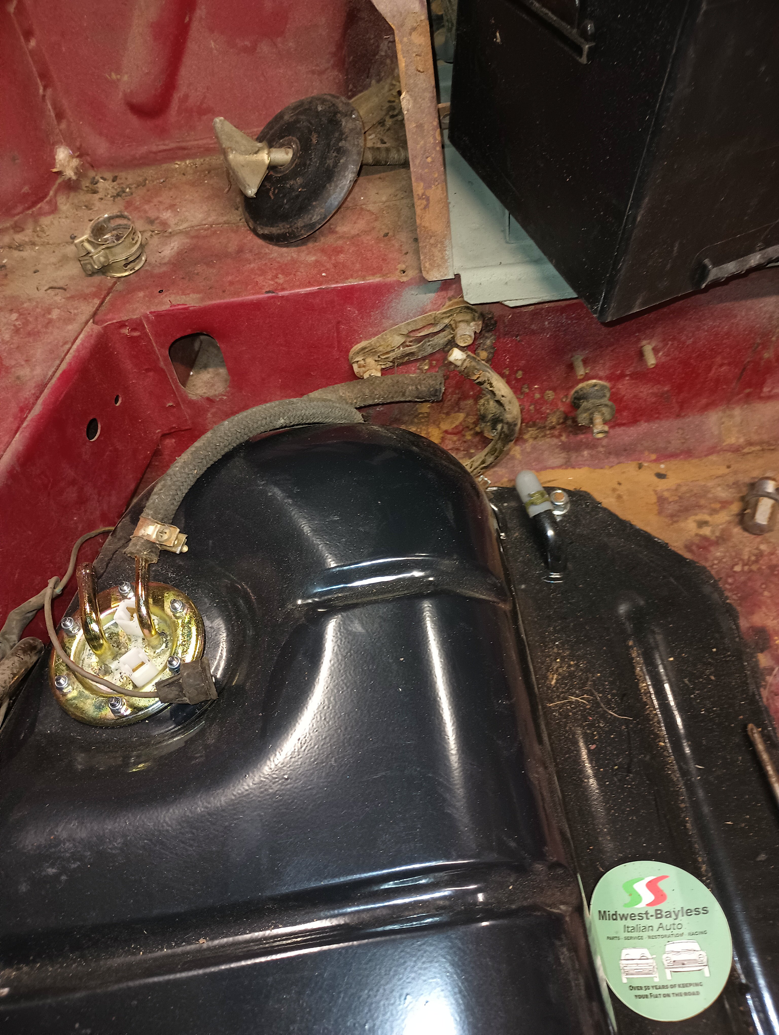

M Mandoknight New member Joined Dec 28, 2020 Messages 4 Points 1 Nov 26, 2024 #1 On a 77 fiat 124, what is suppose to mount here. Any help would be great.
B bugsymike Patron member Joined Jul 2, 2022 Messages 8,642 Points 2,839 Location Torbay Nov 26, 2024 #2 Can you circle the exact area you mean? Upvote 0 Downvote
OP OP M Mandoknight New member Joined Dec 28, 2020 Messages 4 Points 1 Nov 26, 2024 #3 Mandoknight said: View attachment 455943 On a 77 fiat 124, what is suppose to mount here. Any help would be great. Click to expand... Upvote 0 Downvote
OP OP M Mandoknight New member Joined Dec 28, 2020 Messages 4 Points 1 Nov 26, 2024 #4 Here is the area in question? Upvote 0 Downvote
B bugsymike Patron member Joined Jul 2, 2022 Messages 8,642 Points 2,839 Location Torbay Nov 26, 2024 #5 On the rubber mounts? Any chance someone fitted an aftermarket fuel pump or filter? Or is there any emission reg. equipment laws near you? Breather filters etc. Upvote 0 Downvote
OP OP M Mandoknight New member Joined Dec 28, 2020 Messages 4 Points 1 Nov 26, 2024 #6 No emission requirements. Probably a fuel pump. Anyone with ideas. Upvote 0 Downvote
1 124BC1 Established member Joined Dec 11, 2021 Messages 351 Points 159 Location Ireland Nov 26, 2024 #7 Electric fuel pump, here's an original complete with mounting bracket :- Fuel Pump Electric - BCD (Fiat 124, 128, 131, Lancia, Ferrari) - CORE Fuel Pump Electric - BCD (Fiat 124, 128, 131, Lancia, Ferrari) - CORE midwest-bayless.com Upvote 0 Downvote
T Twink80 Member Joined Mar 8, 2025 Messages 146 Points 101 Location Wales Mar 9, 2025 #8 Mandoknight said: View attachment 455974 Here is the area in question? Click to expand... Most likely an electric fuel pump mounted on the rubbers Upvote 0 Downvote
