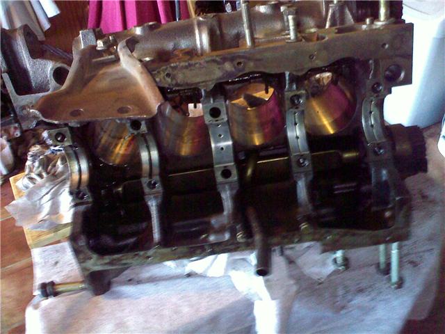

got all the pistons cleaned up now and started on cleaning the block up. does anyone know best place for piston rings?

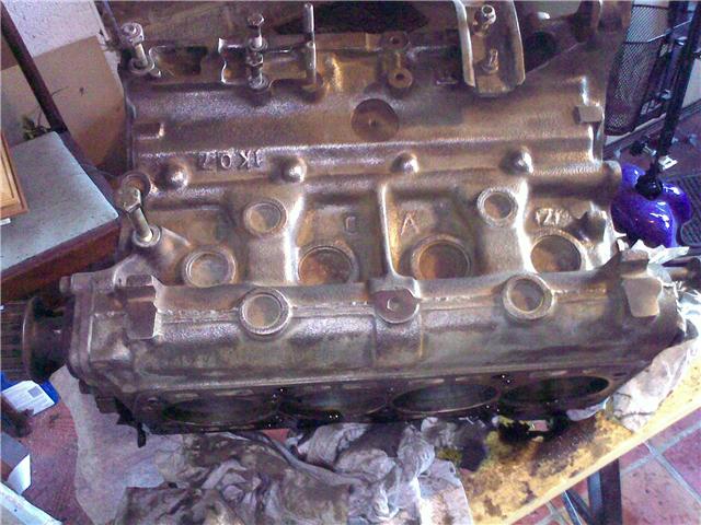

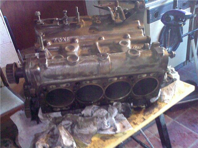

where that water had got in to the pistons it has left the piston sleeve rough, i've had a wire brush thing on a drill and had a go trying to move the rust but its not shifting, i've thought about using enry cloth but that might course problems with compression if i take to much off:( its only the 2 middle ones that are like this, any ideas? and please dont say new sleeves:cry:
The pictures don't come through, but i think a bit of scotchbrite should do the trick, oil it up and scot lightly, no way you can brush of the wall. All what is left will be ground away in minutes after first start.
Because they're hosted from your email they will only show up to you when you're logged into your email - we never will see them images... until you hosted them here! You 'dinged' all 4 pistons with both valves?
yeah all 4 are dinted but i never did it, bought car as none runner and just ripped that engine staight out without trying to start it. i bet the guy who owned it before me tried bumping it. valves look ok but not going to risk it just going to change them. im just hoping its going to run when i put it all back together.
