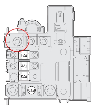

2004 JTD. I'm getting recurrent flat batteries, and after endless testing I've isolated it to a 3amp drain via this connector on the battery's positive terminal. Drain is persistent, even with the engine off and keys out.
It's a thick cable, so I'm guessing starter and/or alternator? Can anyone please confirm, and maybe suggest how I can continue testing downstream to identify the faulty component.
