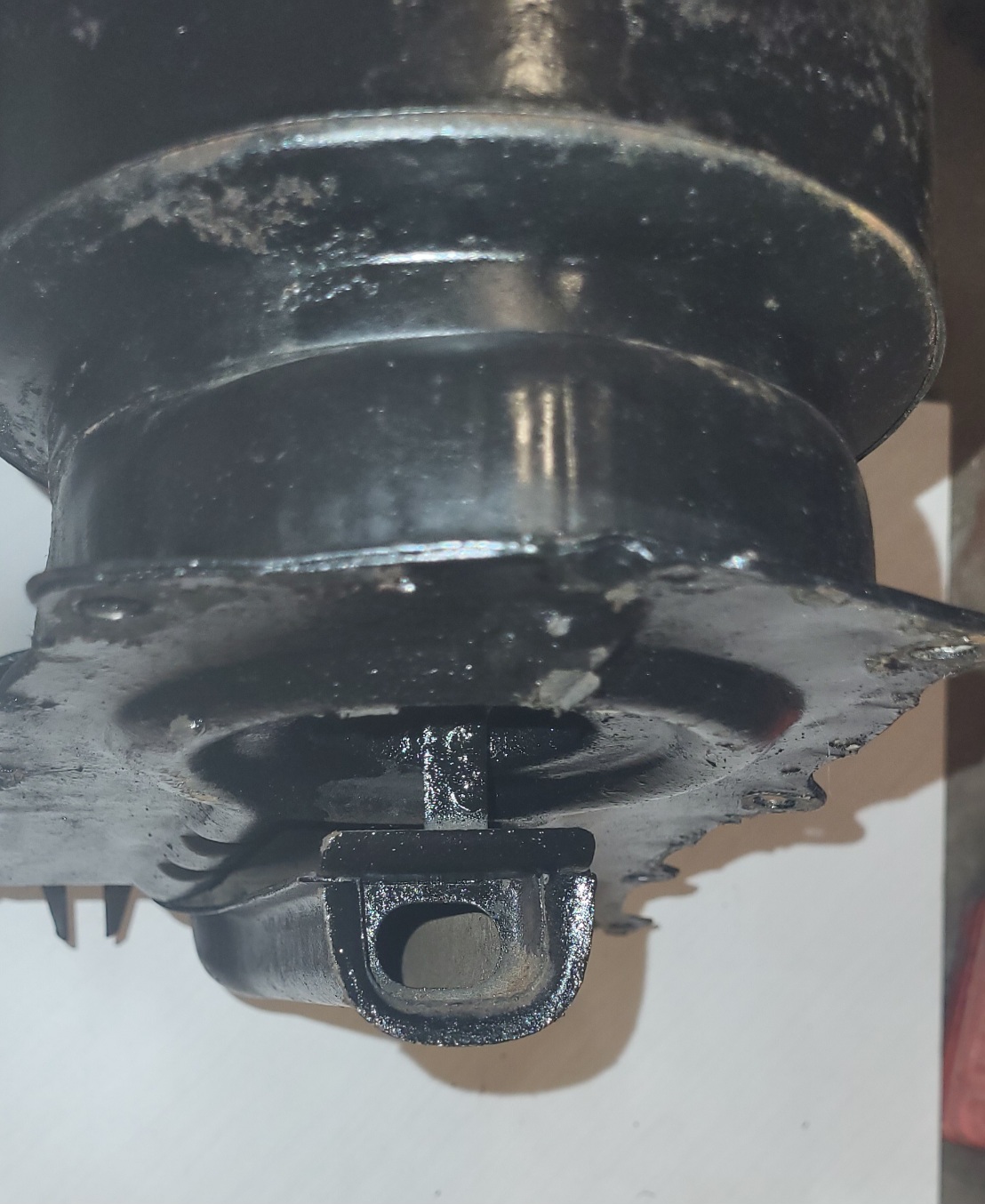

The air filter housing has a very long induction pipe with a tiny inlet port. There are lots of small holes here and there, then a long hose to the carburettor. What is all this for? Normally, elaborate induction systems are either to reduce noise or to pulse tune the inlet for better breathing in a particular RPM band. The 500 isn't quiet, nor does it seem to breathe well. What is the reason for such a convoluted air intake?
The inlet is only about 10mm x 20mm. That has got to be a restriction.

Hmm, i wasnt aware that the channel between the cooling fan and the intake tract was so restrictive. The positive pressure from the fan might compensate, but going from a 615 mm^2 carb (28mm diameter circle, 452mm^2 for a 24) to a 200mm^2 opening is still going to choke things off. Not to mention the turbulence caused by the weird plate opening at the front of that channel.
Ive considered fitting one of those intake trumpets on the carb, but the lesser filtration and it sucking in hot air from the engine bay held me back.
Might put my newly acquired die-grinder to use and open up that hole a bit more, at least get it to the point where the channel itself is the restriction, not the front plate.
If you are referring to the oval hole at bottom of photo it looks like a steel plate pressed into the base and crimped over so it may be possible to ease the crimps and remove the oval plate, then if it gives a negative result it may be replaced.
It's worth considering that removing any restrictions in the intake, or especially switching to an open filter / intake trumpet, is likely to upset the jetting in the carb. The carb will have been set-up to work with the restricted air flow offered by the intake and could well run lean without it. So to see any improvement you'll likely need to get the carb setup to match your new intake.
