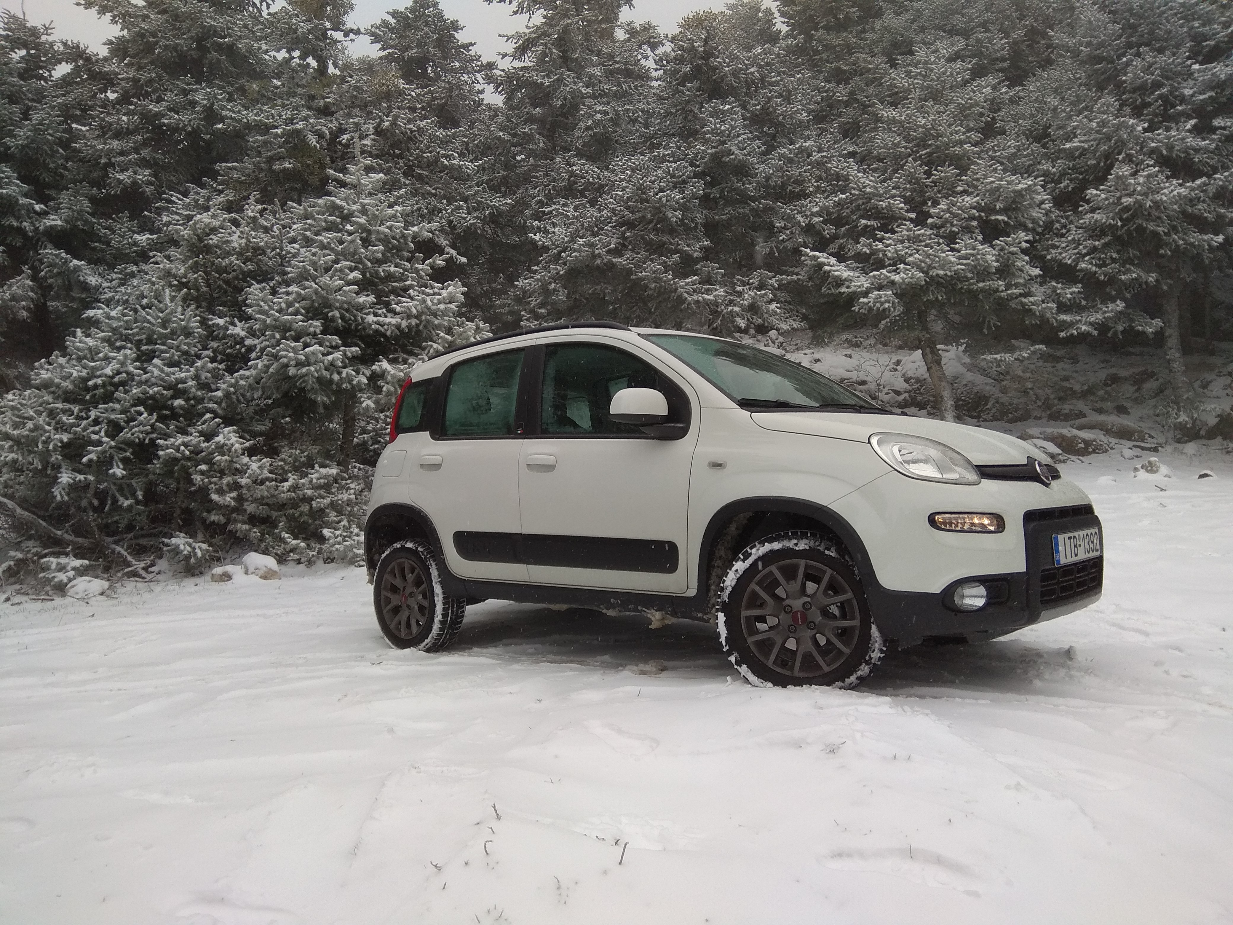

Merry Christmas everyone!!! Since i bought my PANDA on June, i 've been very lazy in forum. So this is my first winter upload ;-)

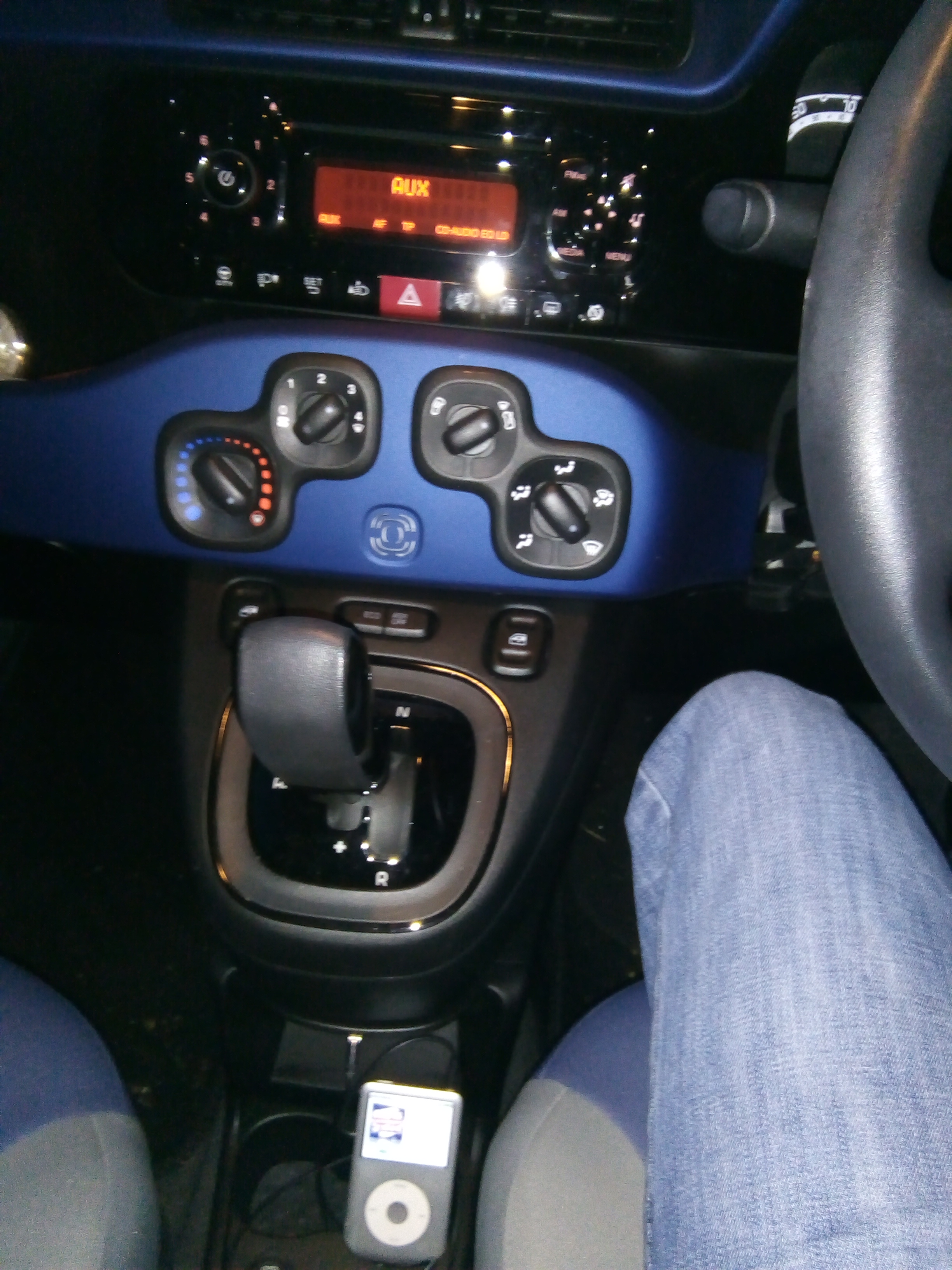

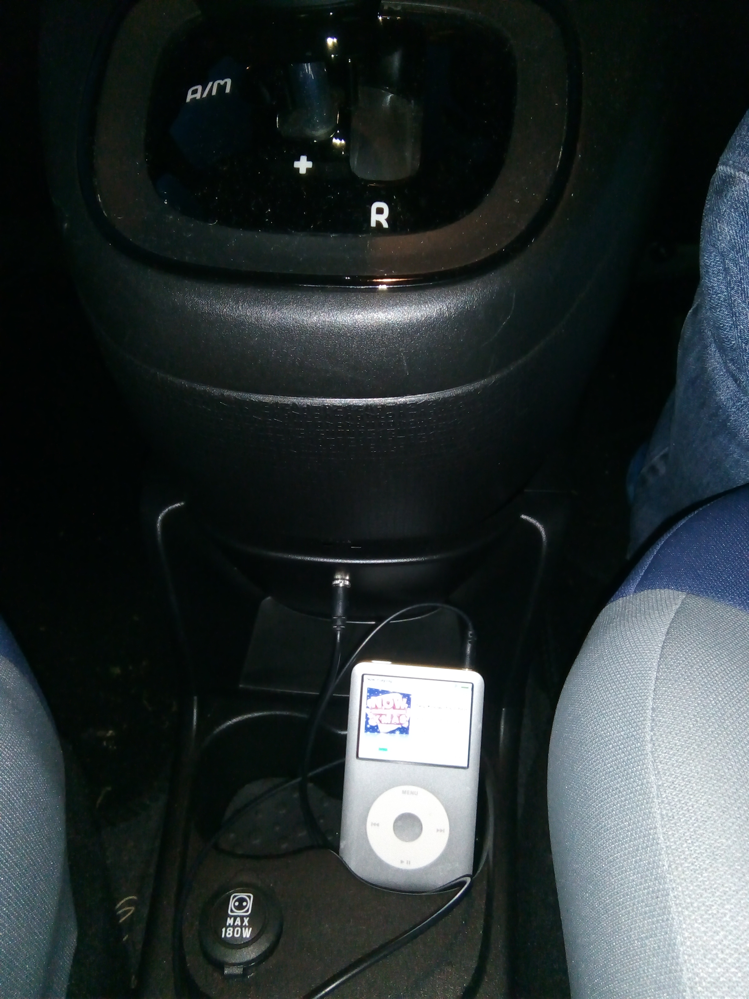

Fitted an Aux in kit to the standard Radio, no blue and me in my car. I can now press the Media button and use the AUX setting with my phone/ipod. I just plugged the new aux in cable to the rear of the head unit, fished the cable down behind the centre console, drilled a 6mm hole below the gear lever and popped a female 3.5mm connector in. Easy as that. :D

Nice clean mod :)
