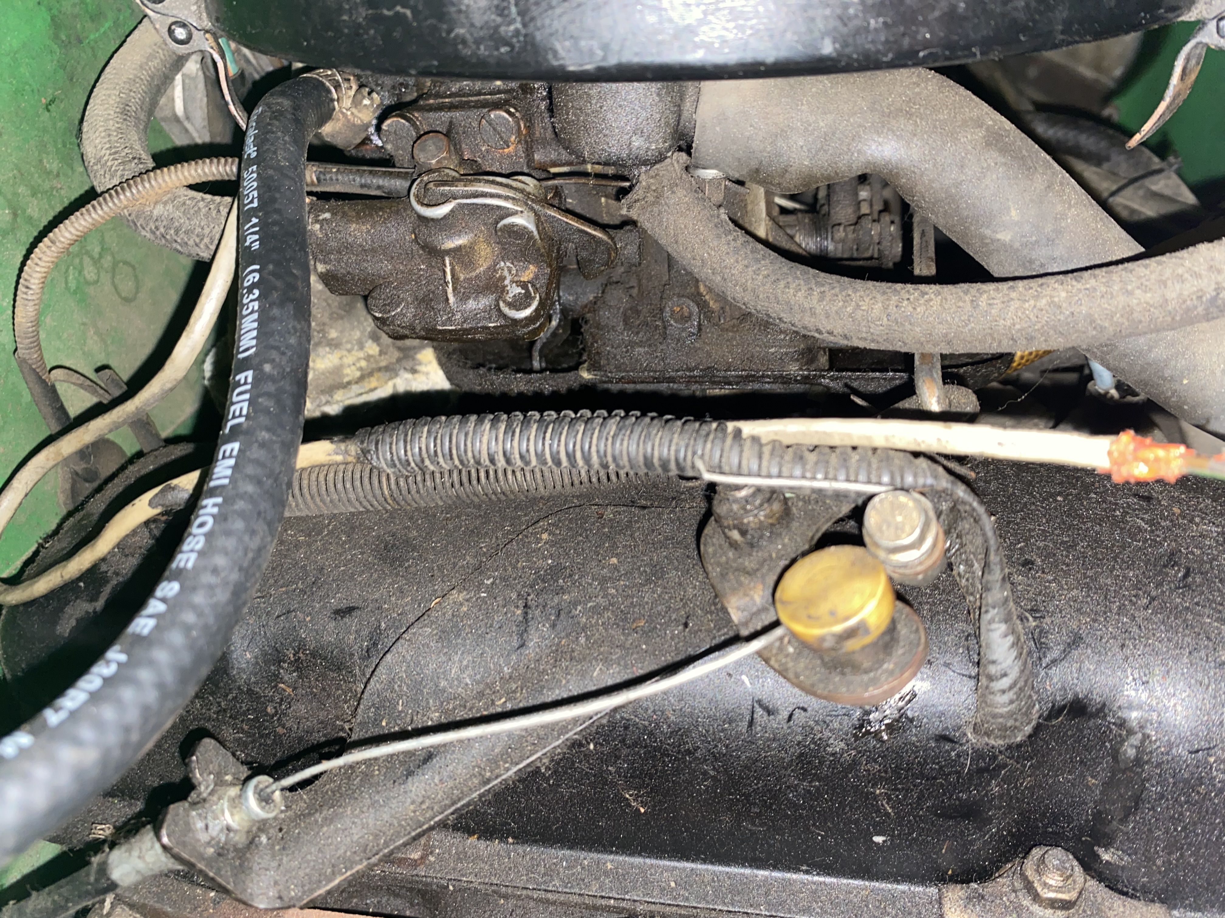

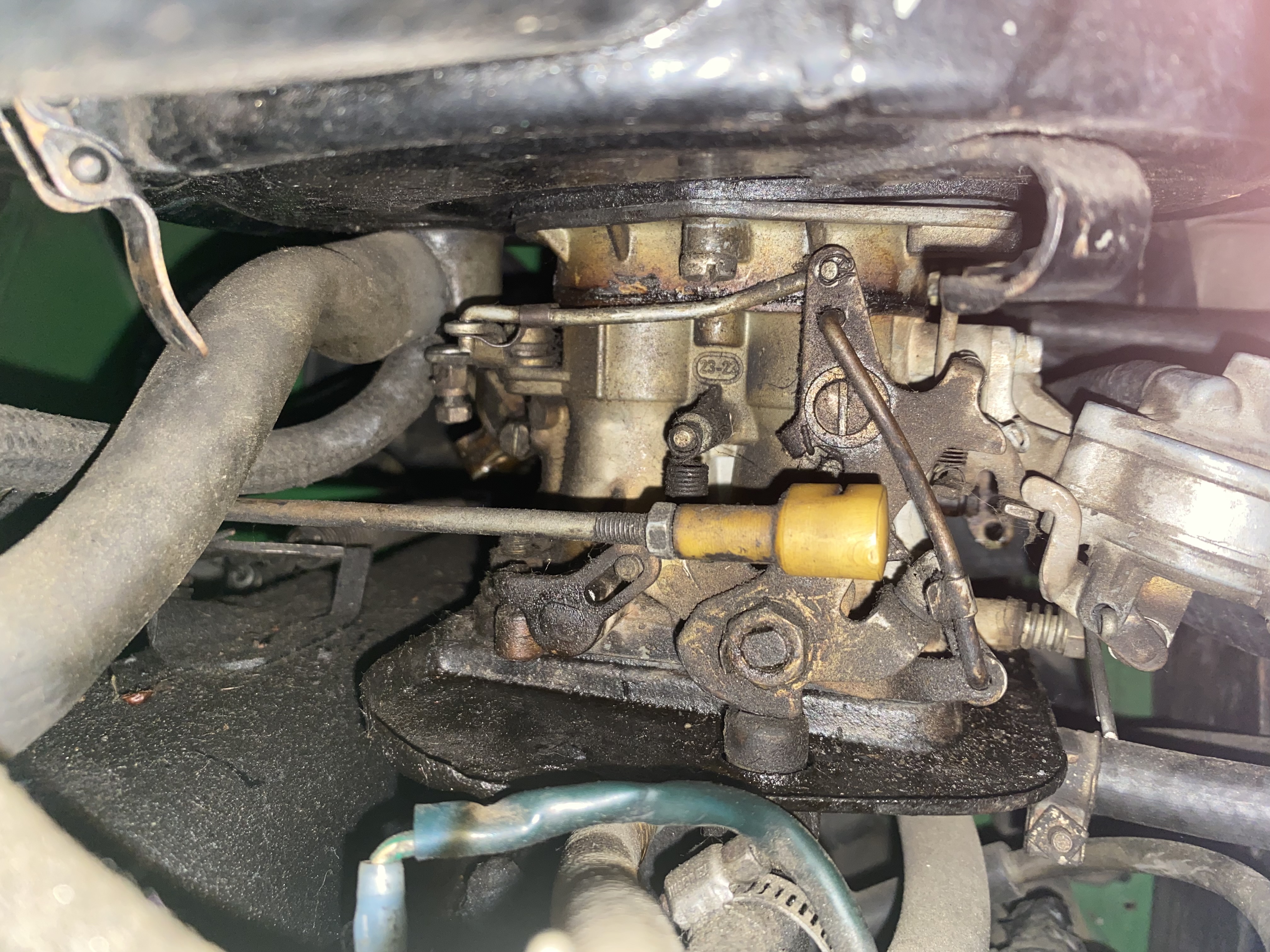

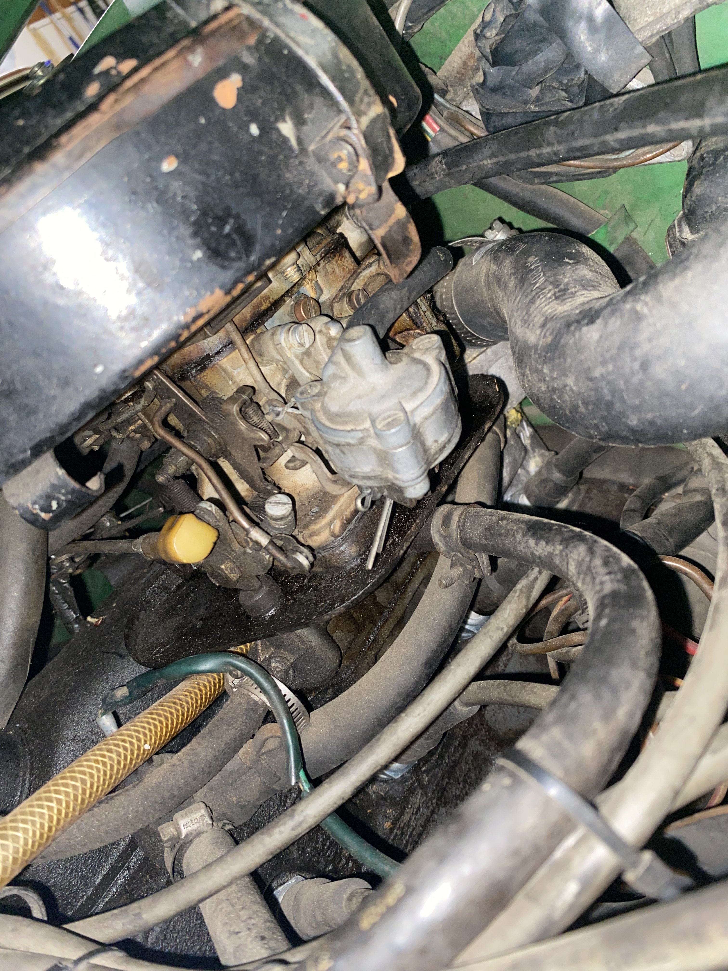

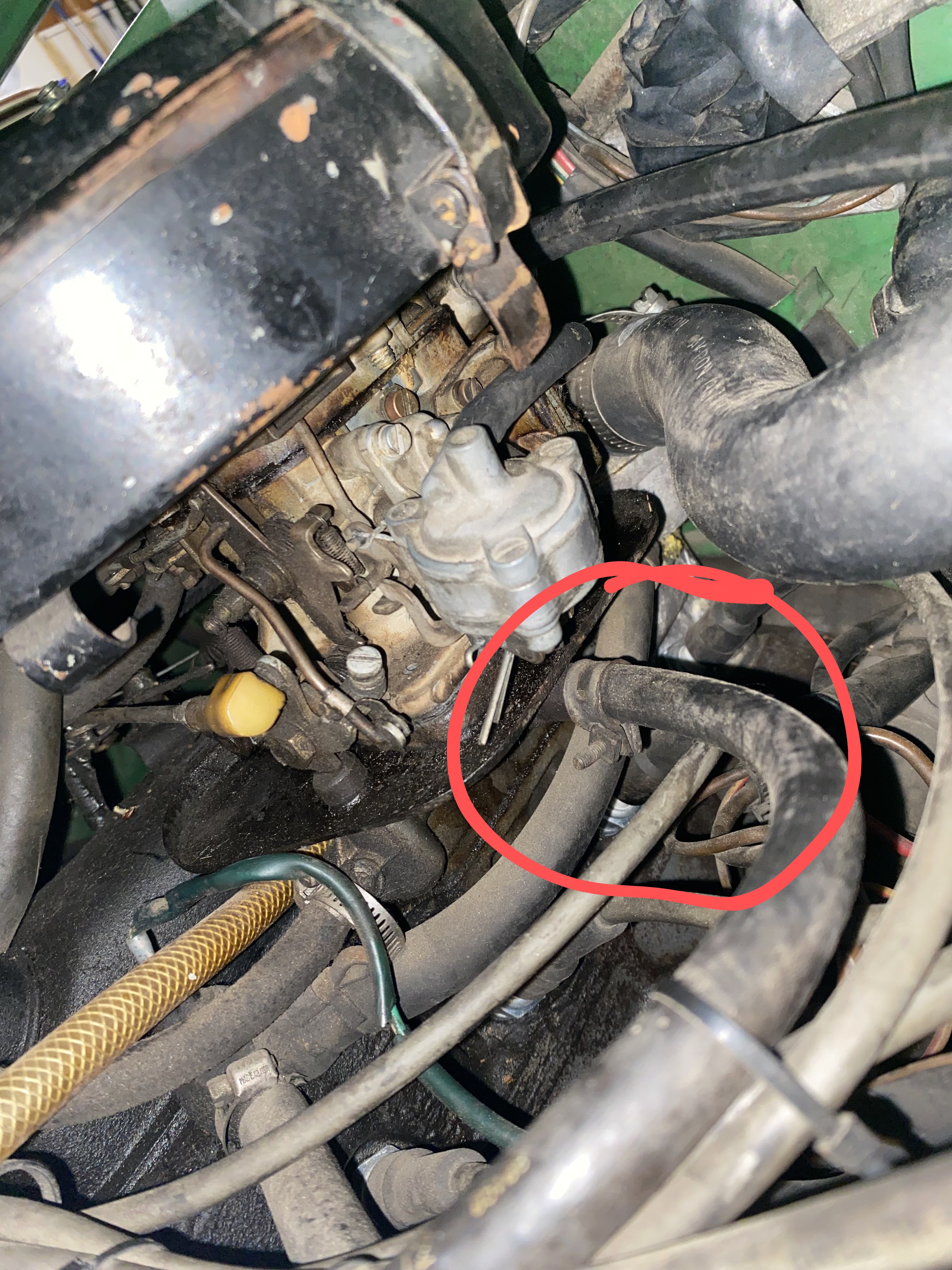

Specifically in the bottom picture there seems to be an additional unit with a hose coming off of that I haven't seen in other weber 30 DICA's. I'm looking for a carb rebuild kit and would like to know for certain which carb I have before ordering. Thanks for any help!
It's a 30dic11 from a 903cc sport spider and correct for your car as it has some smog control stuff on it. It has choke of size 23/23 but most repair kits cover all the 30dic models, check your primary shaft play as you've got 80k miles if the pivot is worn it may create a variable idle if you have a worn shaft.
