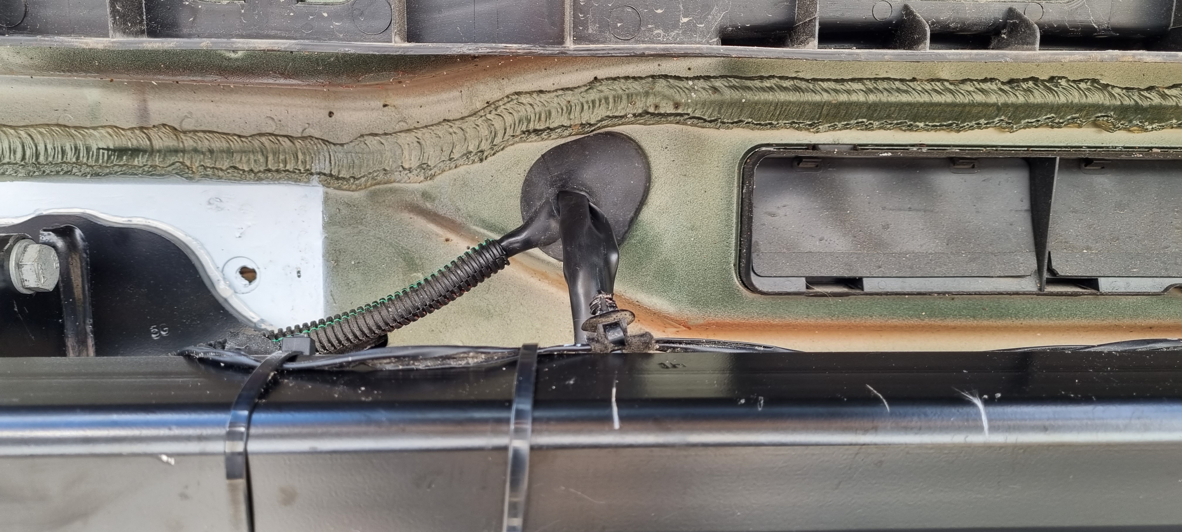

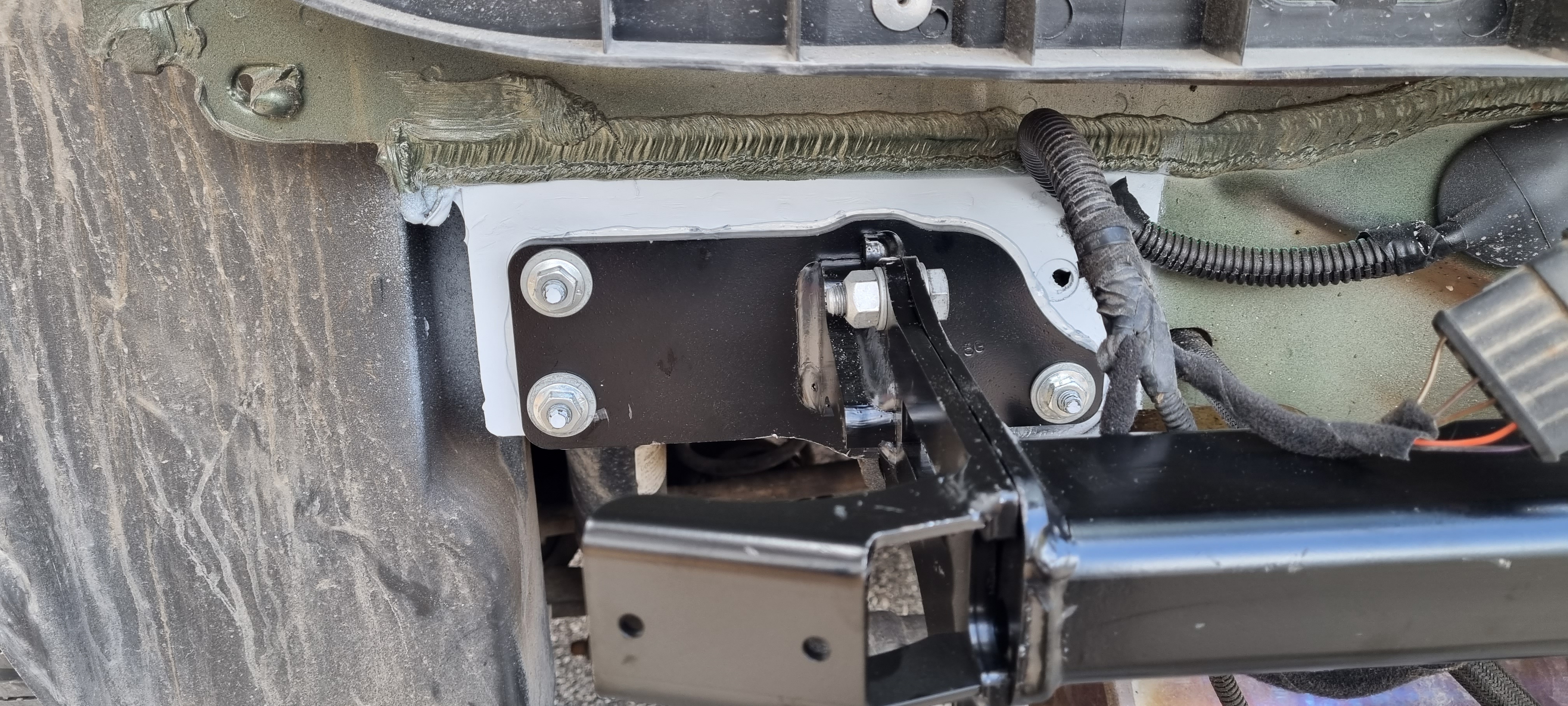

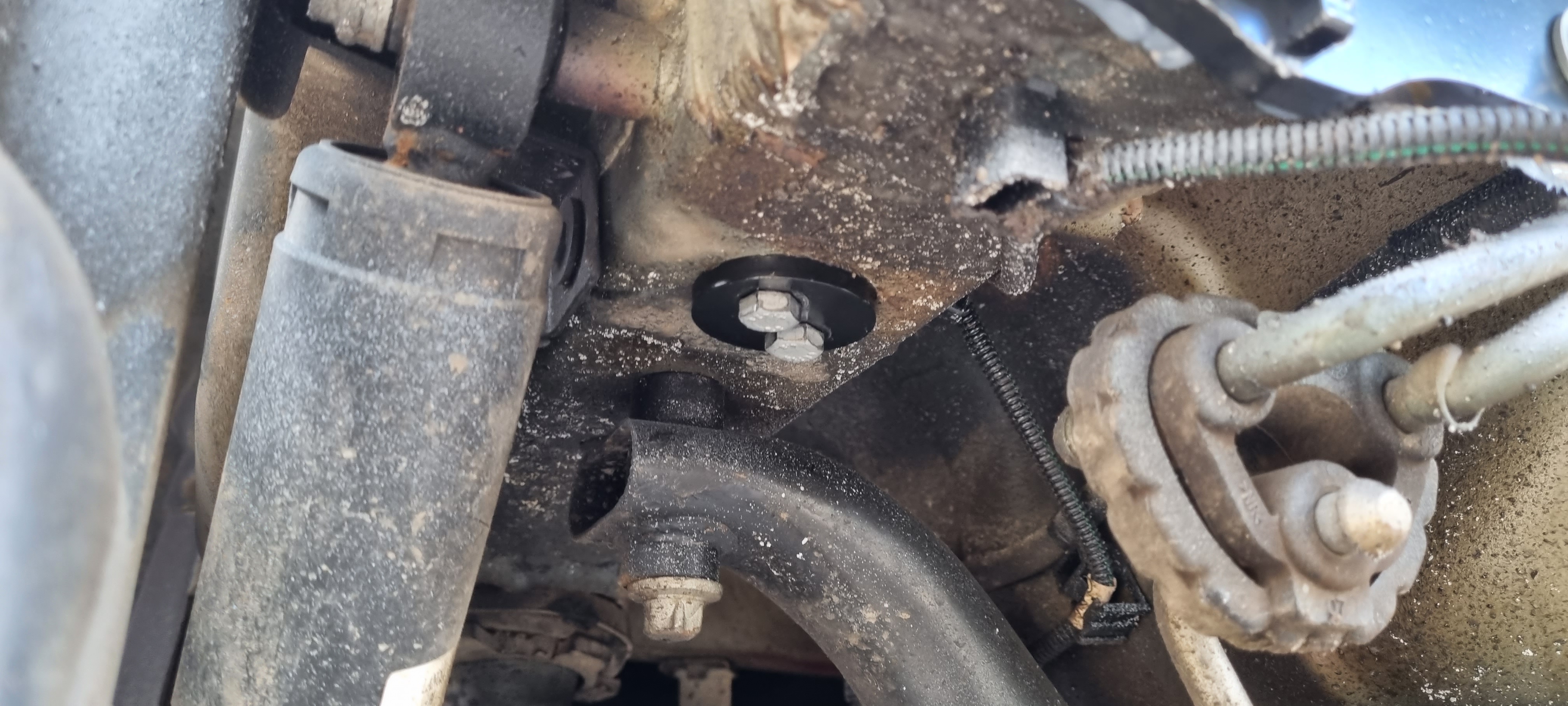

Hi guys,
I just finished the install of a Wesfalia Tow bar. It was pretty straight forward, this is my 3rd tow bar ive installed ( first with the universal loom, my others had OEM looms and dongle for coding) , I made sure any bare metal was sprayed with rust inhibiter primer, and also used silicon , just like OEM.
I purchased the Wesfalia kit with the 13 pin universal loom. As the only one that came with an oem plug in loom was for a 7 pin. ( i need a 13 pin, i use my trailer for work.)

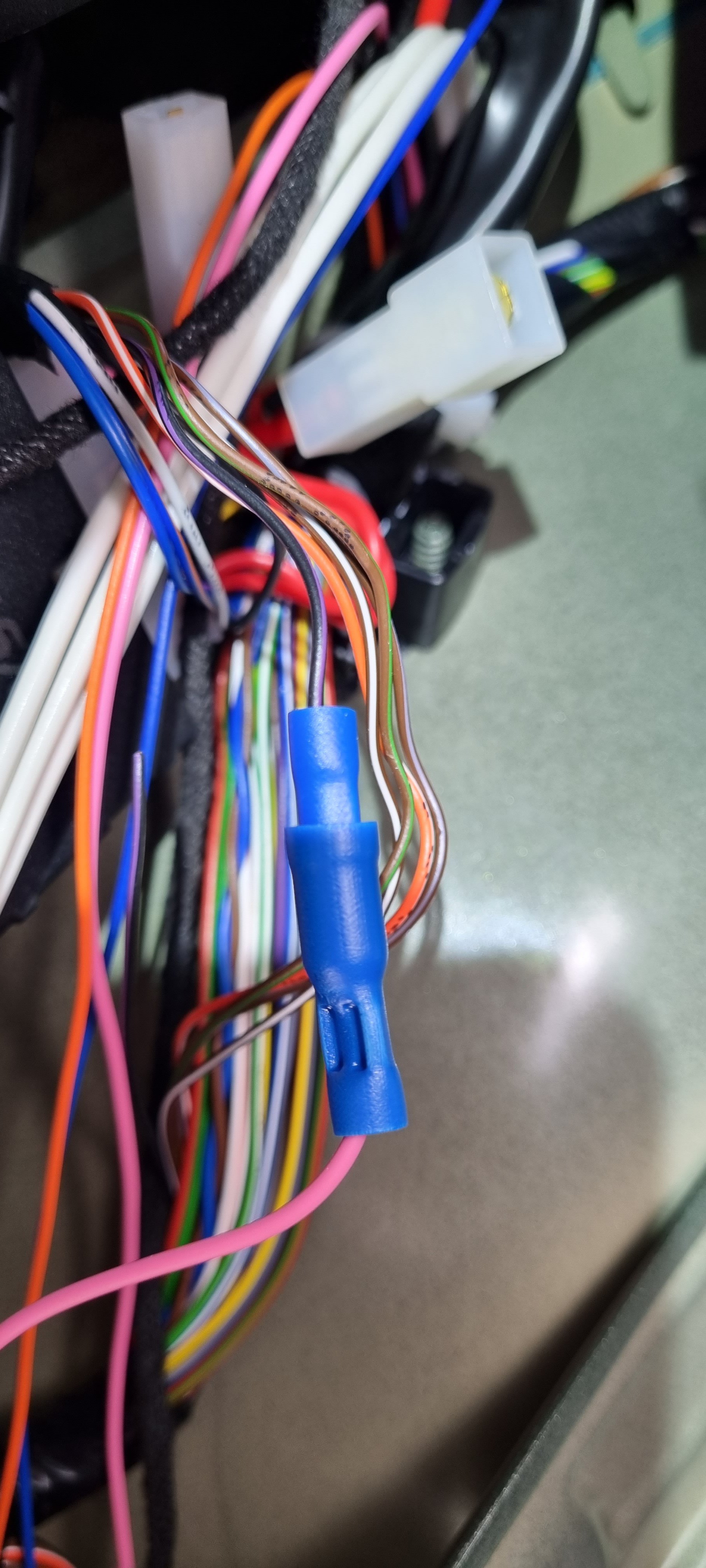

Anyway i am wiring the loom and i am up to the last pink wire coming from the control unit. It says i need to find my OEM PDC, ( i found it its a Bosch unit , hidden in the rear left pillar.
The instructions say to cut the earth to the OEM BOSCH PDC and connect it to the Tow bar module so the reverse sensors dont go off while i am hooked up.
Has anyone done this before. ? Any help will be greatly appreciated.
I will try and disconnect the EARTH tomorrow and see if it works.
I have attached some photos.
Cutting the earth on the PDC does make sense, the module im guessing disconnects the circuit once the trailer loom is plugged in. Im just not sure if the black wire coming out of the OEM BOSCH PDC is the earth cable. if no one has done this before im going to have to try tommorow.

I found the Earth wire for the Factory Bosch PDC, and cut it. I then connected to the pink wire of the module following the instructions.. It unfortunately does not work. So when i reverse the sensors pick up the trailer and beep constantly. ( of course Fiat doesn't add a button to turn off the PDC..:mad: like every other manufacturer. its the little things.. anyway i put it all back together, i will contact westfalia, see if they can help.

So you got the PDC to deactivate using the pink wire? In one of my photos you can see i connected the wire to the earth wire of the Bosch factory PDC, it didnt work for me.
I would have thought the Westfalia controller is a N,C relay and when i hitch up the trailer it opens the circuit, turning off the Bosch PDC.

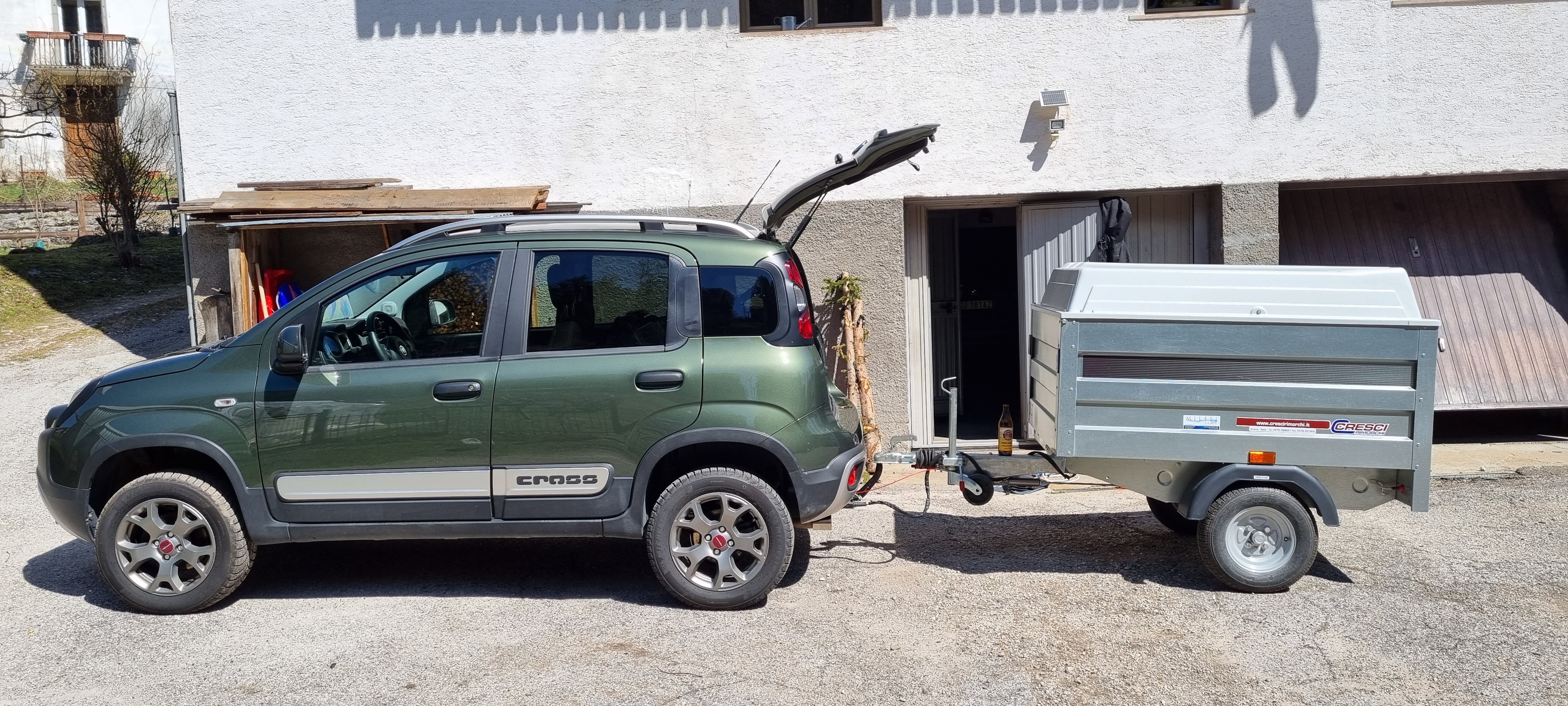

Nice to see that you can get a small size trailer with brakes. Here in the UK, because you are legally allowed to tow up to 750kg trailer+load (when the car is capable), there are very few (if any?) small braked trailers around. As the 4x4 Panda is limited to just 400kg with an unbraked trailer, that's quite limiting. Sadly, the Cresci Rimorchi trailers are not available here... (Edit: I did find this company - https://davidmurphytowing.com)
This is my 2nd Cresci trailer. This is there :animali transporto" version. There are a few unbraked versions but their not my cup of tea. My cresci can only hold 450kg maximum.
Great company, an quality trailers.
Ok good news, i got a reply from westfalia, They sent me the instructions for the westfalia wiring kit for the Panda. They said i purchased a westfalia tow bar kit but the seller (ebay) sold me a Aftermarket wiring kit (so not an official westfalia wiring kit) he said they have had people contact them with the same issue. Attached is the document he sent me , with instructions to follow page 21, picture 17./ And to connect my PINK wire from the aftermarket controller to the pin on the OEM Bosch PDC ( the one already in my panda)/
I will try it today and hopefully the problem, will be solved.

The EBAY seller replied to me admitting he deceived customers, ( and yes the wiring loom is aftermarket not WESTFALIA as stated) and apologised. He also said to me the wiring kit he supplied me does not disable PDC.. ( great!!).
