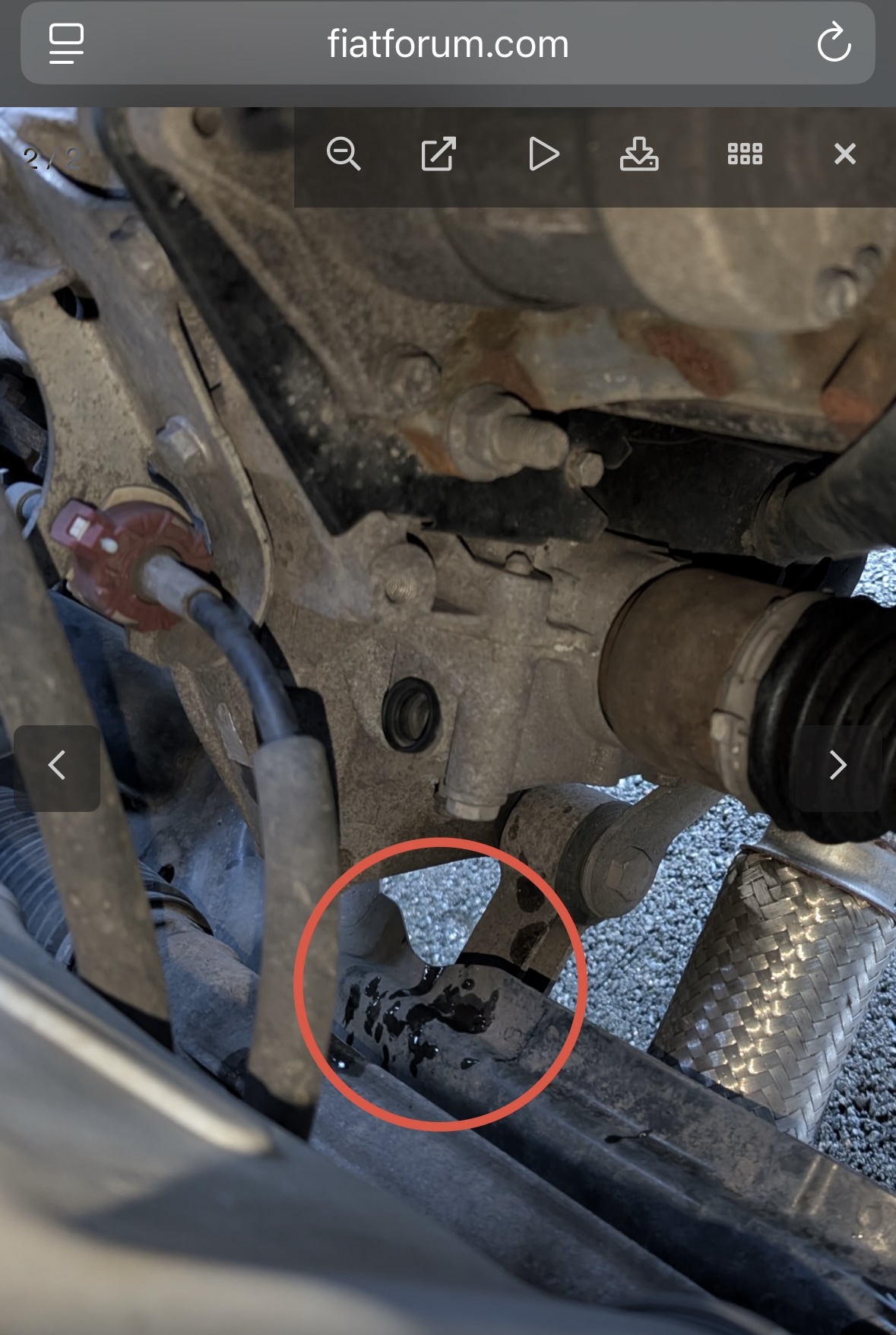

So if it's not engine oil, what else could it be from? Gearbox, clutch? Or even coolant, or could it just be water from the scuttle bays?
Can’t be gearbox - that’s over to the right. Doesn’t look like water. I just asked as it looks odd. What’s the problem with the starter? You do seem to be blessed with bad luck and a constant stream of things breaking - which is a very non-normal situation :)
I know. This is the pictures I took today, basically every morning from the last week and every turn on of the engine, there is a squeal noise. Been told it's the starter motor. The old one on the car is a Hitachi probably from new with the car. I will send a video.
Nothing there today...
