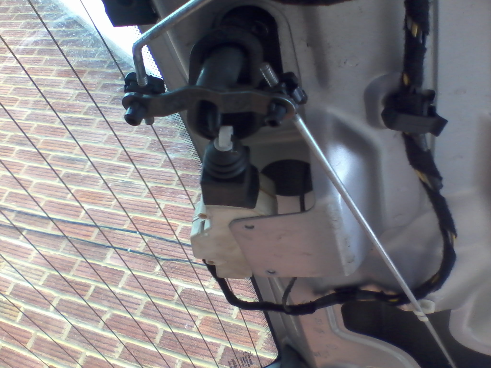

My Weekend tailgate lock does not lock on the central locking. The solenoid clunks over but seems to return back to where it started leaving the tailgate unlocked. I have to lock it with the key. It unlocks perfectly. I have checked the mechanical lock mechanism and it is working as it should.
When the solenoid extends it locks, but does anyone know if it is meant to stay extended? Mine returns to its starting position.:confused:
Mine does exactly the same thing. All I do is, when I close the tailgate I give it a push on the very left-hand side, a few inches above the bottom edge. It clicks - and then it locks fine on the central locking. This may not work for you but it's free and therefore worth a try :D
That'll probably be because it's not latched properly then - there are 2 latches (obviously) and it will only lock with the central locking if it is correctly latched on both. Try adjusting the latches by slackening off the bolts and moving it out slightly. You can also adjust the bumpstops a little to allow the lid to shut further if you think this is the issue.
If my tailgate isn't properly latched the entire central locking fails and the car will not lock until it is latched....
Had the same problem on my marea, i literally stripped the whole system out, cleaned it all up and replaced. Solenoid sounds like its gone tbh, you can probs get one cheap from a scrappy?
Thanks for the info guys, much appreciated. The lock is working as it should because I had it all stripped out when I cured the common Weekend tailgate catch sticking problem.
The problem seems to be with the solenoid, I think I will just order one from Fiat rather than change getting another dodgy one from fleabay or the scrappies.:)

I've had it all apart twice already.. but this is a new issue.. ( the lock doesn't want to turn..) but had locked and unlocked reliably via the CL, and still SOUNDS as if that's still working.:bang:
I'm wondering if the push-pull solenoid has worked loose, https://www.fiatforum.com/attachment.php?attachmentid=151688&d=1426978167
so goes clonk-clonk..but isn't driving the lever arm;
in one spot the lever is loose/free
then fells like it's "rubbing"
then drives normally and opens the latches..
Neverth..,
just read your reply..,
which parts did you slot,
the handle are..or the 2 x side lock-bolts??
I did the handle
And those two holes on the image (larger holes and filed the down, I think I made the plastic washer thinner on the other one)
