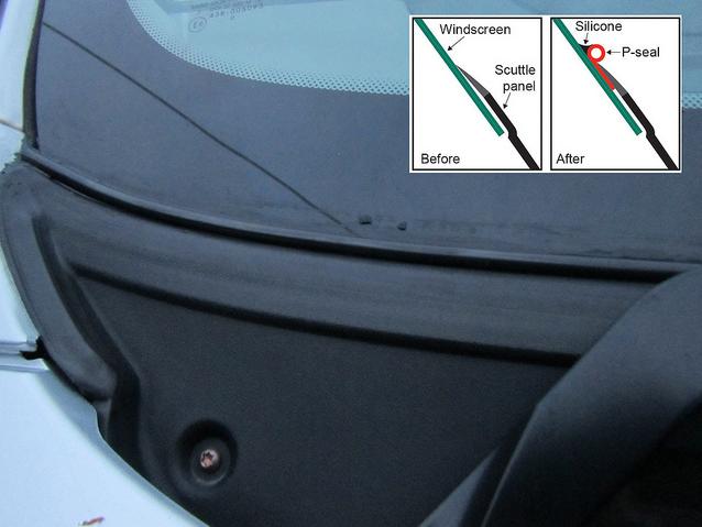

a lot of the problem is that water goes behind the scuttle rather than into it. I have successfully sorted three by fitting P trim between the screen and scuttle with a thin trace of sealant on the top. Make sure the clips that hold the scuttle to the bodywork are secure before you start. i have seen some where you can get your fingers up between the screen and scuttle. new clips should be used if the windscreen is replaced but sometimes are not.
Don't forget to seal the join in the middle of the scuttle:
