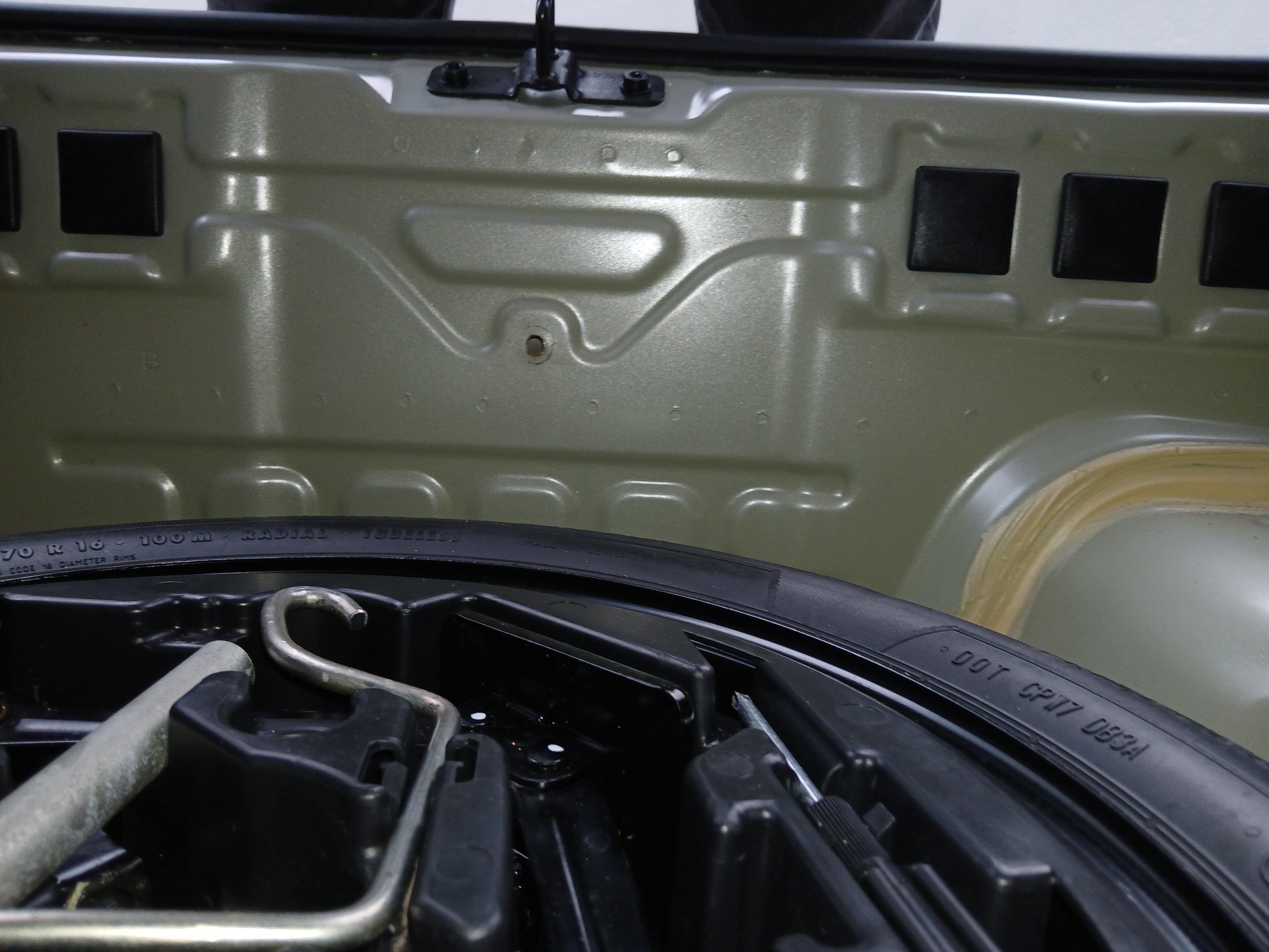

20251116_133548.jpgRemove this plastic trim. once removed you'll find six openings to a void between the vehicles skins, this is where the water pools, if you poor water into it you will see it drain out the bottom.

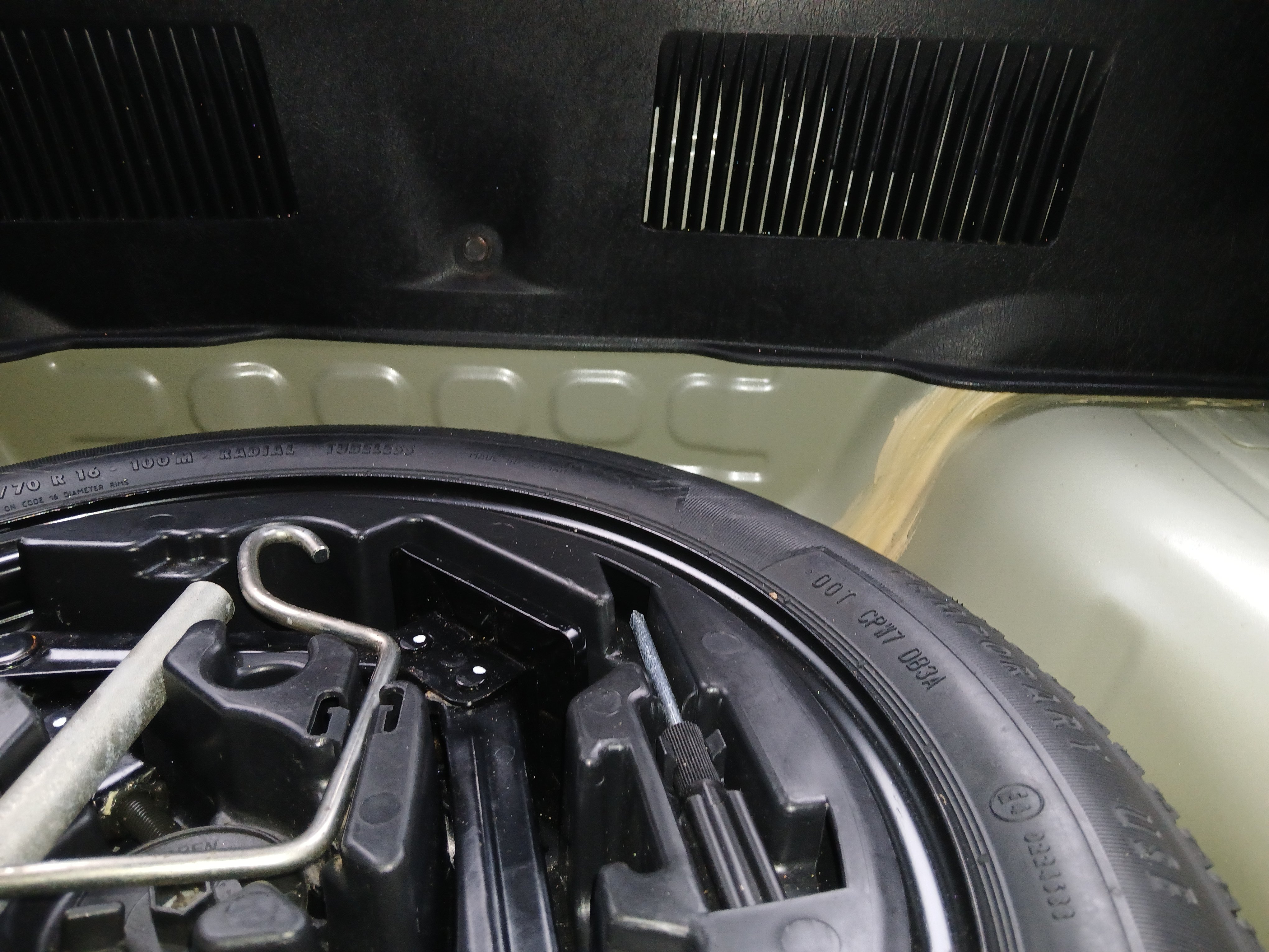

20251116_133523.jpgIn the picture you can see a small hole under the boot catch, this is the lowest point of the void space, because the plastic trim fixing is hollow is allows the water to enter the boot well. I tapped this hole to allow a bolt with a rubber and metal washer to hold the trim in place preventing the water from entering.

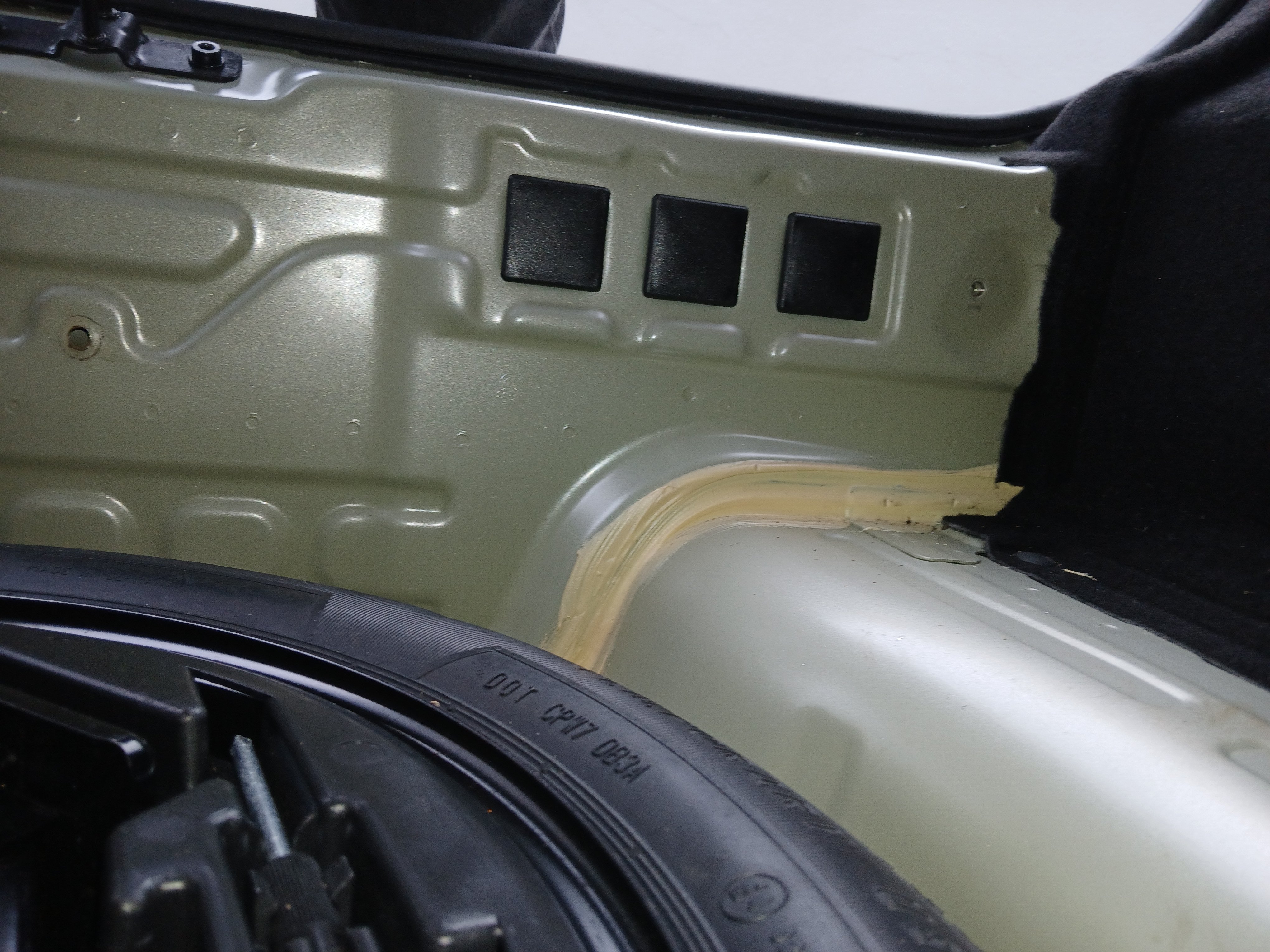

20251116_133529.jpgThe black caps you can see are metal bar end caps, 50mm x 50mm purchased from ebay, they just prevent any splash over.

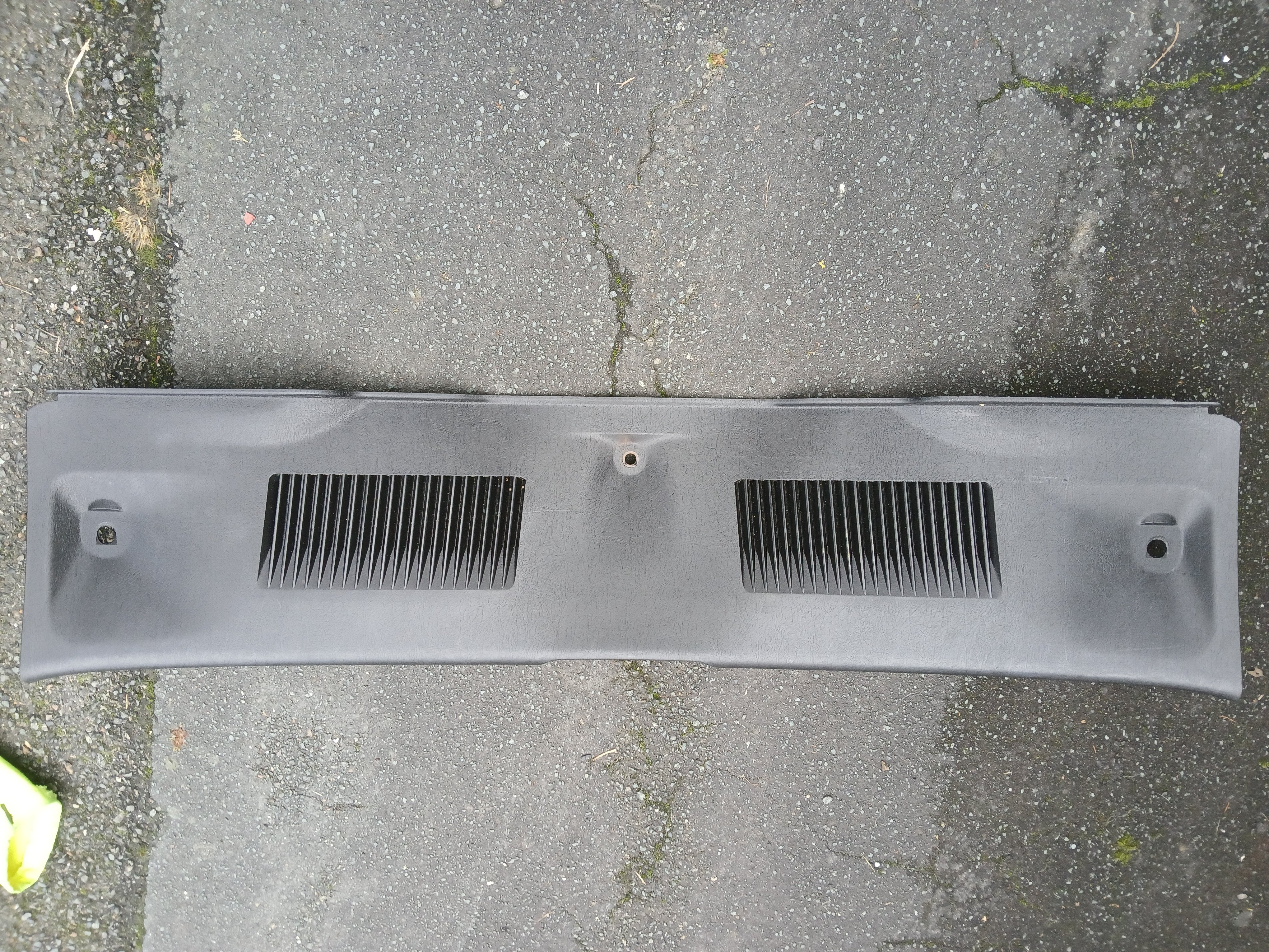

20251116_134240.jpgThis is the trim in place with the bolt.

View attachment 476552Remove this plastic trim. once removed you'll find six openings to a void between the vehicles skins, this is where the water pools, if you poor water into it you will see it drain out the bottom.
View attachment 476554In the picture you can see a small hole under the boot catch, this is the lowest point of the void space, because the plastic trim fixing is hollow is allows the water to enter the boot well. I tapped this hole to allow a bolt with a rubber and metal washer to hold the trim in place preventing the water from entering.
View attachment 476555The black caps you can see are metal bar end caps, 50mm x 50mm purchased from ebay, they just prevent any splash over.
View attachment 476556This is the trim in place with the bolt.
