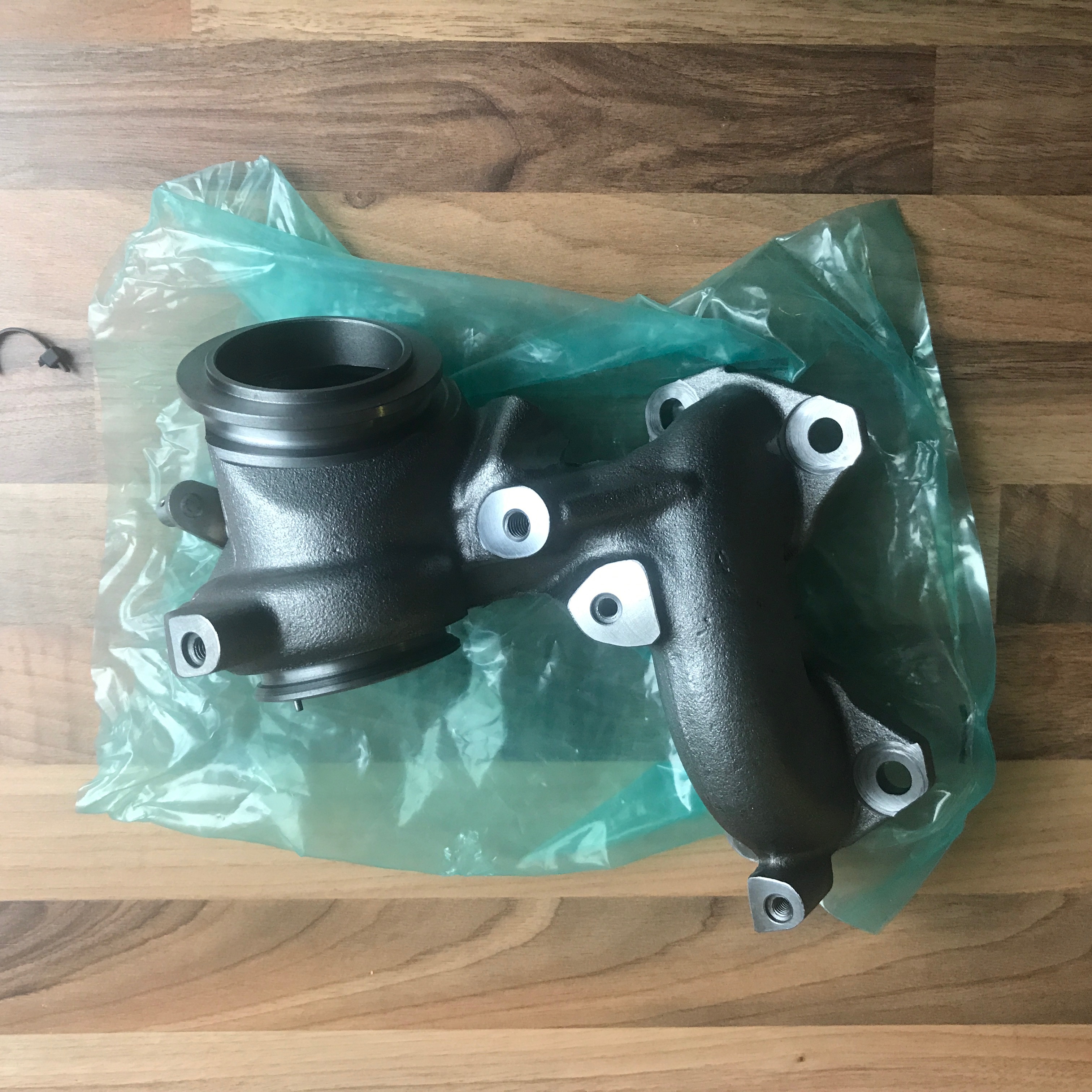

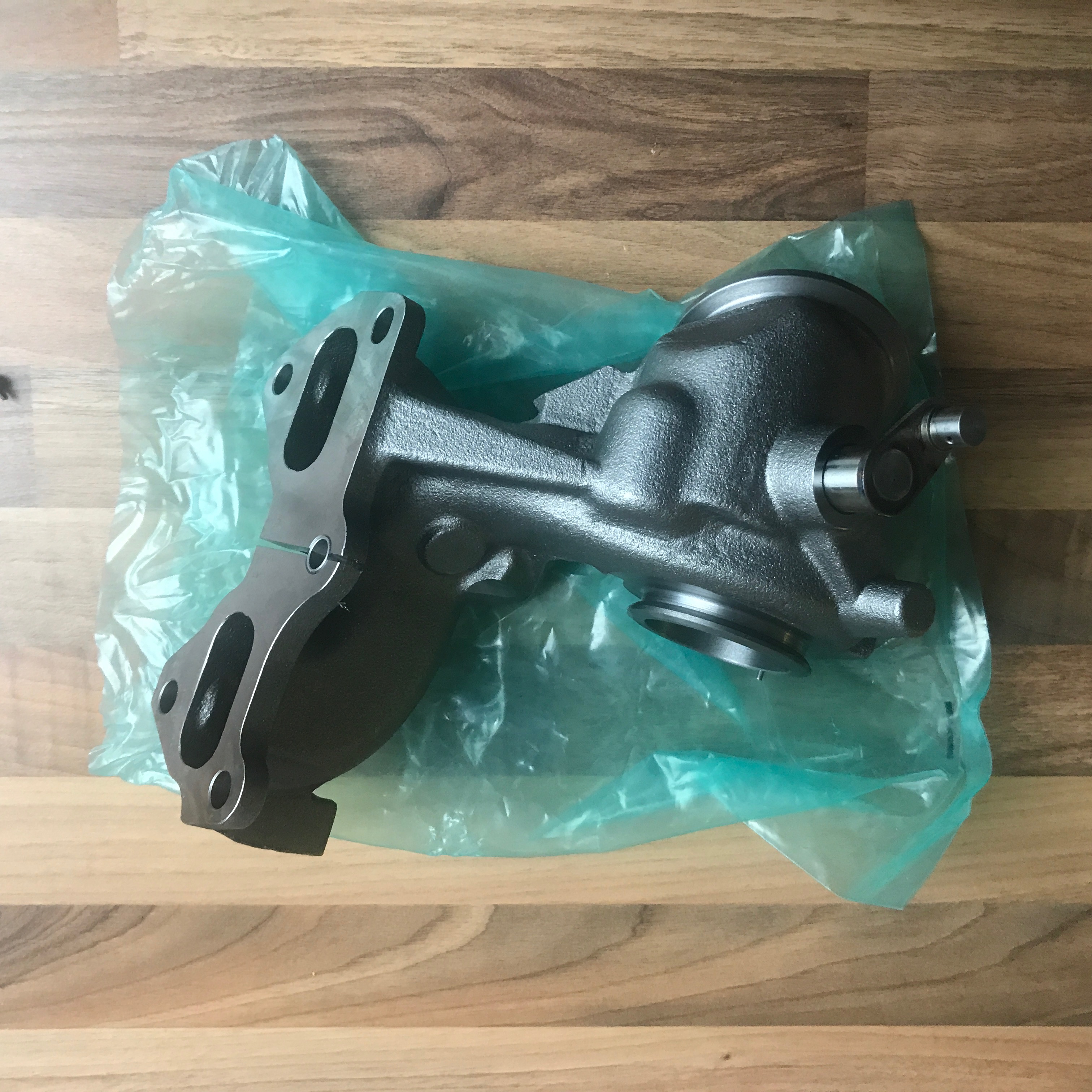

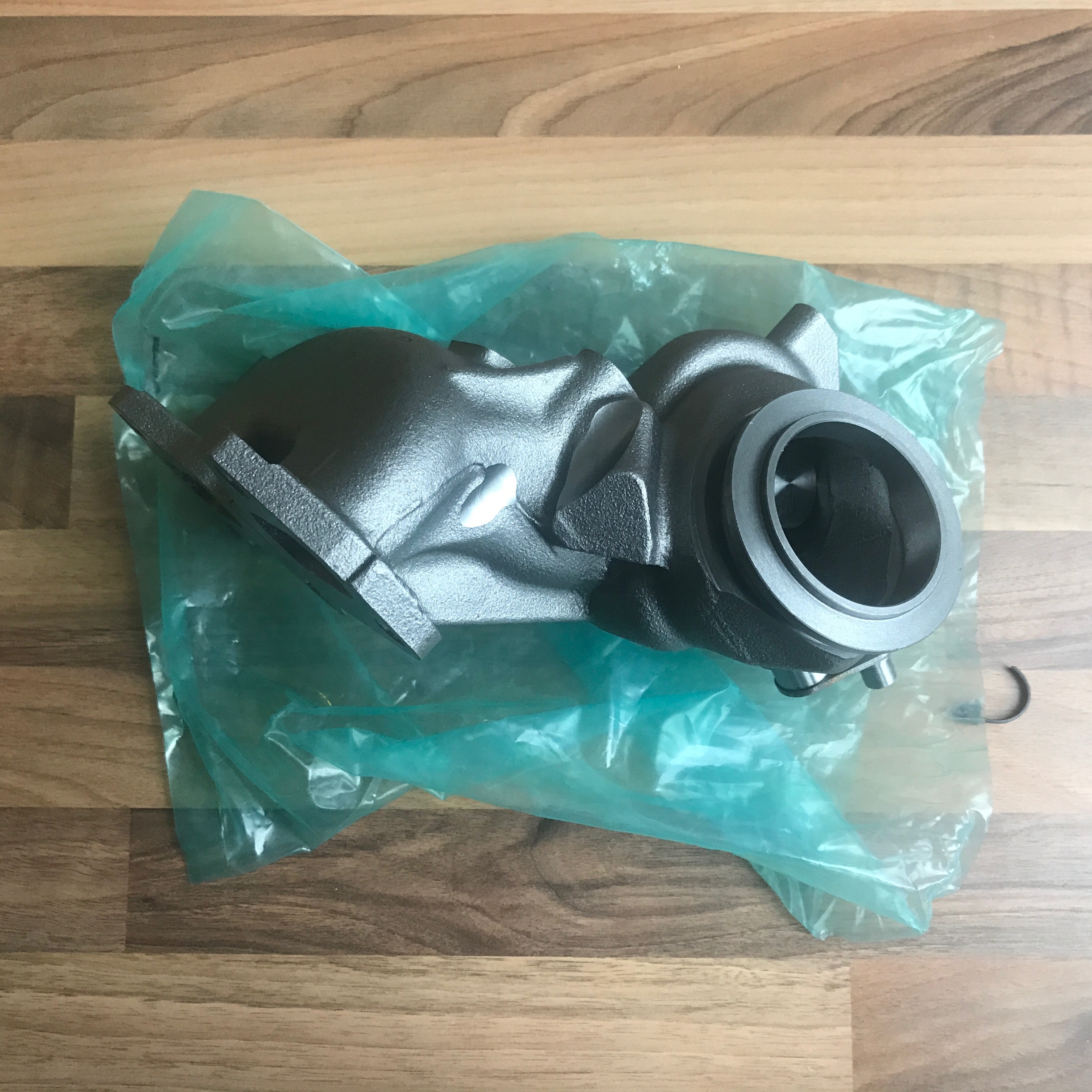

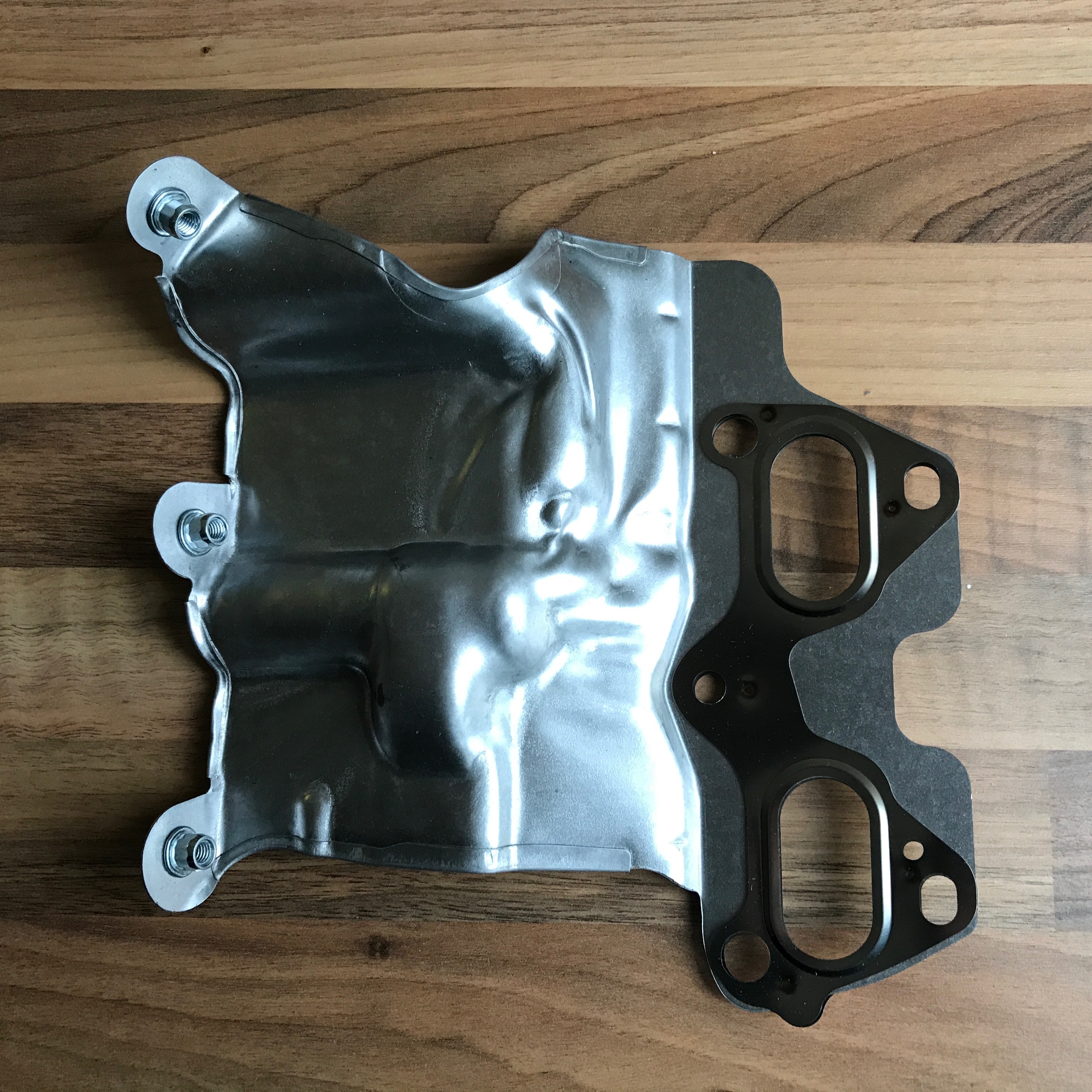

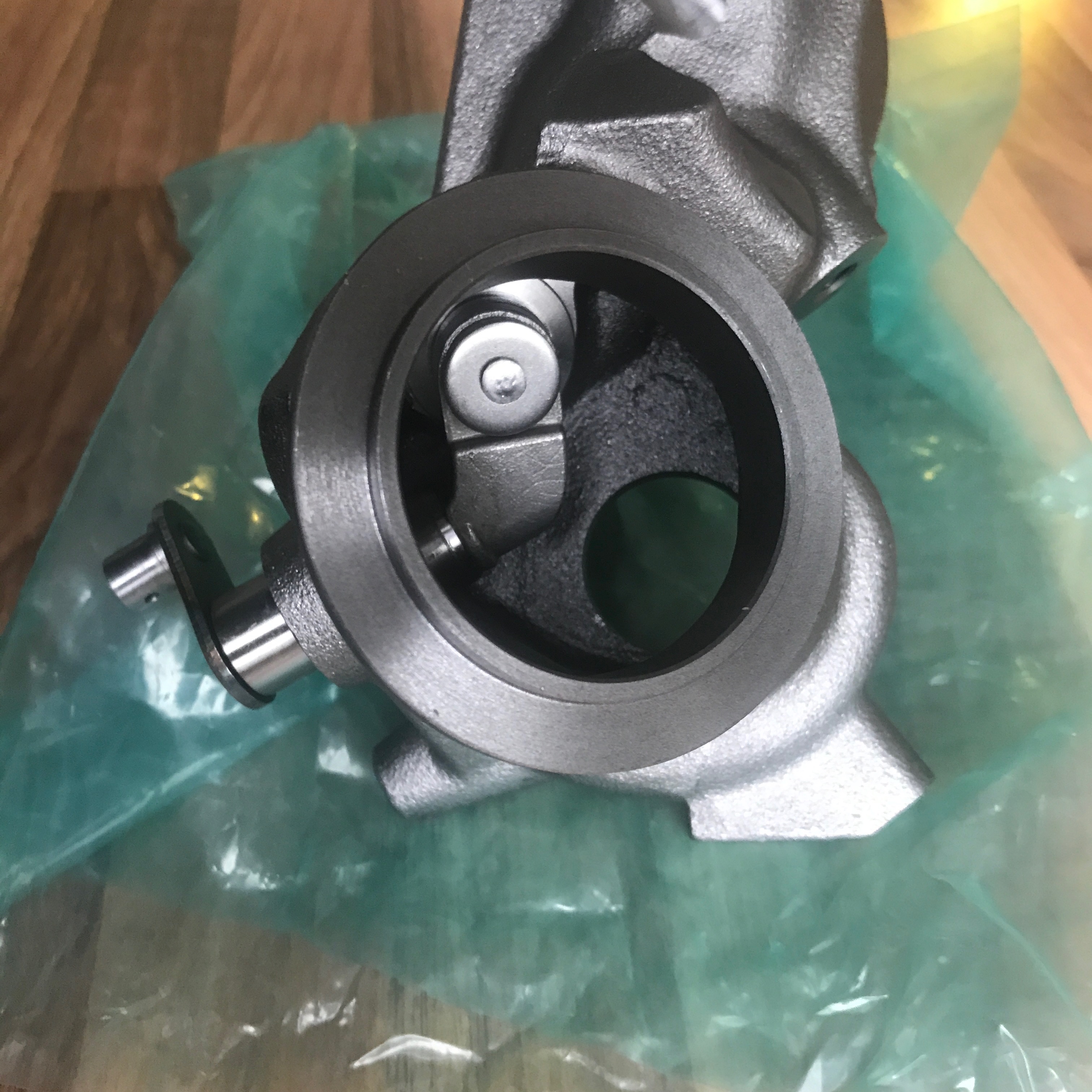

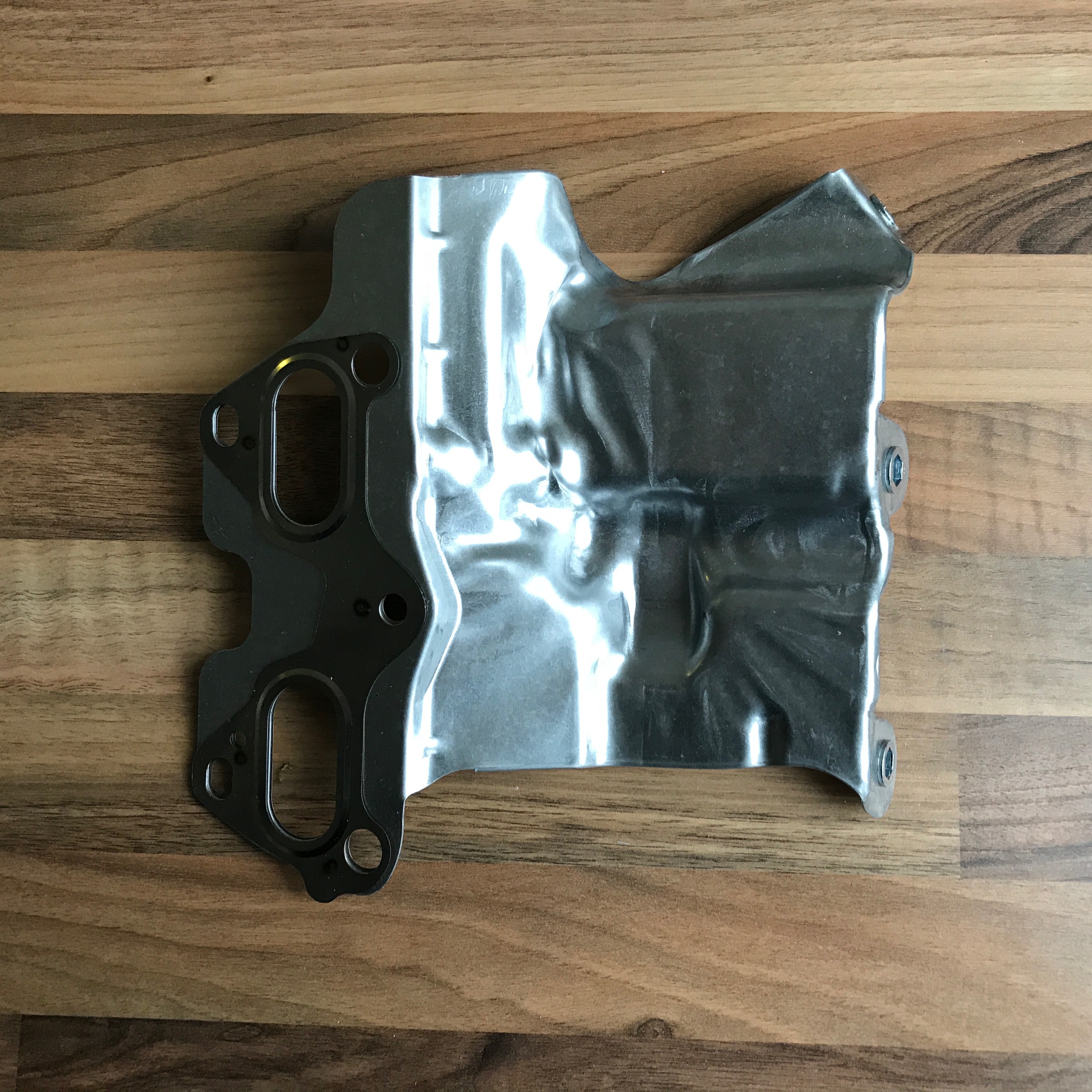

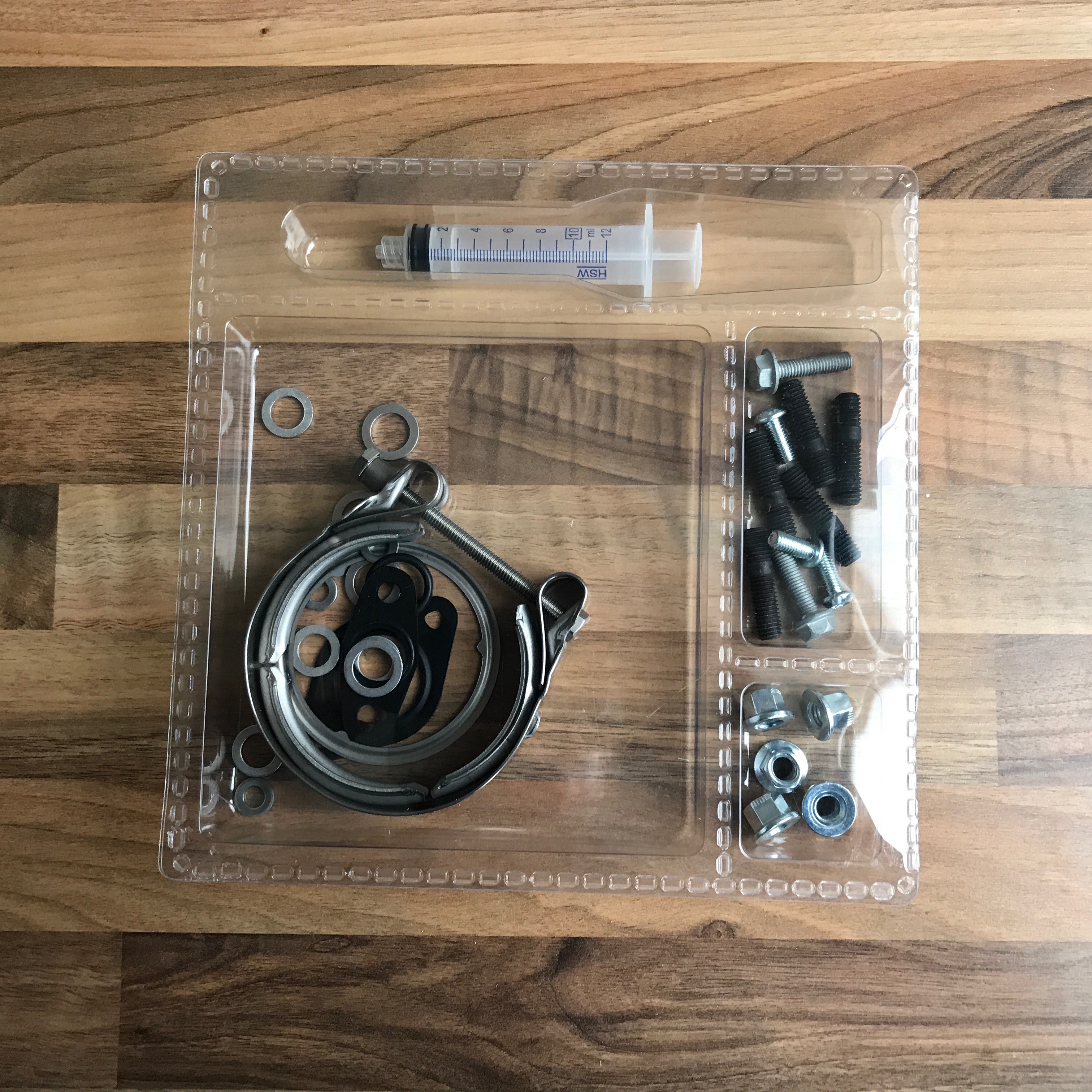

All the overhaul turbo Parts + fitting kit.
