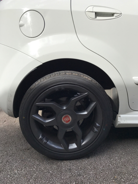

The one in your photo is not for a claw - the fiat badge is newer and red, the claws have a blue fiat badge.
Appreciate your advice but I have refurbed the wheels, caps and the badges are gel ones I fitted, thank you I will look in Shop4Parts

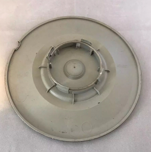

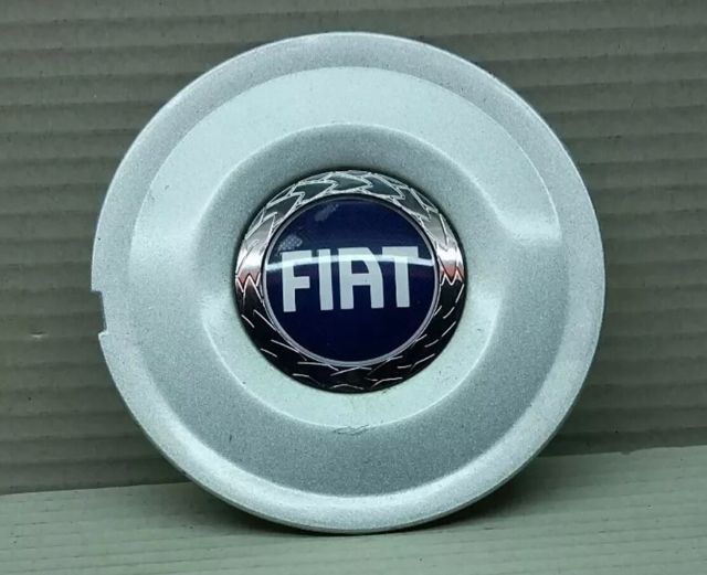

Wanted stilo claw centre cap please
If any one can help I would like one of these pleaseIMG_4797.JPGIMG_4796.JPG
Appreciate it won’t be the same colour etc, thank you

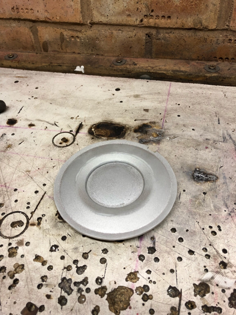

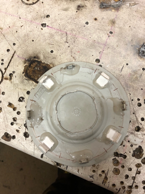

I failed miserably to find one so I adapted one similar, started with one 145mm and turned it down to 137mm, cut the removal slot. Cut the original clips from the centre rear and refitted where I need them(122mm). Made some more clips with upvc, heated it up and molded over some wire to get the clip shapes. Hot melt glued it all together. Painting next.IMG_0016.JPGIMG_0049.JPGIMG_0045.JPGIMG_0046.JPGIMG_0047.JPGIMG_0048.JPG
Now painted, just waiting on the decal for the centre, biggest concern now is I don’t lose anotherIMG_0065.JPGIMG_0067.JPG
