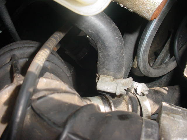

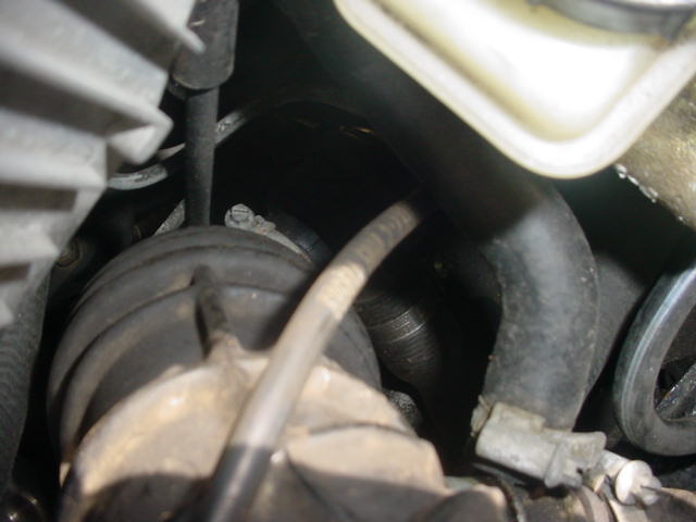

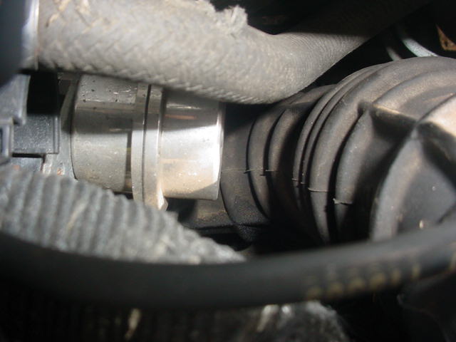

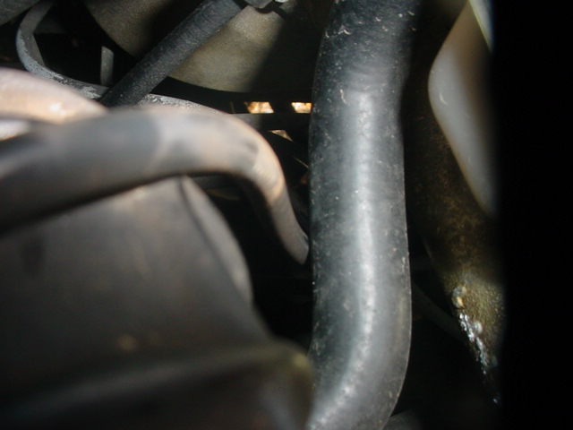

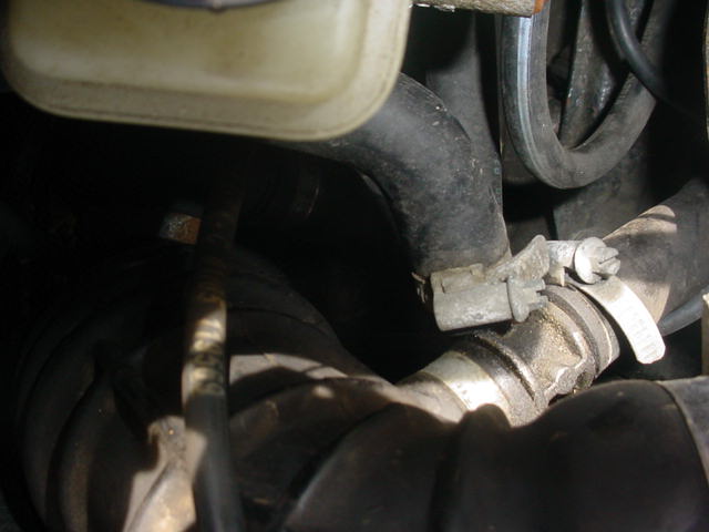

anything in these
any1 else got a picture of it

Looking at the pic of your engine bay it seems to me that your car has at some time in the past been fitted with an after market style dump valve, you have the T piece coming off the top boost hose which is where it would normally be but looks like its been blocked off and this is creating the wastegate "chatter" sound as its called. As steve said its not good for the turbo but i gotta say it does sound really cool. :cool: My mate took his DV off his fiesta Turbo and it sounds sssso sick!!!
