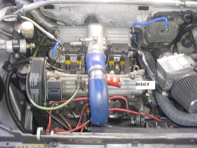

I'm guessing that you have an 'external' wastegate, which I'm also guessing will release the exhaust gas directly to the surroundings? Apart from the noise I can't see any other difference in performance apart from probably having the actuator calibrated to a higher pressure than standard.

I'm thinking you must have a larger turbo as well to get 170bhp, so maybe you'd like to share what your setup includes?
