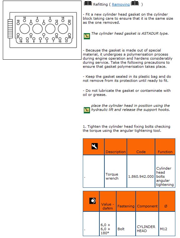

For example i tried to find the correct head bolt tightening sequence but unless i'm looking in the wrong place, i can't find it.
As i said i'm a HGV technician, so whatever motor or bike i get the first thing i get is a manual
If it's the way i'm accessing the data please let me know, because when you look at the space taken up on the CD & the size of the download, this would suggest a full & complete manual ....but i cannot access it

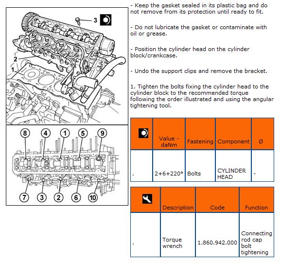

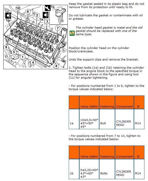

They are all shown in the procedures section for the different engine versions.
Many thanks Davren, it's clear now that my down load is corrupt...i cannot access anything under proceedures.
