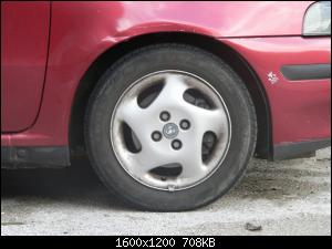

Then Simoni Racing -50, still too high at the front, too low at the rear, so decided to buy Vogtland -60. Mounted today the front, and it's high like with Eibachs -30. Is it possible? Damn, instead of lowering, the car goes up... grrrrrr :cry:
Had a ride, 20 km ~, other springs got ok in that time but they were used, these are new, but is it possible an ulterior 20 30mm drop by "breaking in"? How much time it takes? It's becoming a nightmare. :bang:

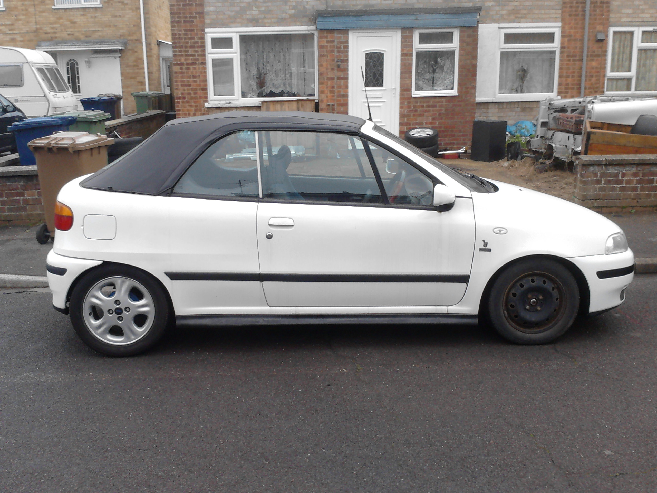

My cabby is -50 and thats low enough with the speed bumps round here. Is yours a sporting/gt or standard?

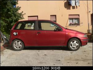

Simoni Racing springs, should be -30, but it lowers more than Eibachs -30 (looks like around -40 -50)

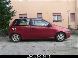

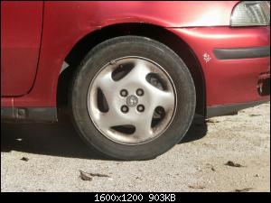

Vogtland -60 ****:
Simoni:
Vogltand:
I hoped for a similar result, not for a Punto that seems doing a wheelie... (n)

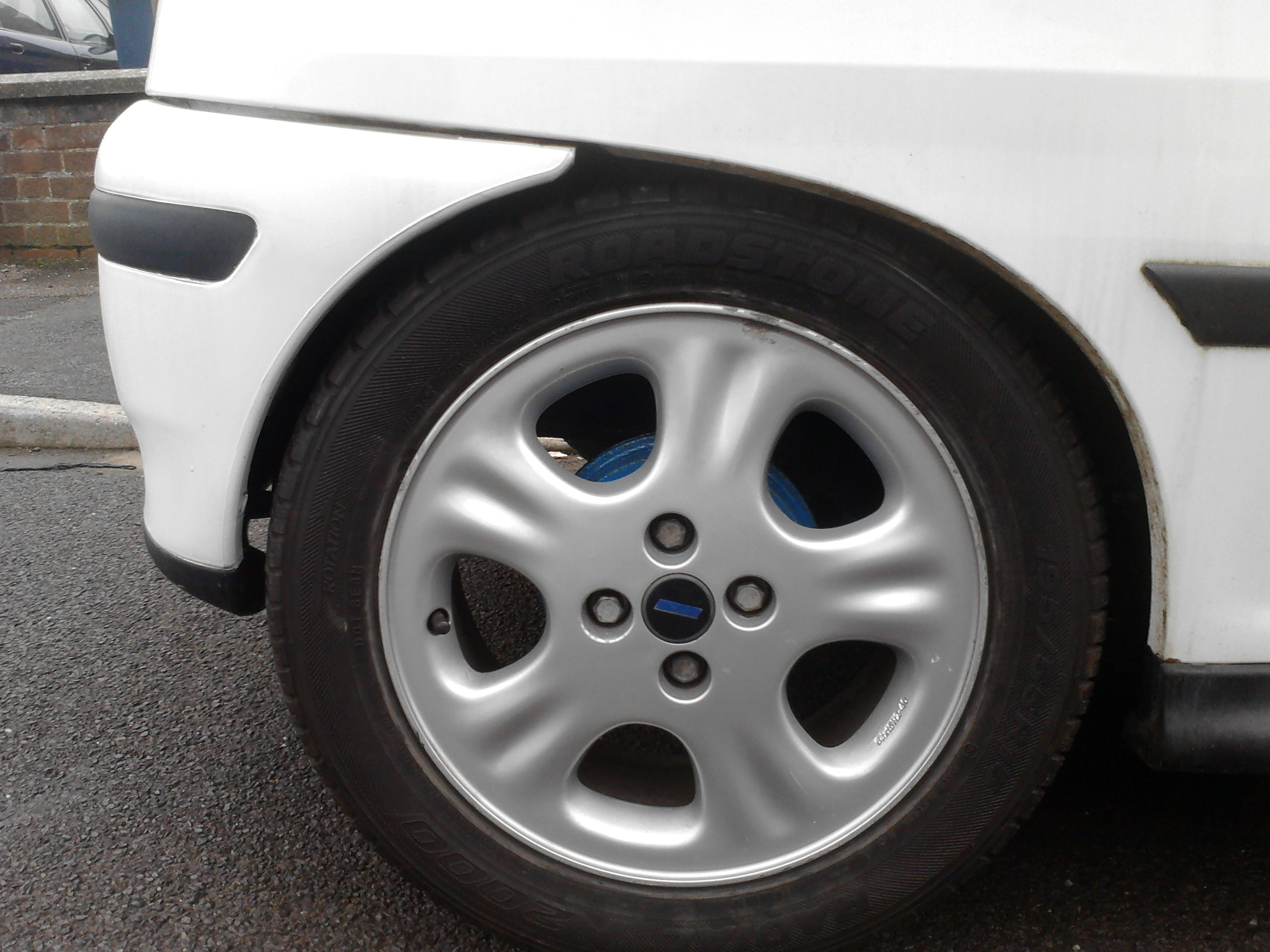

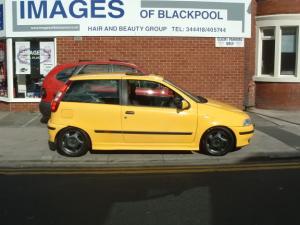

Try looking at a set of springs for the sporting models, they were already lowered by -20mm so a set of -30mm sporting will drop yours by -50mm. Will try and find pics of the cabby as had to put 15s on to get some ground clearance.

The Mk1 looks a bit higher at the front even if the car sits level. However, from your pictures looks indeed a bit too high on the front and is not level. Particular bad with the Vogtlands. I assume your boot is fully loaded with ICE hence this look. Can't see any other reason. I use Eibach -30mm springs designed for the GT (10mm longer at the front then for normal 60S version) and the car still does not look as raised as your car in the pictures. On the Simoni if you raise the rear by 10mm it may look just about OK, as the front will drop as a result and the car will look more level. And finally the spring shape on the Mk1 at the front is odd, and is quite hard to work out the spring rate exactly. Also the spring rates at the front are quite low (estimate of 80lb, for standard springs and about 100lb for my Eibach). Any stiffer for example needed for lowering to 60mm will result in spring to short to fit standard strut. To allow such fitment you will need some progressive springs which are hard to make considering the shape of the springs on a mk1. Alternatively you will need shortened struts which allow fitment of shorter springs. If you can get a picture of the GMAX front springs, and they look progressive wound then you have a change to go -60mm with them.

The rear wheels are 15" and the fronts are 14" at the moment. I need to get my tracking done as the 15s on the front catch the lower arm.
