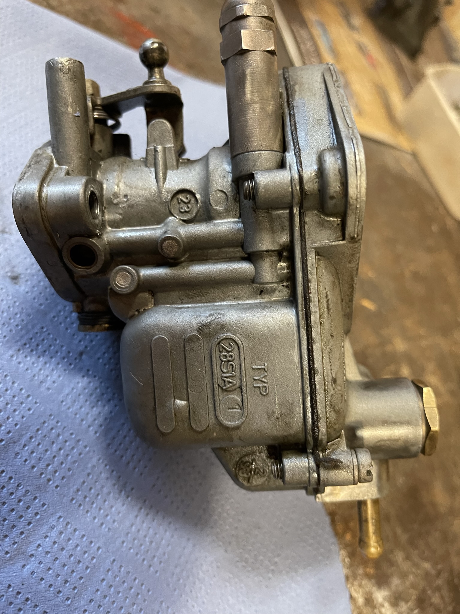

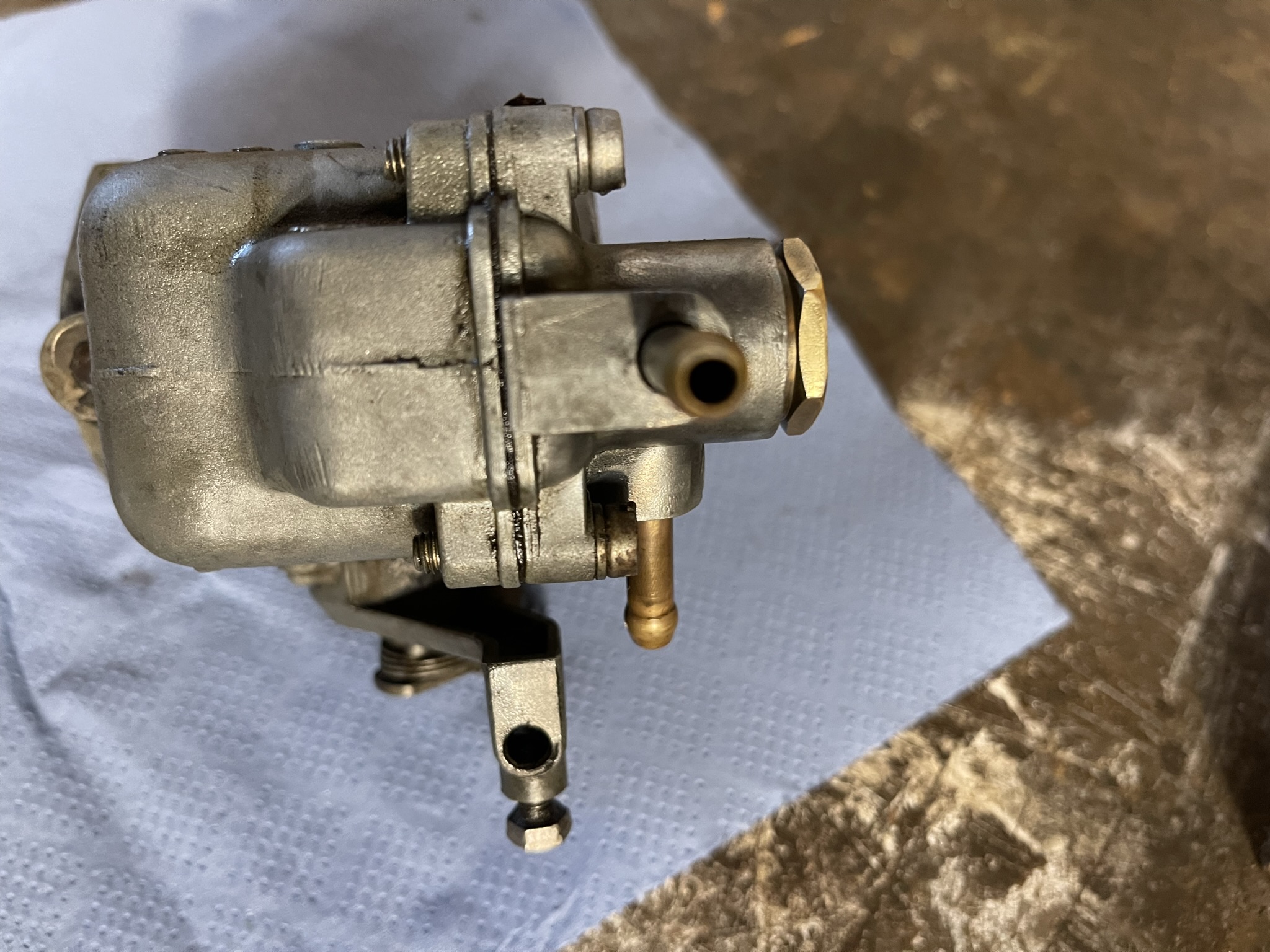

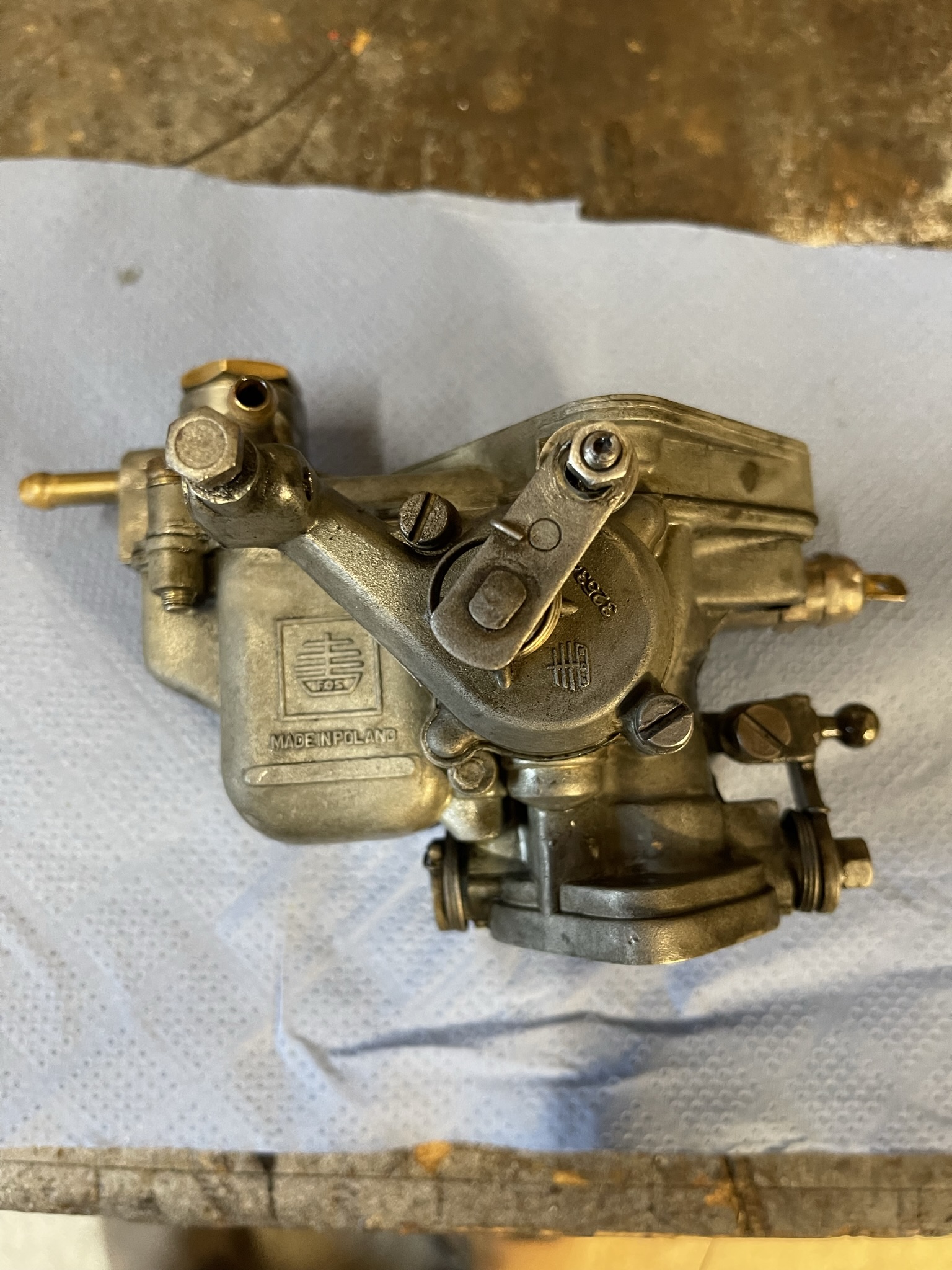

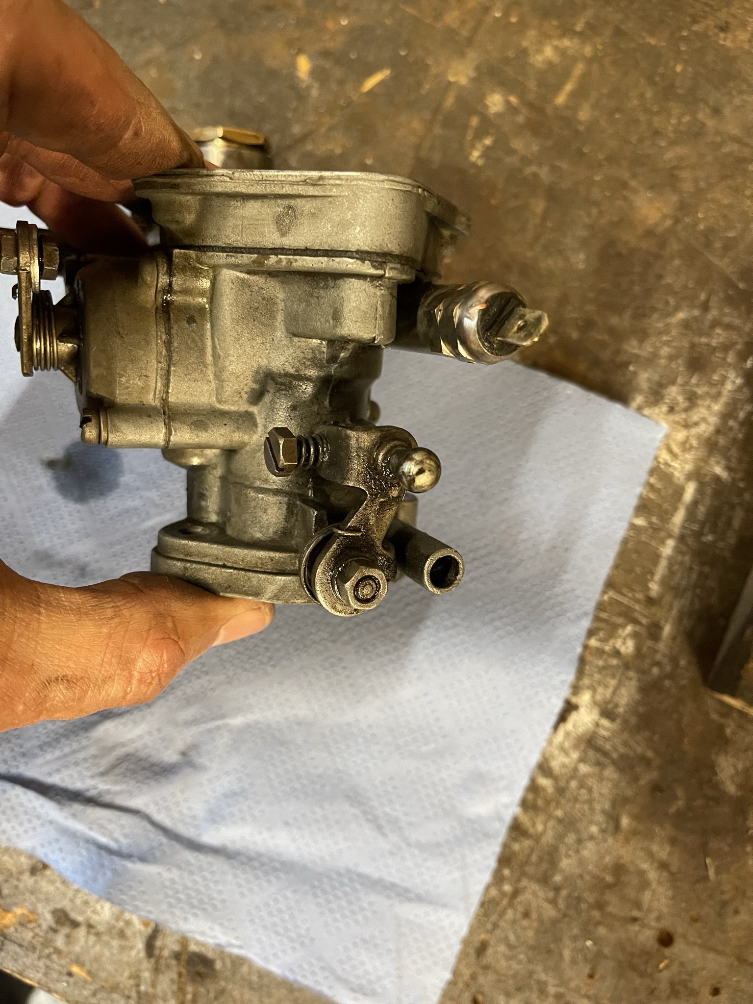

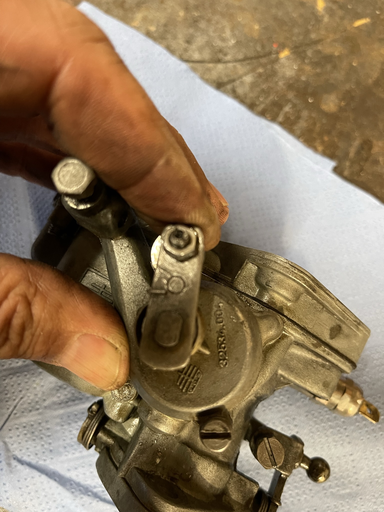

Hi here are the photos of the carb
The other option is to replace it.
What would be the best and most reliable option, it’s not a race car, I want a good solid carburettor

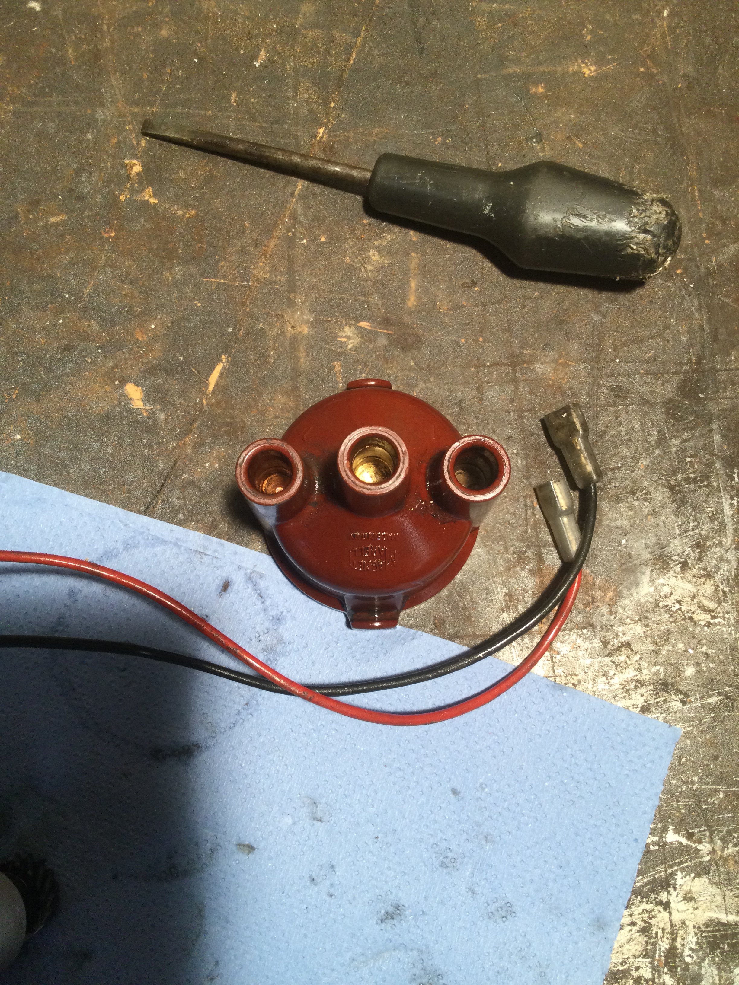

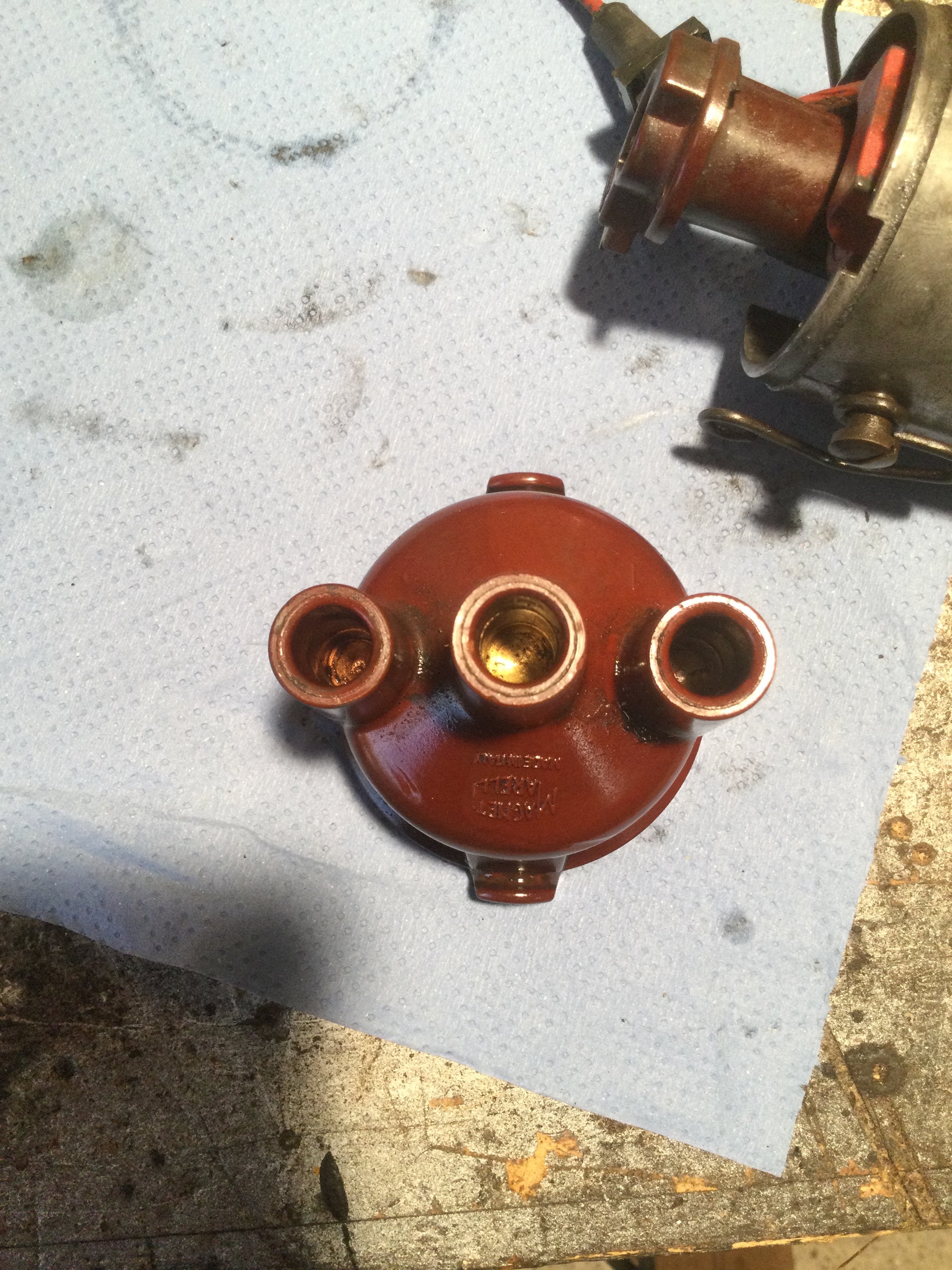

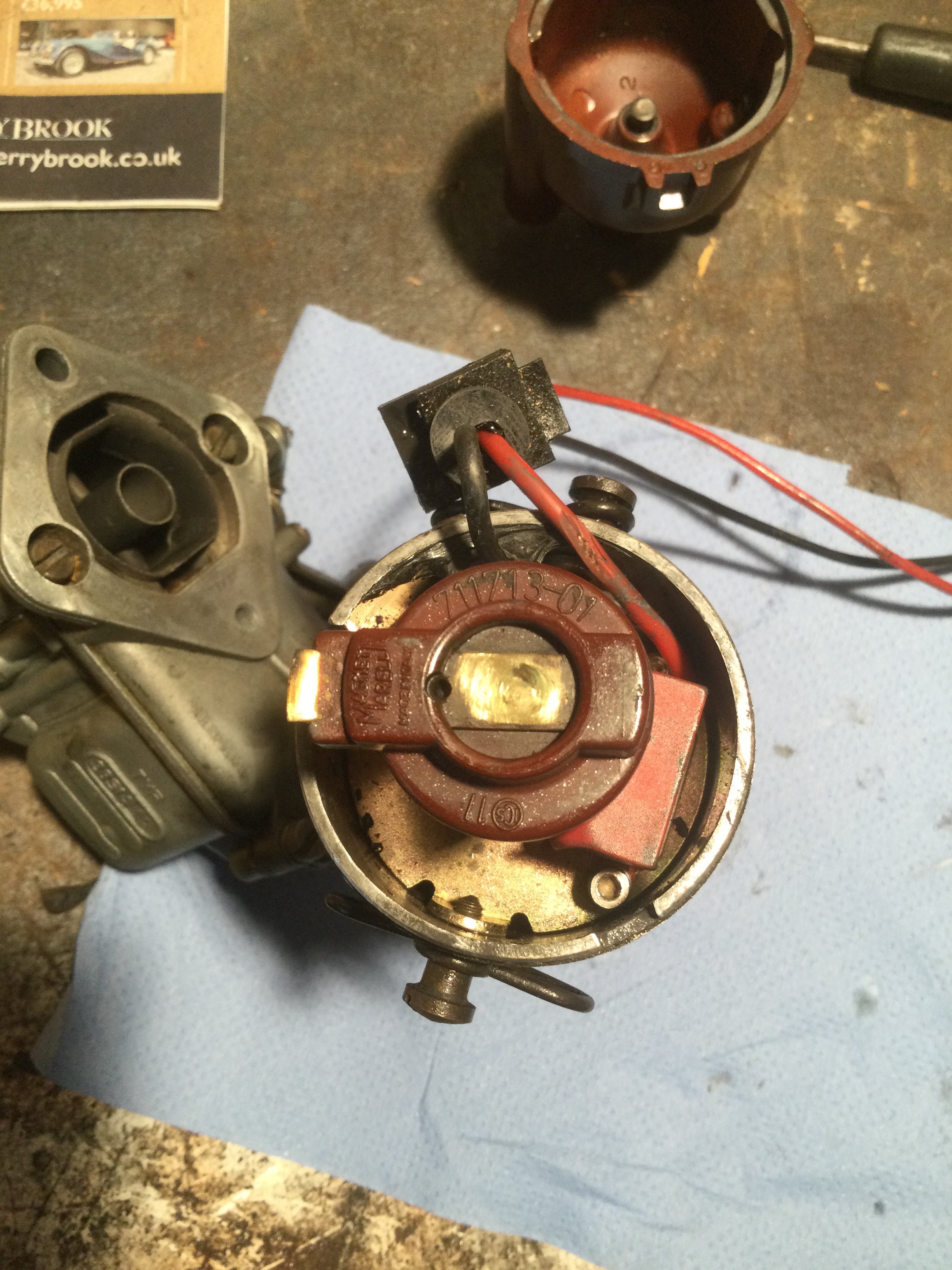

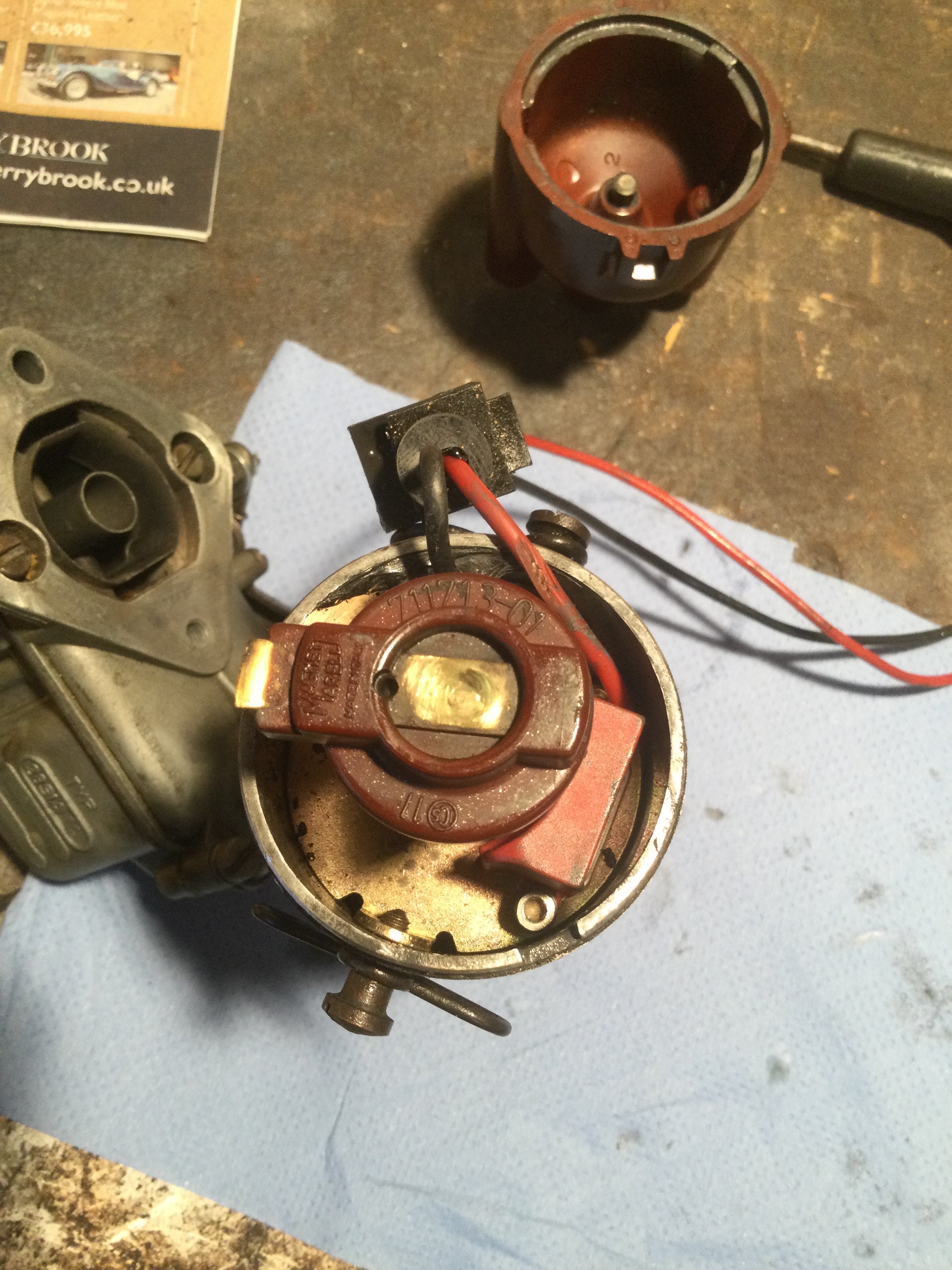

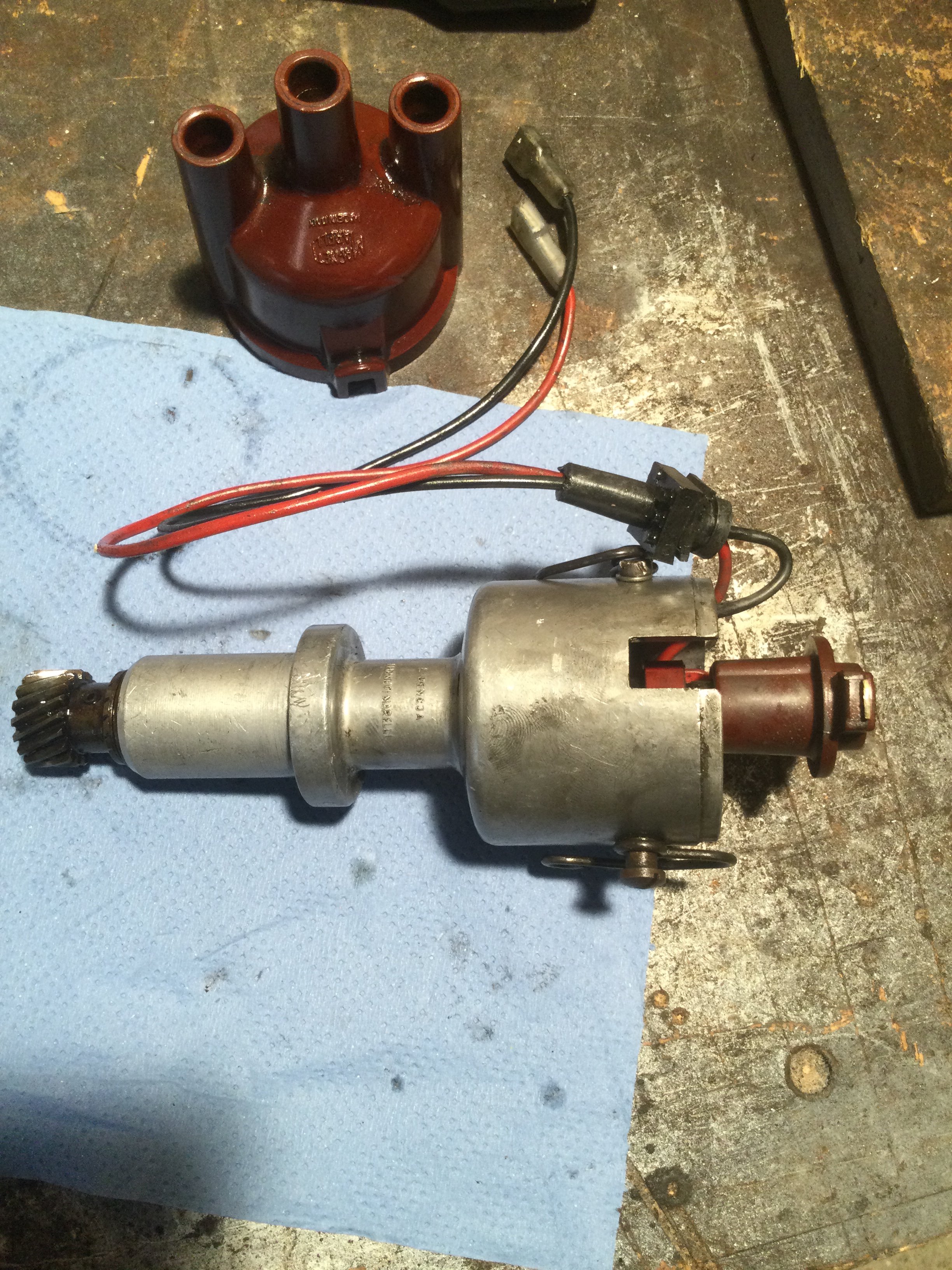

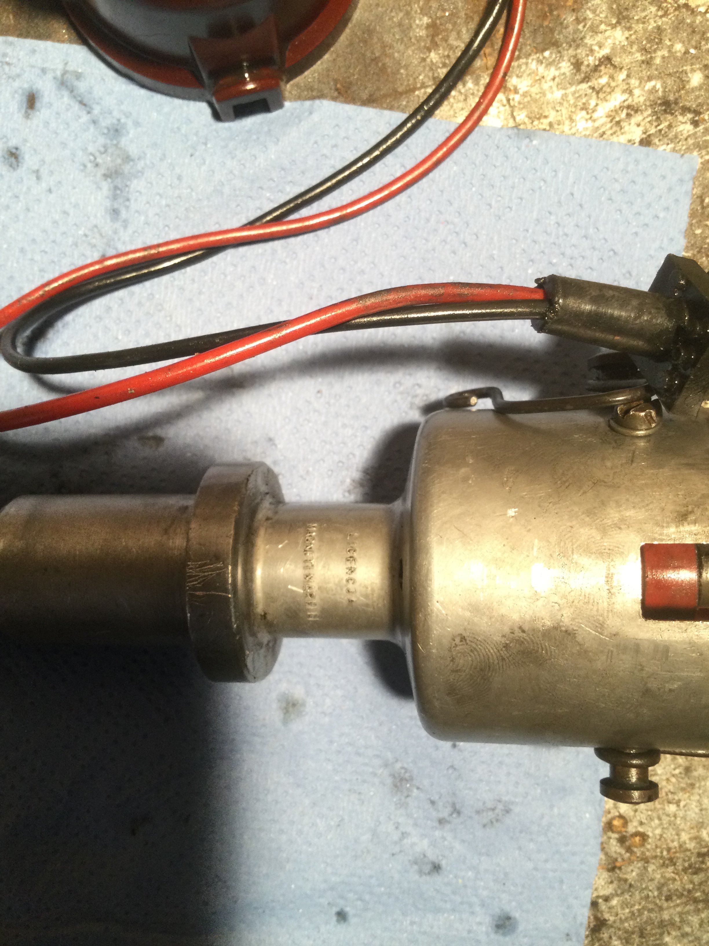

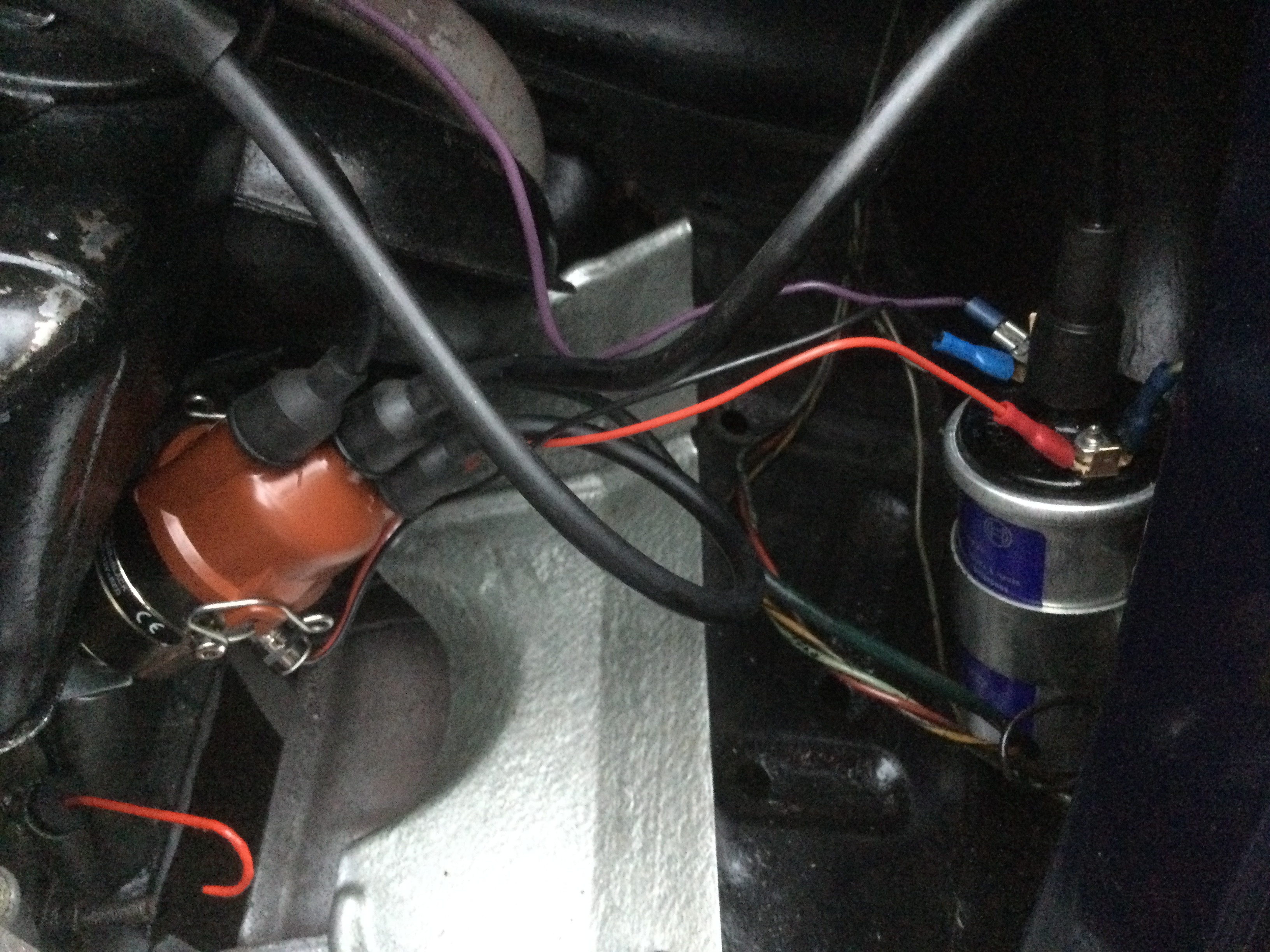

Here is the distributor (inside and out) I noticed the wear through on the red cable

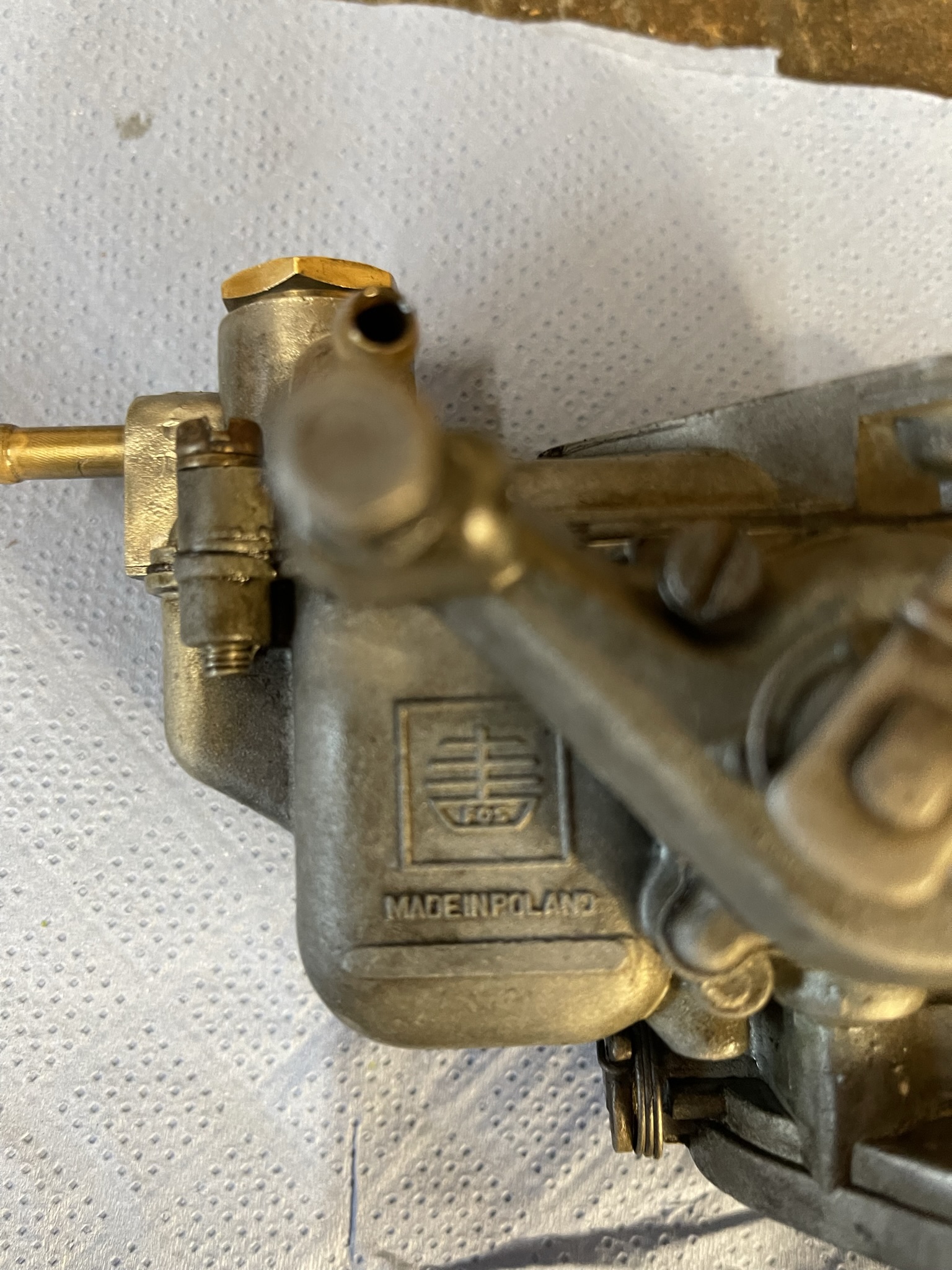

for your requirements I would say you are best sticking with a standard Weber 28IMB carb. Whilst I could quite happily sell you a refurbished replacement carb I am still thinking that the problem may be ignition based.

The carburettor

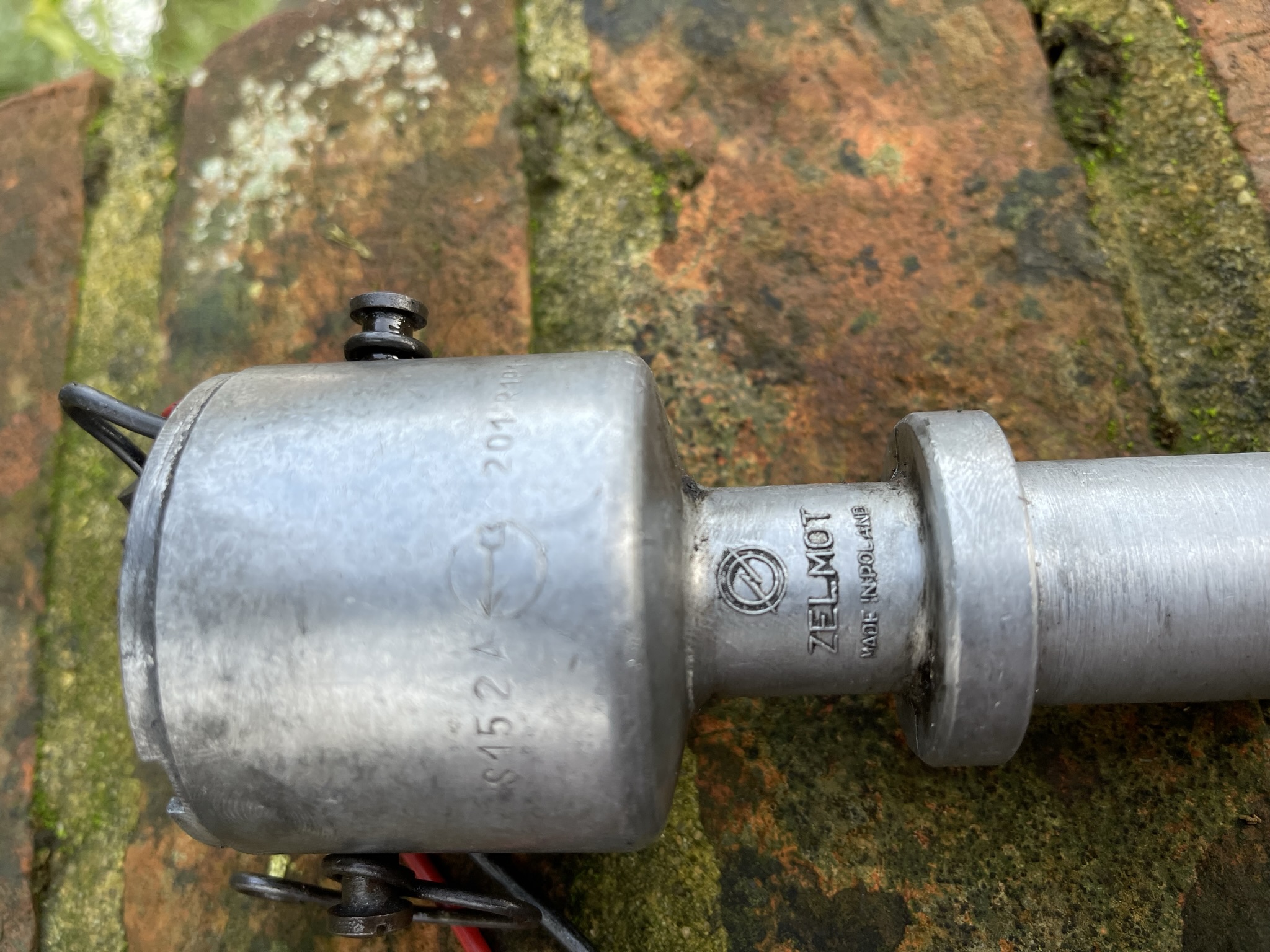

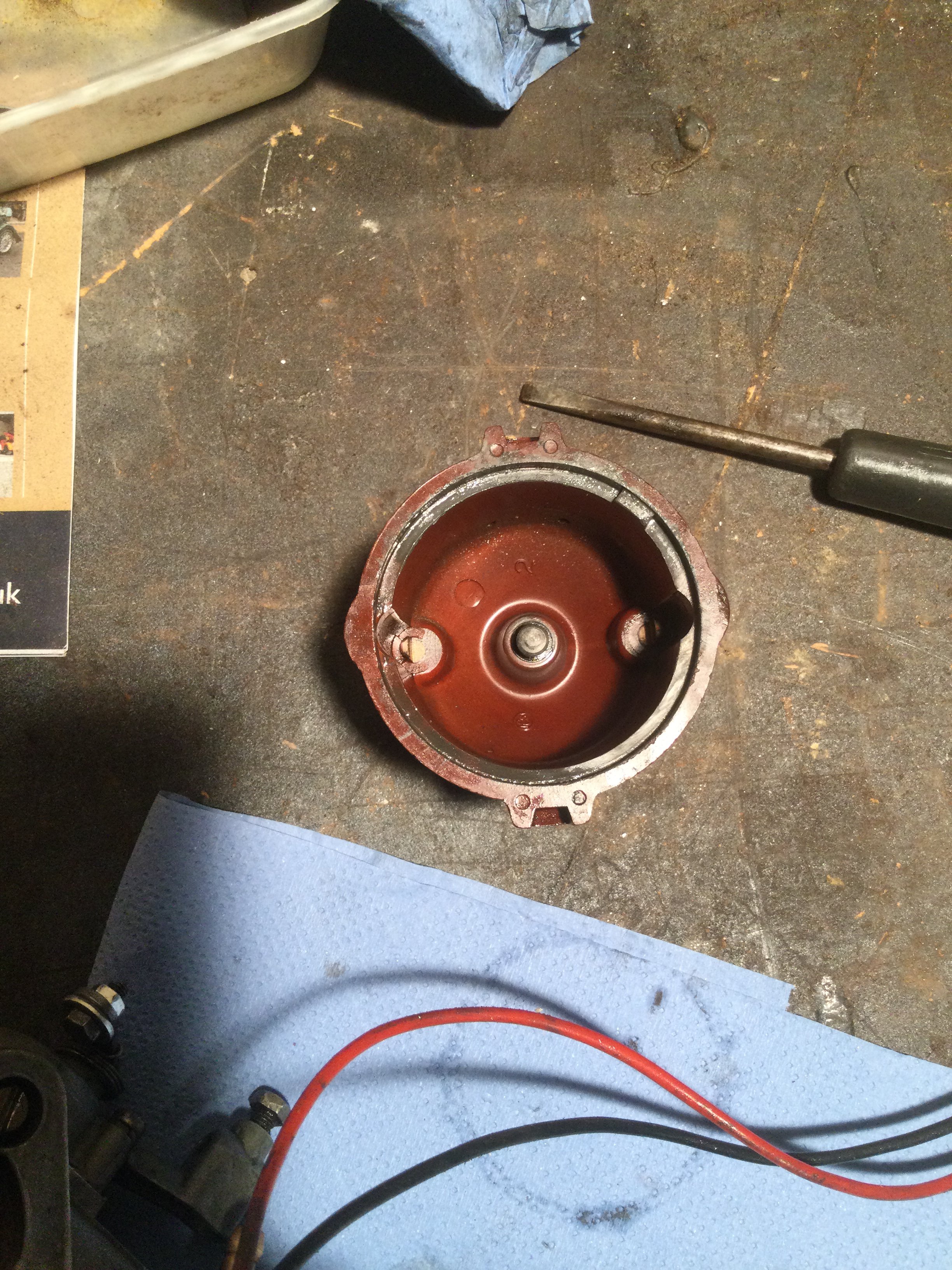

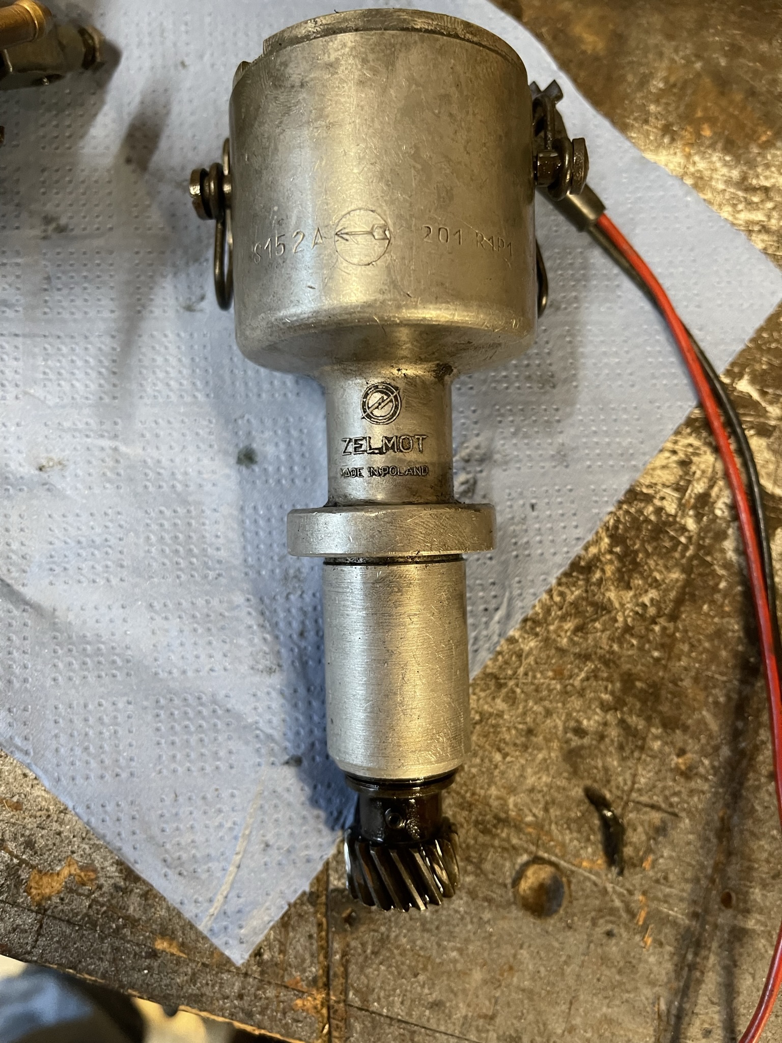

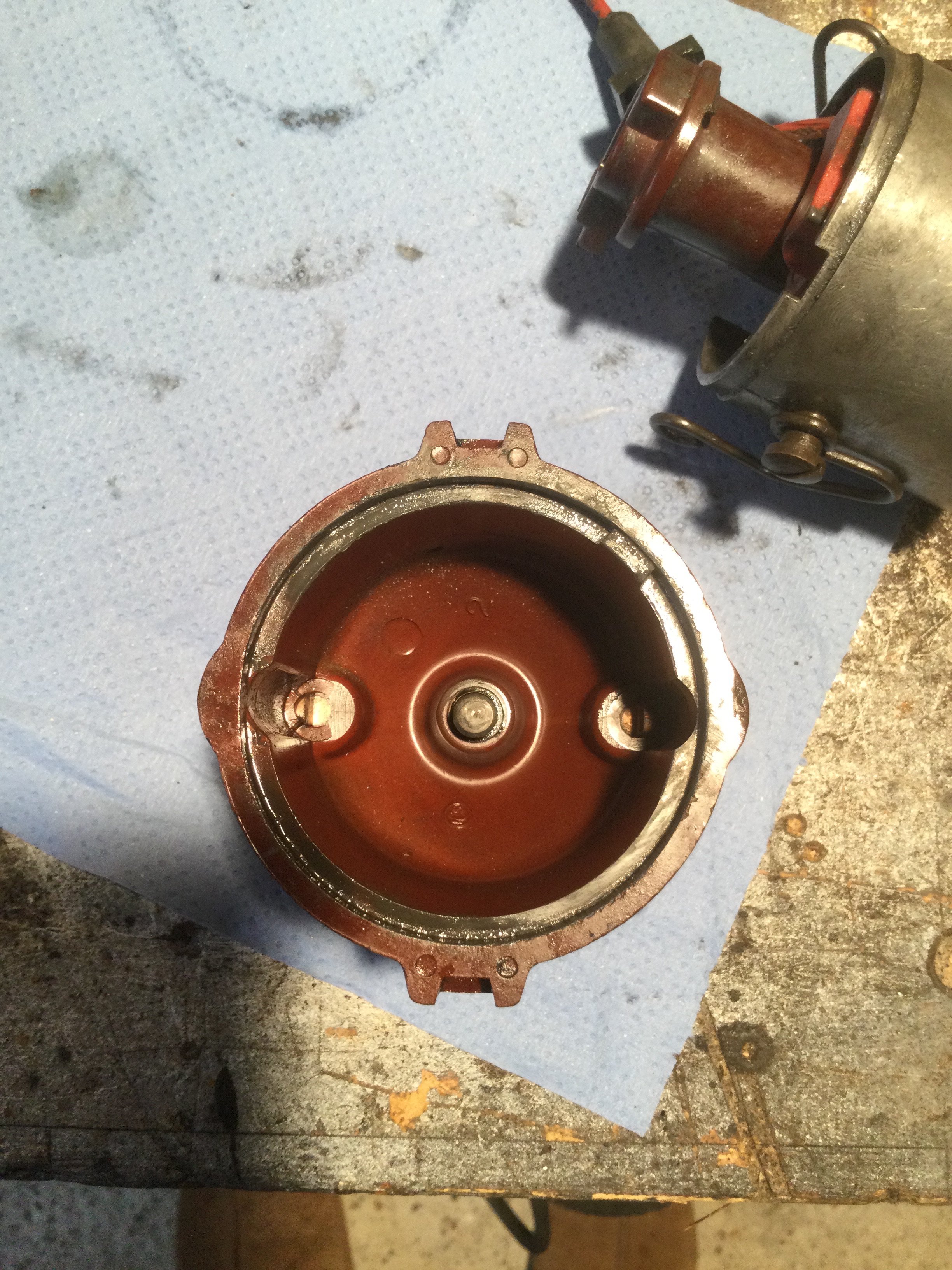

The distributor
no idea what happened to the first lot of photos

OK I can see you have an Accuspark type ignition. They have been known to break down on some occasions. But before you throw the baby away with the bath water you need to do some tests to eliminate fuel or ignition. Ignition is probably easiest to check.
When the car refuses to start do you have power on the low tension side coming out of the coil? This could be tested with a multimeter or a simple 12v test light.
if that is OK do you have power and a spark at the plugs? For about a £1 you can get a simple spark tester which would go onto the plug and the ht lead go onto that. The tester will light up when the power passes to the plug.
The distributor
I think your distributor cap is damaged, especially around one of the inner electrodes.
It's not obvious to me how the red and the black cables are exiting the distributor; are they trapped under the cap? As you say, that damaged wire will definitely be a part of the problem.
I would fit a new distributor cap and rotor arm, sort out the damaged wires with replacements or very well cleaned up and reinsulated and thoroughly clean up inside the distributor, checking that it's all set up as specified by the manufacturer.
Personally I would also go back to the original contact-breaker, but the main thing that's obvious is the cap.

In conclusion to the “frustrating engine cut out“, it WAS the distributor.
On close inspection it was worn and failing everywhere.
This was replaced with the https://www.ricambio.co.uk/complete-123-electronic-distributor-classic-fiat-500-126. Which was an easy fit ( note the set up LED is inside under the cap, not stated in the instructions).
