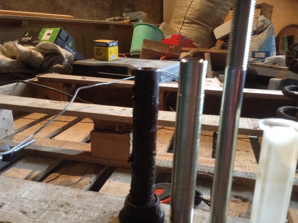

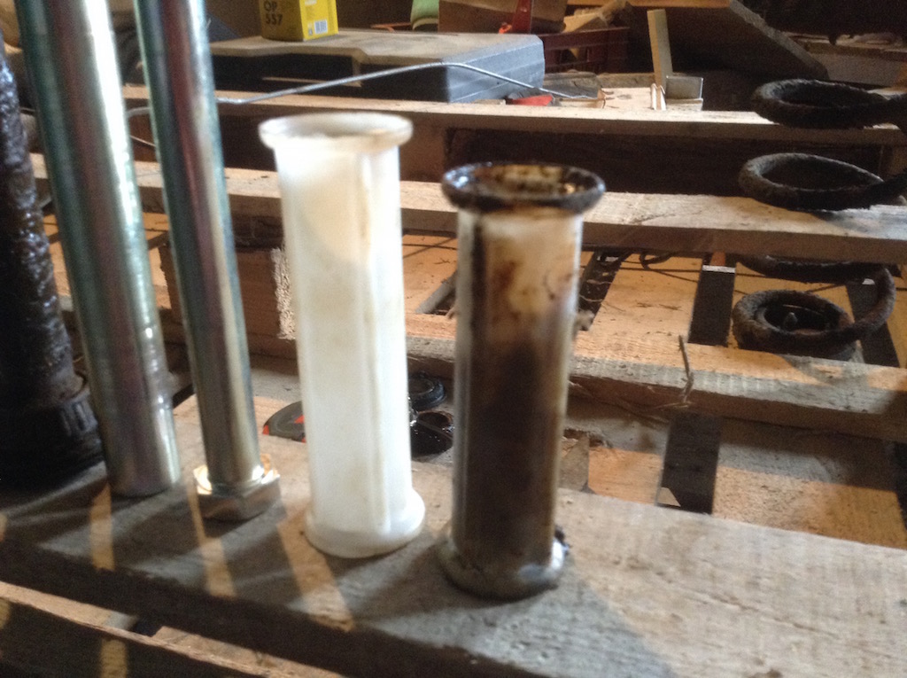

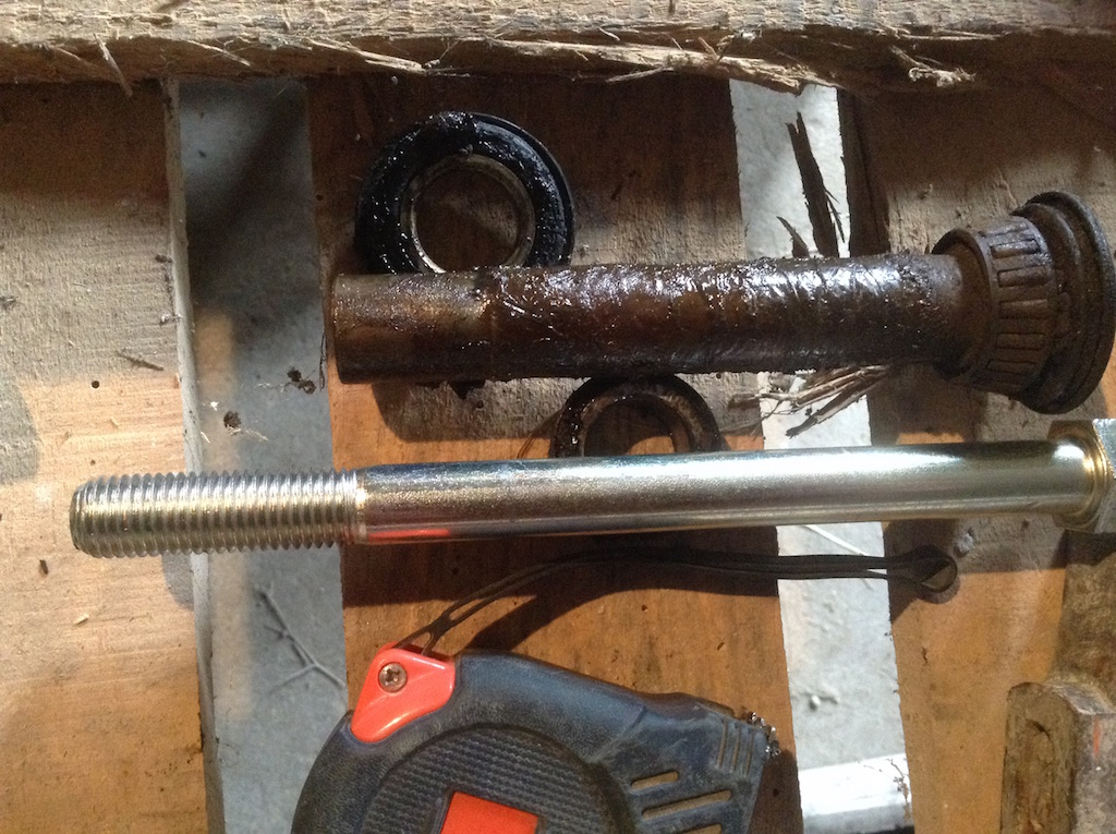

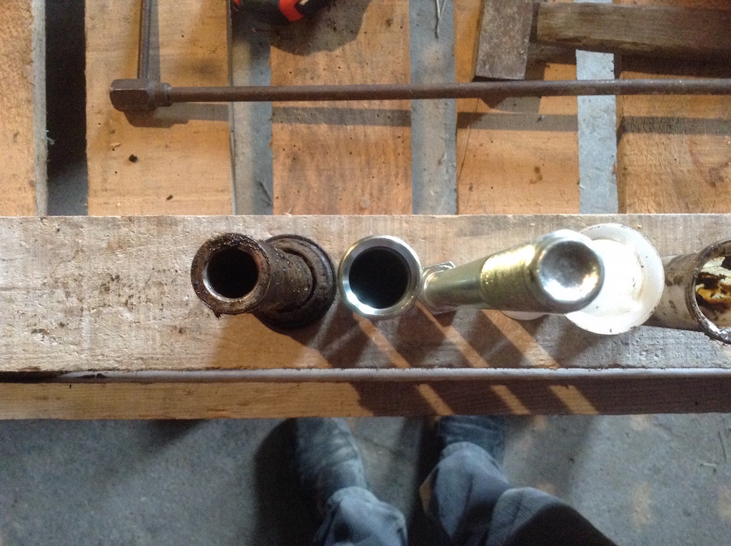

Here's my problem. I am changing the rear trailing arm bearings on the 1996 60HP one, using the absolutely excellent guide in the tech section of this forum. I am following the instructions very closely, and I just got to the bit where you insert the plastic spacer between the bearings, having removed the old ones. When I removed the spacer and put the new one in, I found that the new one wouldn't fit - it is just under a centimetre too long. Alarmed, I looked at the metal tube that goes inside it - and that's too long too, but the same amount. And so is the bolt.

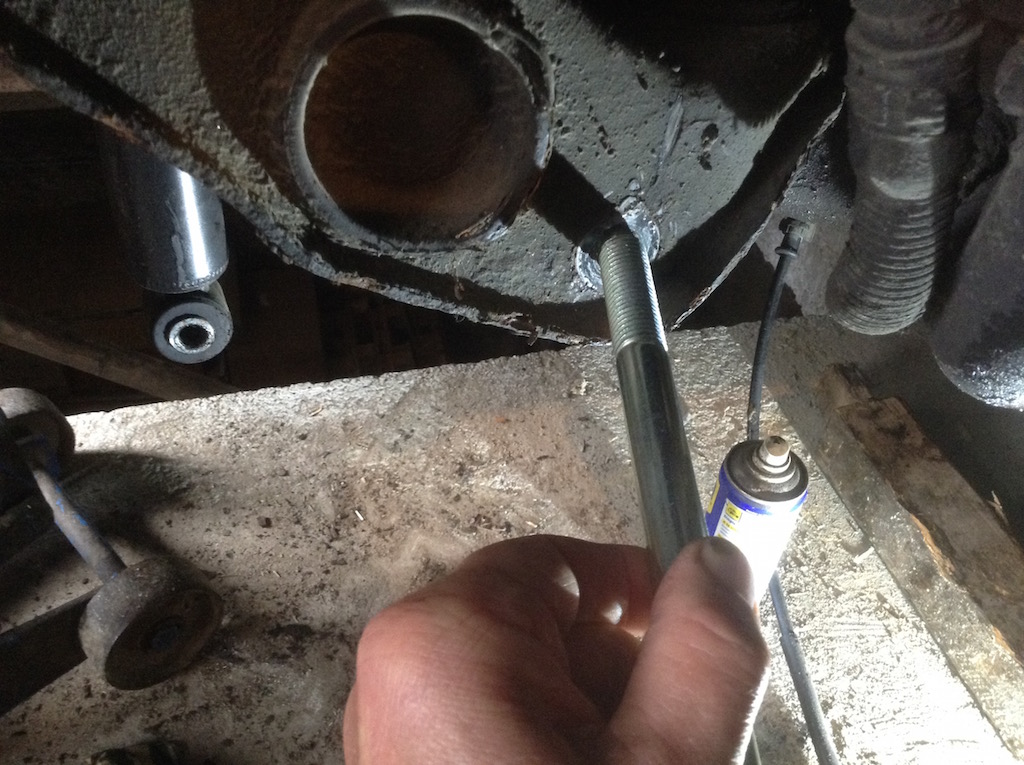

The parts all fit nicely into the bearing housings (I have already installed one of the bearing races and it's the same size as the old one), but the diameter of the hole in the trailing arm mountings on the car is also too small, because the bolt is 1-2mm larger in diameter.
My question is, has anyone else had this problem, and if so, was it O.K. to do what I am hoping to do, which is simply cut down the plastic and metal spacers and drill out the holes in the mountings on the car to take the larger bolts. I don't think I even need to cut the bolt down, because there is room for it to stick out a bit more at the back. I'd have to cut the plastic spacer in two and take 1cm out of the middle, so it would be in 2 parts, but I don't see that that would be a problem (would it?)
And does anyone know what's happened? My guess is that either I have been sent a beefed-up one from a different model (Sporting? Mk2?) or simply that they got changed in the lifetime of the car.
Anyone else had success or failure trying to modify them as I intend - and would I just better buying a new pair (that's slightly fraught as I am in France and the deadline for the French MoT retest is next week, so there isn't really time to order a new pair)? I am also worried that I might just end up with another pair of wrong ones...

By the looks of things, you have the wrong parts. Immediately clear by the pictures that the new parts are too big.
Yes, I can see that they're too big - what I am trying to work out is if it is O.K. to trim them, as it would be pretty easy. I can't see that cutting down the spacer tube and drilling out the hole in the trailing arm mountings would be a bad thing, but I wondered if anyone had tried it before.
I cannot see that Shortening would be too big an issue, but Drilling Out..

Thanks Charlie - this is most helpful. I'm not great at deciphering the eper, but as I read it there are 2 lefts (7769900 and 46553689) and 2 rights (7769901 and 46553691). It doesn't seem to give any info about them except the weights, which are different. However, the one I think I need (46553689/91) is over a kilo lighter than the other one - I know this is the whole arm and not just the bearing, but circumstantially it does seem to say there are two. I know I don't need 7769900/01, because that's the one I've already got, and it's bigger than my old one. Here it is at mister-auto, who are a great source of cheap parts, although I got mine at eBay UK http://www.mister-auto.com/kit-de-reparation-bras-triangulaire/delphi-td532w_g772_a089TD532W.html
This is the one that's too big - it gives the dimensions, and it's 215mm long, which is the bigger size.
So my guess is that at some point they beefed it up, and that mine is the early one (it's a really early car). Unfortunately they don't seem to be selling the smaller kind, and I am with you all the way about drilling out the holes in the trailing arm carriers - that's what I was worried about. The best solution seems to be to do what you suggest - in fact I can do slightly better, because I can use all the new bearings and housings - they are the same on both kits. The only parts I'll have to re-use are the plastic and metal spacers and the long bolt and nut. The metal spacer is fine; the plastic one is a bit mangled at the end where I had to cut it a bit to get it out, but I could probably re-use it if I silicon the back - I think that all it does is keep the grease in, and that will take a pretty long time to leak out. Unfortunately I had to cut the nut and bolt to get them off, but I think I can probably get new ones at a bolt supplier here, and that's probably the best course of action. I have only stripped one side so far, so I will take special care to make sure the nut and bolt the other side are reusable when I do that one.
As most of the kits on sale (and they are the same for Puntos and Ypsilons, as usual) are the bigger kind, I think the change was probably fairly early in the production run. That would also explain why I seem to be the only person to have had this problem.
Thanks for all your help (and everyone else's too) - I'll keep you posted on how it goes...

No, pretty sure the Teflon tube isn't load bearing (we'd be in trouble if it were, because it's not very strong!). The taper rollers are lodged very firmly against a metal rim each side, so it's definitely not holding those apart. The metal spacer runs in it but is kept centred by the bearings, so the Teflon tube doesn't do that either. The only functions I can see that it can perform are a grease seal and transfer conduit - it has ridges along it which I think the grease is supposed to run in. And it's not all that effective at that, because mine and most of the ones people have posted in the forum are dry as a bone and have obviously been running like that for years. I haven't damaged it too badly, so it should be reusable. My biggest worry is whether I can reuse the nut and bolt, because I'm not sure I can get those in the right timescale. We cut the end off at a diagonal, so the nut is knackered, but an M12 nyloc nut should be easy to get. But an M12 110-105mm bolt would be a lot harder, so I am hoping there's enough thread on it to reuse it...
The dimensions of the metal spacer are critical because it stops the bearings being crushed , or being too loose, when through bolt tightened.
So reusing old ones good plan.
