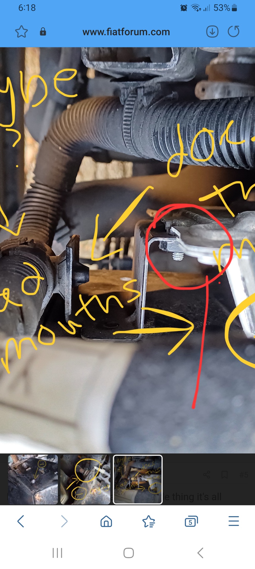

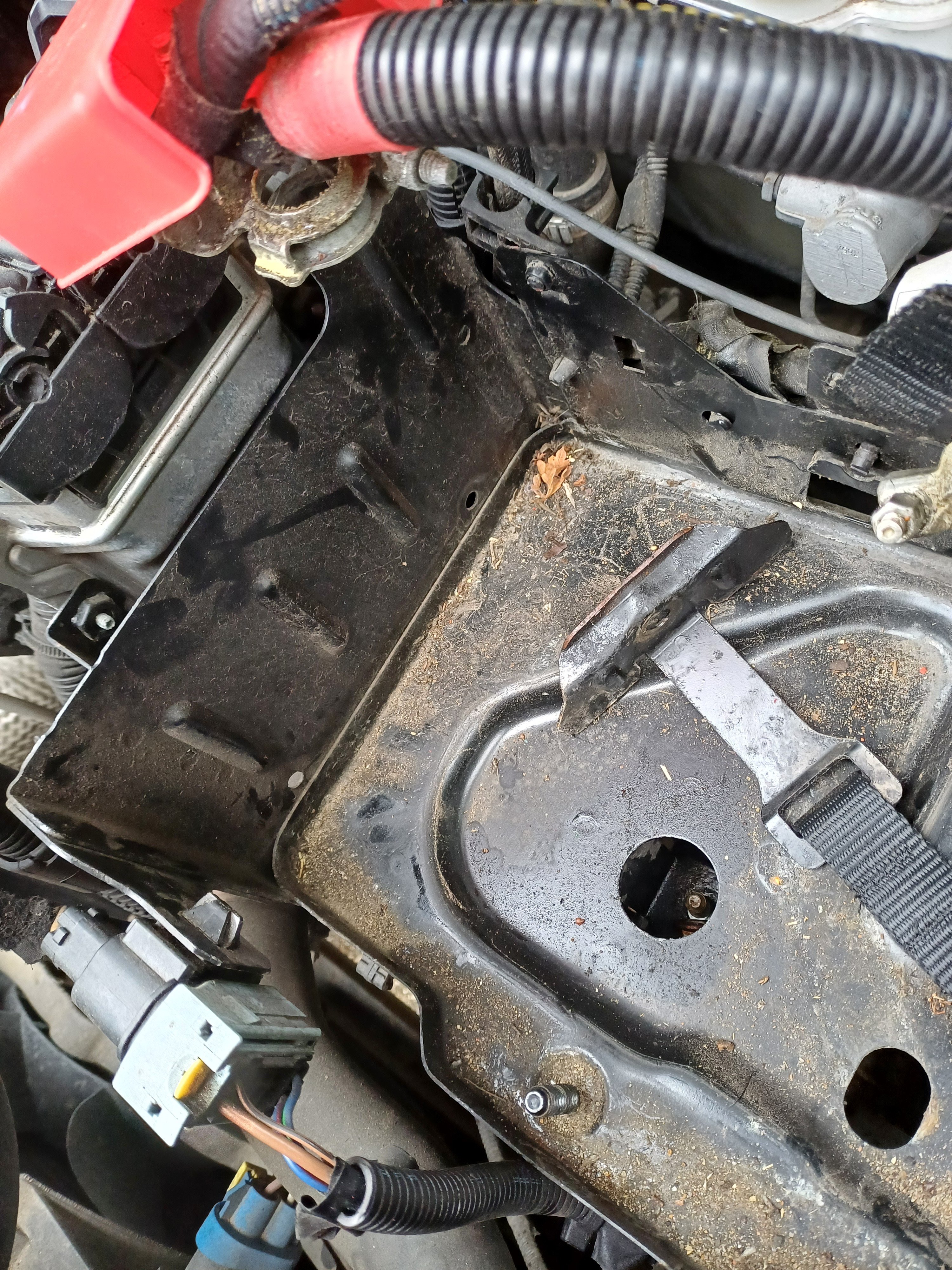

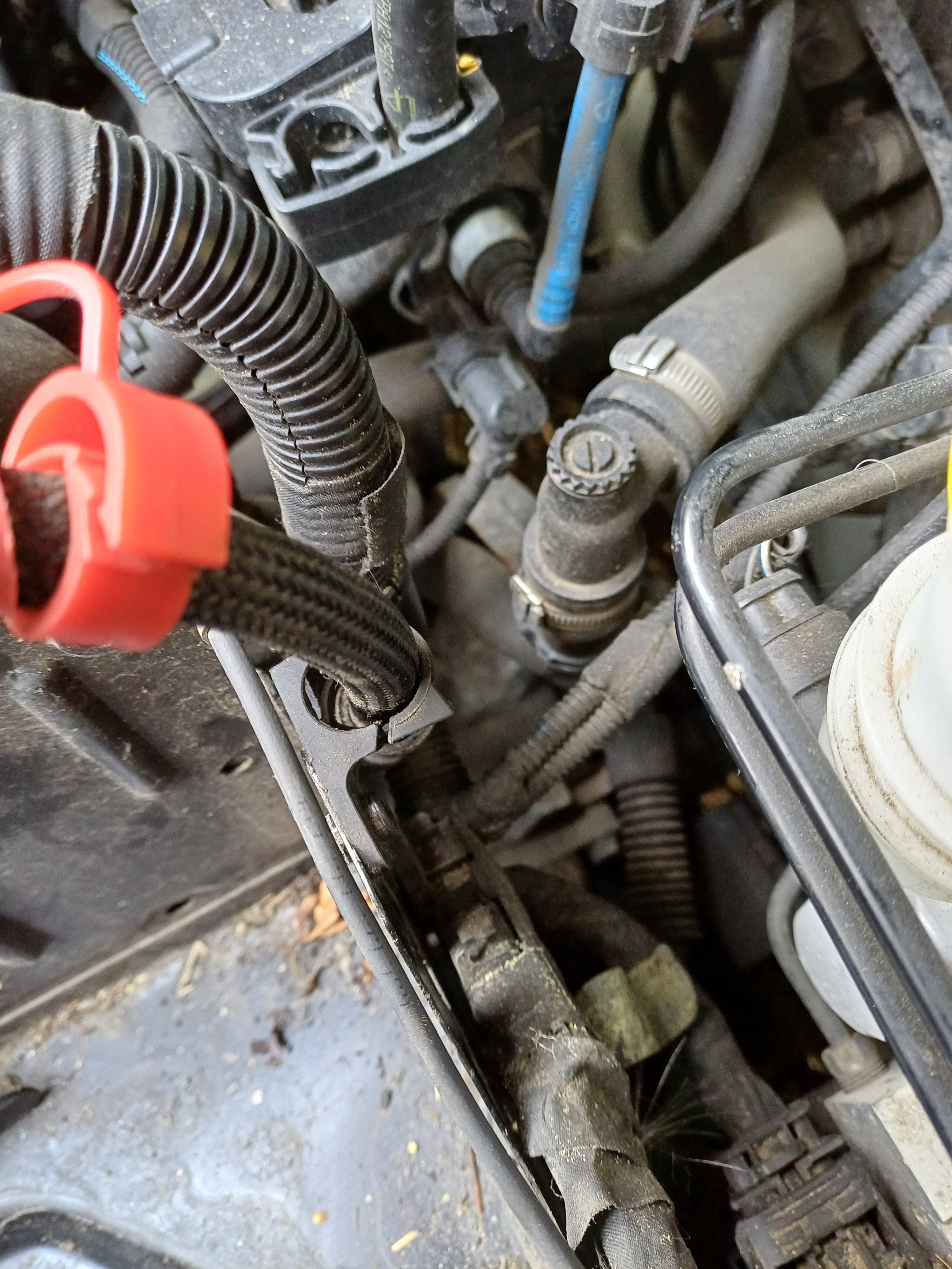

Currently sitting on the drive getting hypothermia. I'm gonna change the clutch slave cylinder, and have spent the last 40 mins stuck on the battery tray. NONE of the zillions of videos I watched show how to take it out properly. They just say take it out. I undid a clip at the front, but the clip at the back is different, as it this thing on the front. I don't wanna break my car. I also dont wanna freeze to death. I hope someone sees this and can help before it rains. Thankyou so much.
edit: the black clip, not the red one.

k, so none of the videos show anything about detaching these bits. I'm freaking out. The sides and bottom are one unit. omg I knew I shouldve gone to the allotment first.

ok after alot of crying, I just went for it and was able to get these bits off

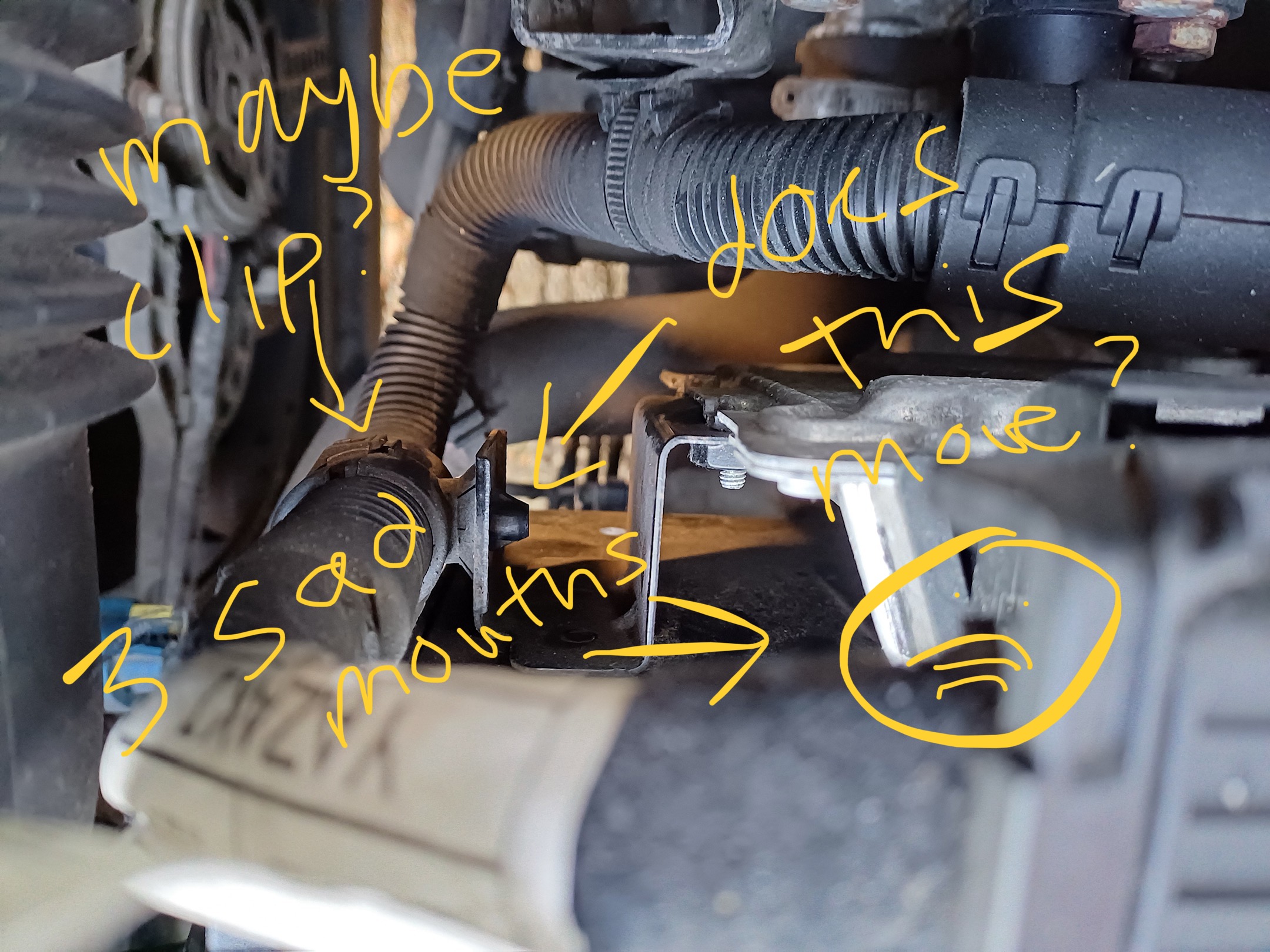

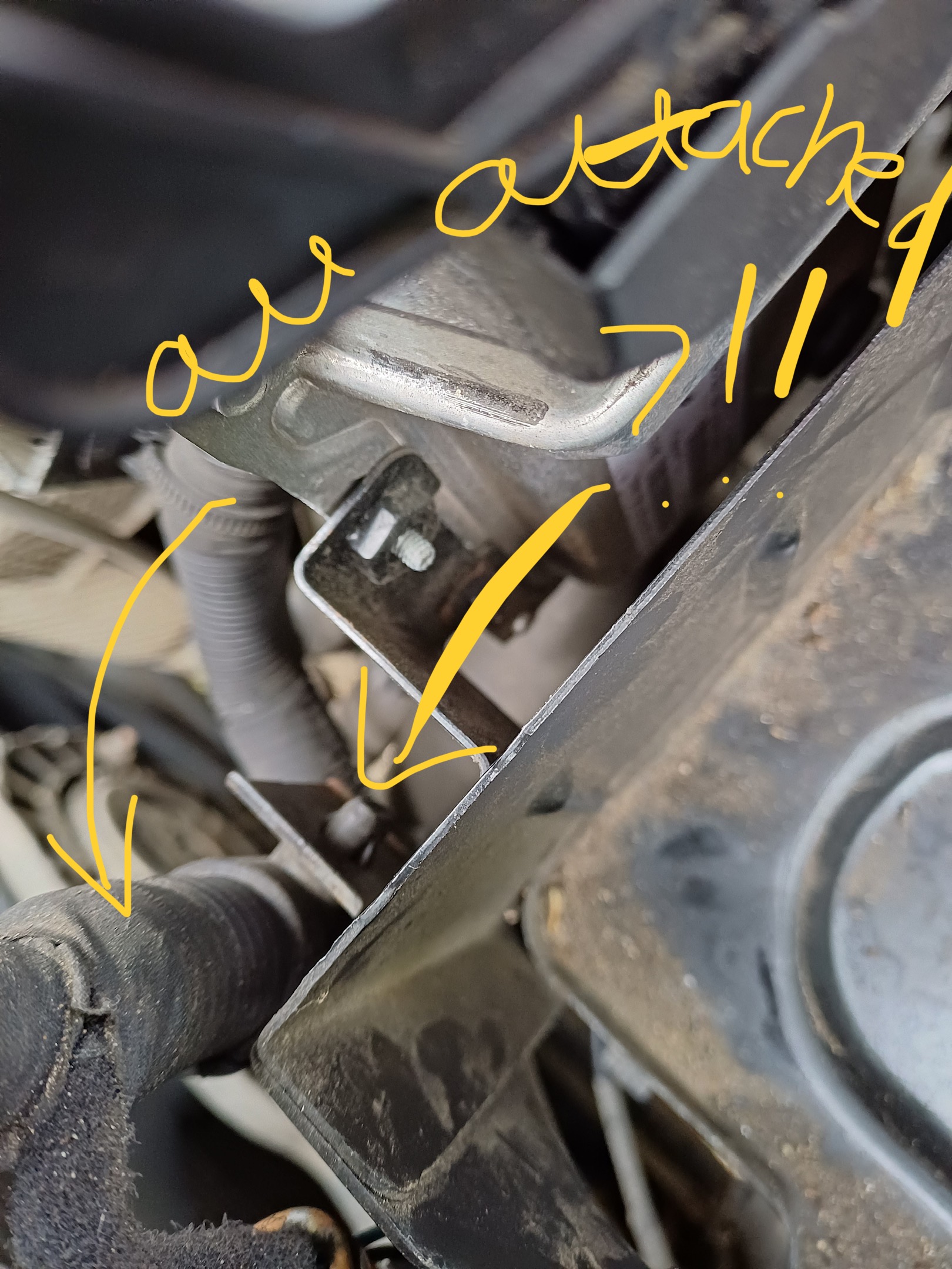

but have now seen another bit, and maybe there are more bits I cant see. NONE of the men in the videos said anything about any of this.
Please help with these bits too. Thankyou.

Removing the battery tray is a simple thing it's all either plastic fittings clips or bolts, none of these should present an issue, if they are then don't even try to do the slave cylinder.
Your first pic you just crimp in the bit sticking through and push through, second pic I cant work out if that's a lead to the actual tray but still looks like a simple unbolt?
You just need to work out how bits come apart?
That's what I want to check. as I don't want to do it wrong. I don't want to force things apart that aren't meant to come apart. There are lots of things attached to it. Some I have removed. A guy walking his dog just took one bit off, he said I needed to squeeze it and push it thru, which I was scared of doing incase I'm not meant to. The bit on the back wall that looks like a witches hat.
The slave cylinder doesn't look hard to change. I just want to make sure I'm not doing anything wrong as I have no one else to ask.

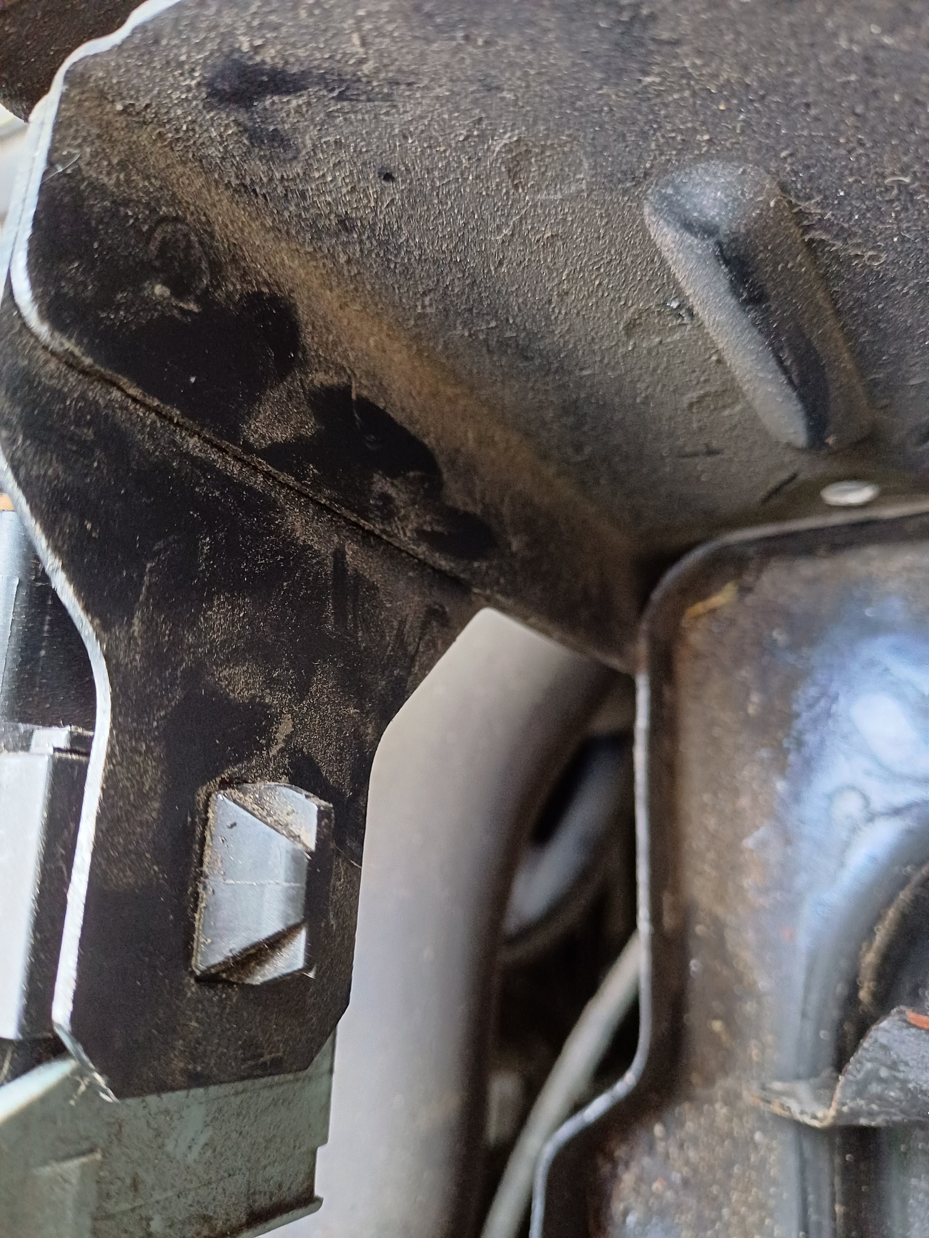

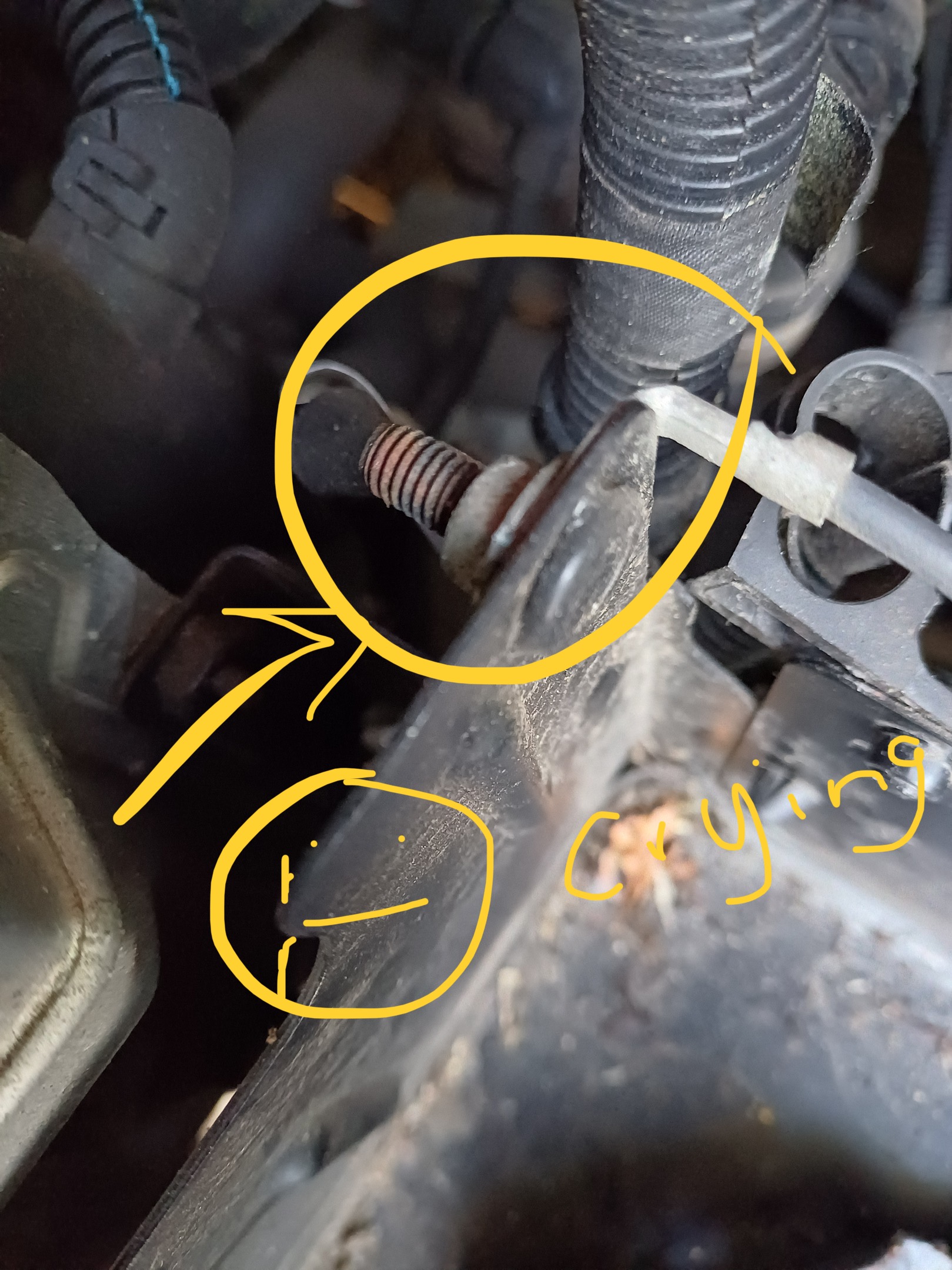

Is there a trick to getting these four bolts off pls? I tried with a spanner, but the guy walking his dog said it might be an alan key. They are really hard to reach and super tight. The bottom front I cant reach with a spanner, and I cant get to the back ones atall.

Most parts are bolt on or push fit, so it's a case of working out how to release the push fit, fittings, your last pic the bolts go in from the back, the nuts on the tray are welded on, so look round the rear of the silver box which maybe the engine ecu, note whilst simple to replace the slave cylinder, bleeding the air out is often a two person job, and expec fluid to go all over so you'll need a bottle of brake fluid too
I did mine with a 1/4 drive socket and extension. These are VERY EASY TO DROP. once freed ude fingers and hod a magnetic pick up tool under or pack around with rag to stop screwsbeing lost.
..as john202020 says those nuts dont come offundo the silver screw only. Them 3bolts thathold the tray on which are under the plastic tray that lfts out. Then release all the wire clips underneath. Take your time itsfidly, not hard. Must plasticharness clips need squeezing with pliers to allow them to be pushed freof the metal tray.
Thankyou. I did wonder if they were welded, thats why they wouldn't budge. I'm getting braver with poking things, but the one that still scares me is the big pipe. I'm not sure if I'm meant to force the big clip that goes round it off, or If theres a lil clip i push thru. It doesn't budge atall, unlike the other one that had some give in it.

Yes nuts welded bolts or screws should loosen easily enough. Dont over tighten on fitting just nip them up.

How is the pipe that says ecu attached pls? Am i meant to remove what looks like a clip from around it, or does the bit attached to the lil metal plate come out? Ty.
