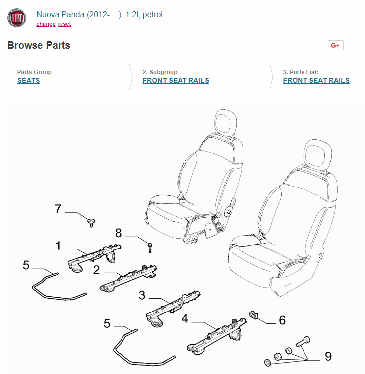

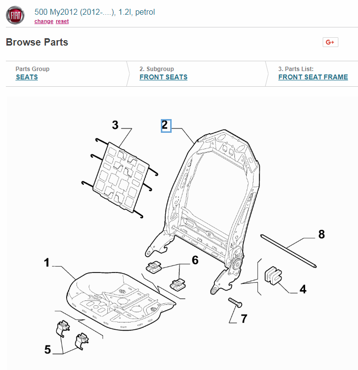

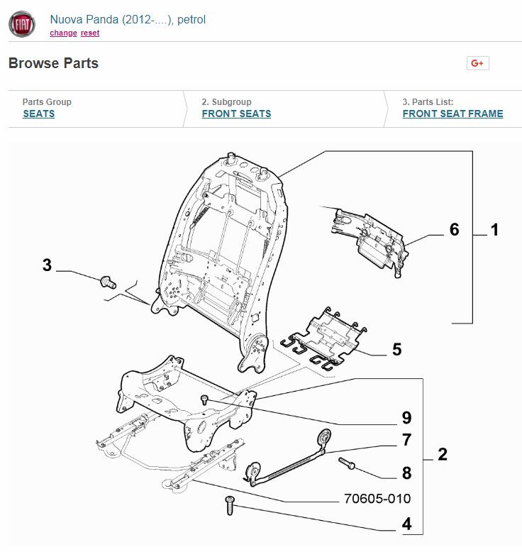

Yes, seats from 500 would also fit. But I would say that seats from the new Panda are a better choice because they have better inner frame construction, including solid metal support on the back part. Seats from the 500 have a frame quite similar to the original panda 169 seats. I haven't tested them though. You can compare the seat construction of Fiat Panda 169, Fiat 500 and Fiat Panda 312 below (images taken from catalog at fiatdalys.lt )

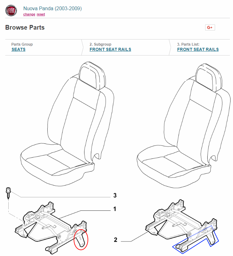

If you're willing to destroy the old seat, I would try to use the complete rail from it (marked blue, see pic, for a LHD car) - it seemed quite similar to the rail on the new seat. Or at least try to separate the part marked red from the old rail and use it on the new rail.
I haven't tried any of this because I wanted to keep the old seat in case I needed to mount it back some day...

It's just a 90 degree angle that bolts to the car floor and the seat frame. You could also fit the new seats to the old sliding frame. Photograph your seats at the area shown in the image above and check it against the seats you want to buy.
