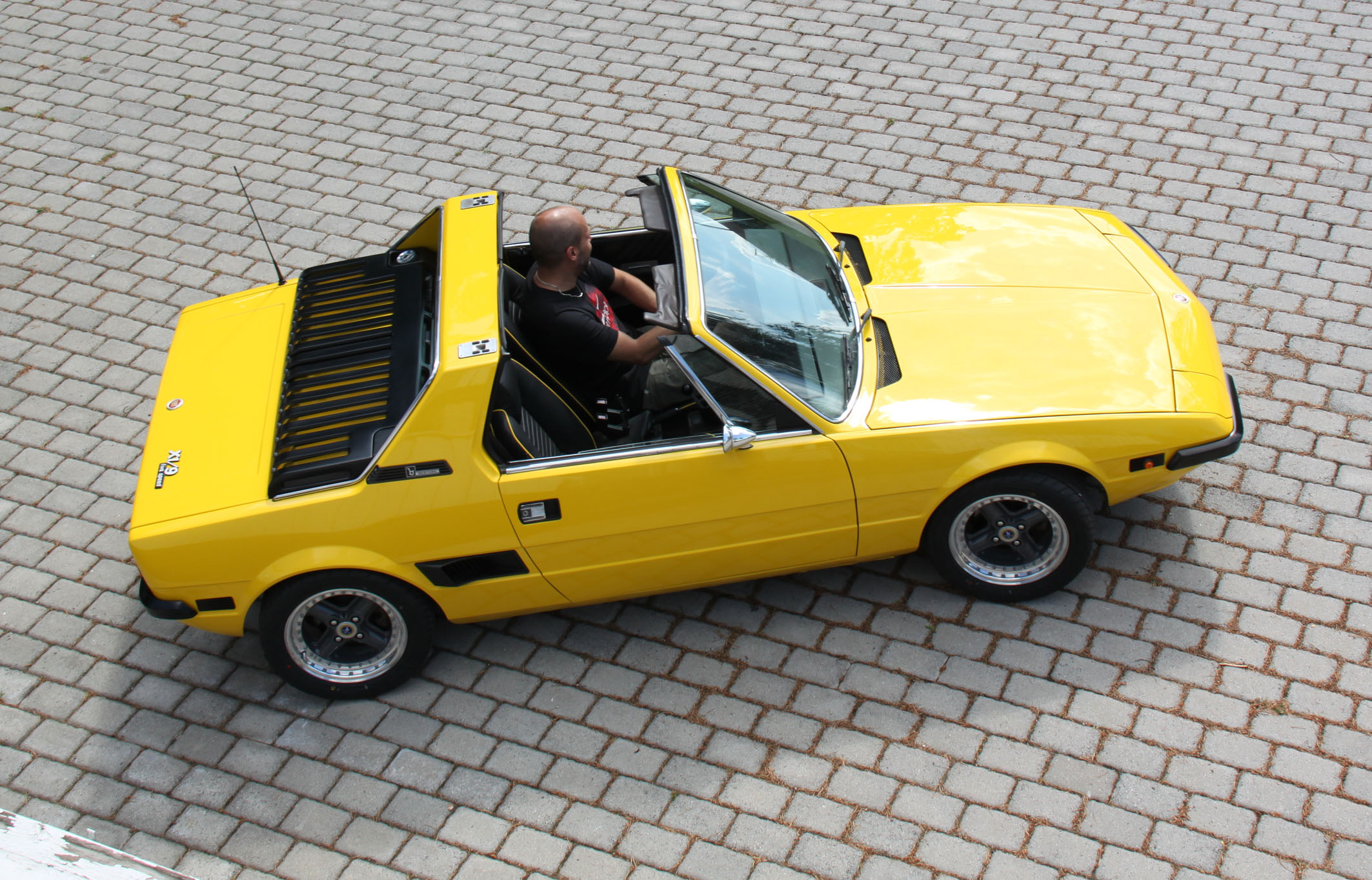

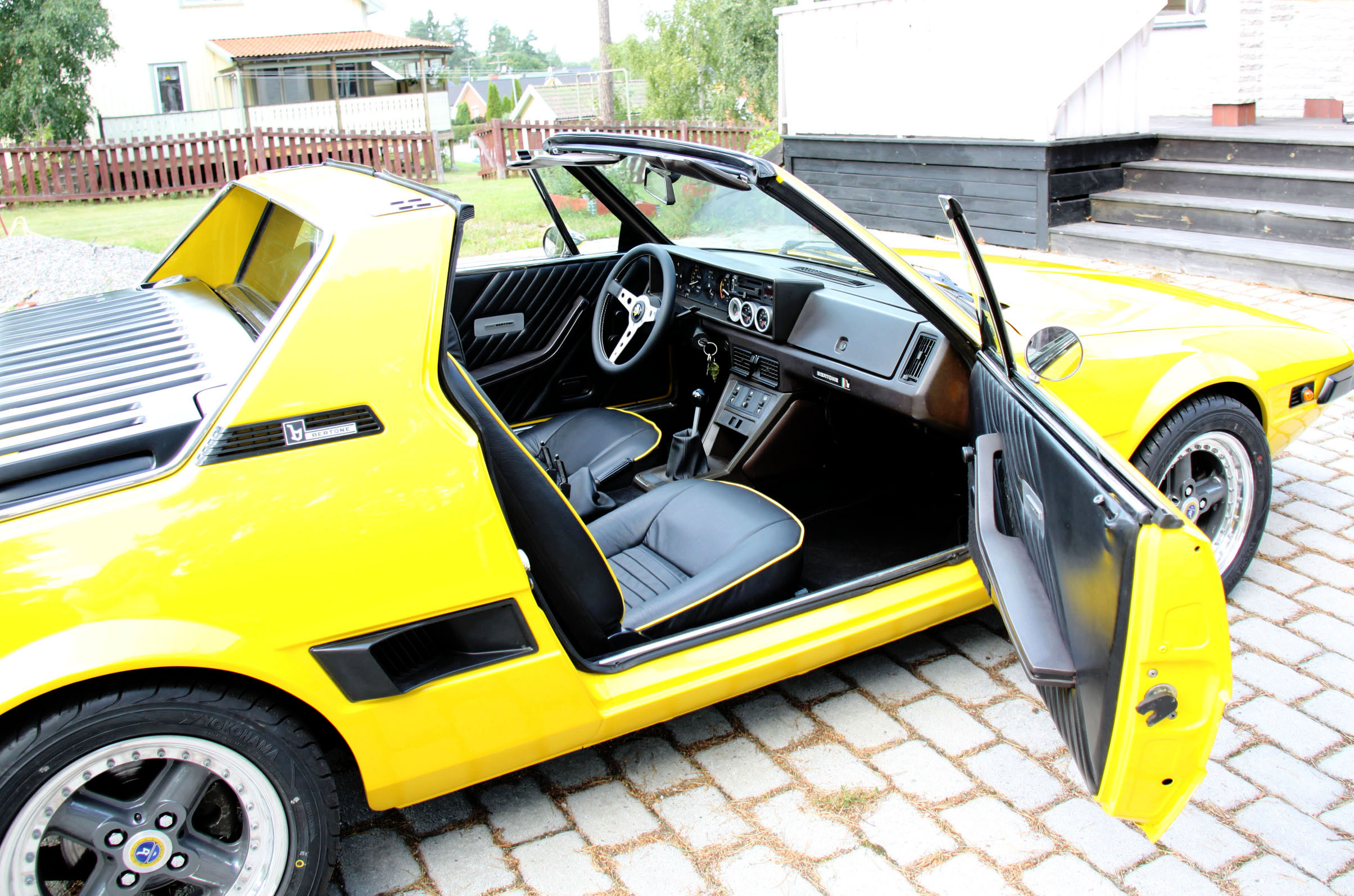

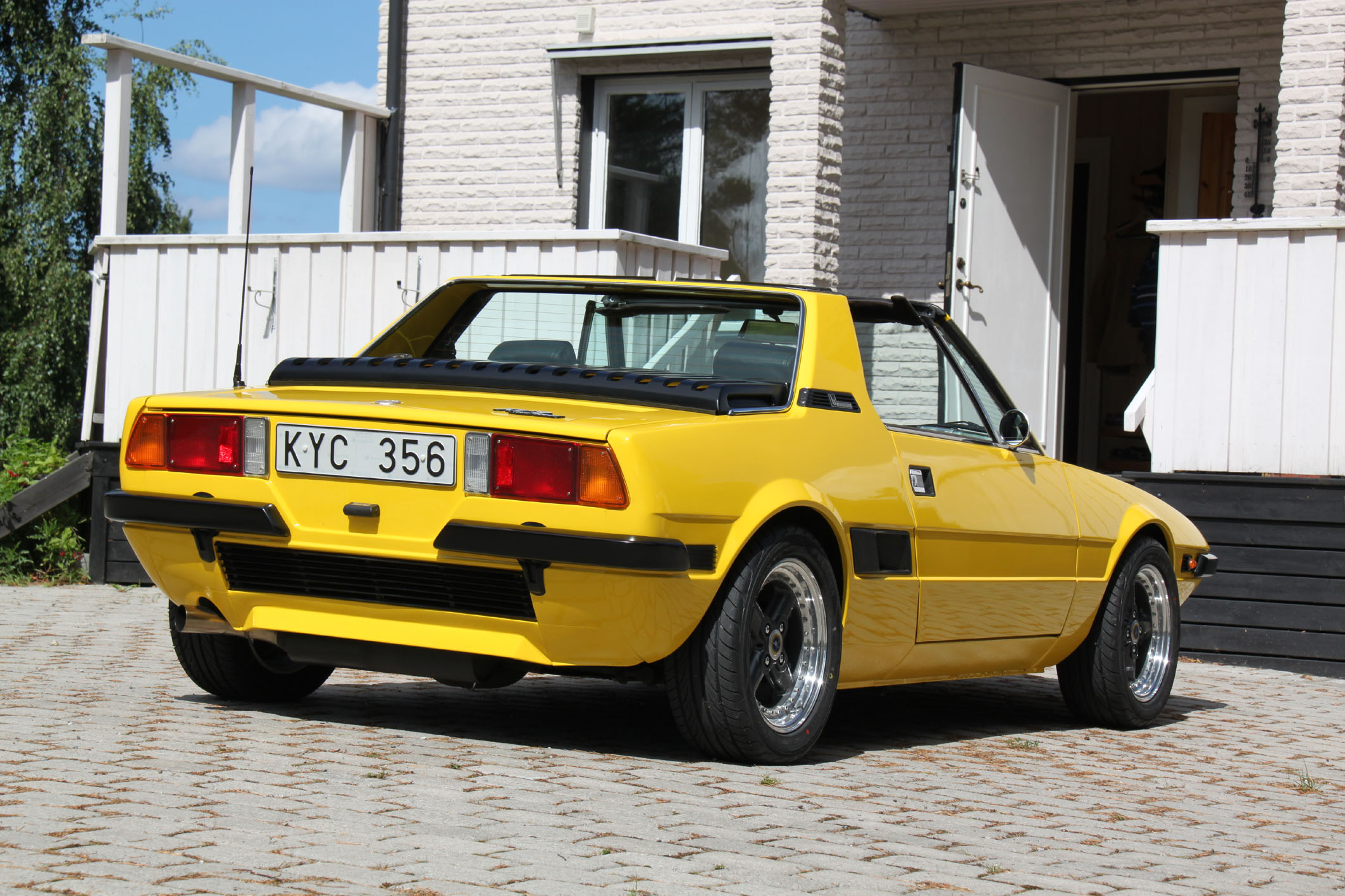

Hi, my X1/9 Uno turbo conversion was finished this summer and I've had a few nice weeks with the car so far. I collected some good advice here along the way (mostly from the Uno section) and couldn't be more thankful.

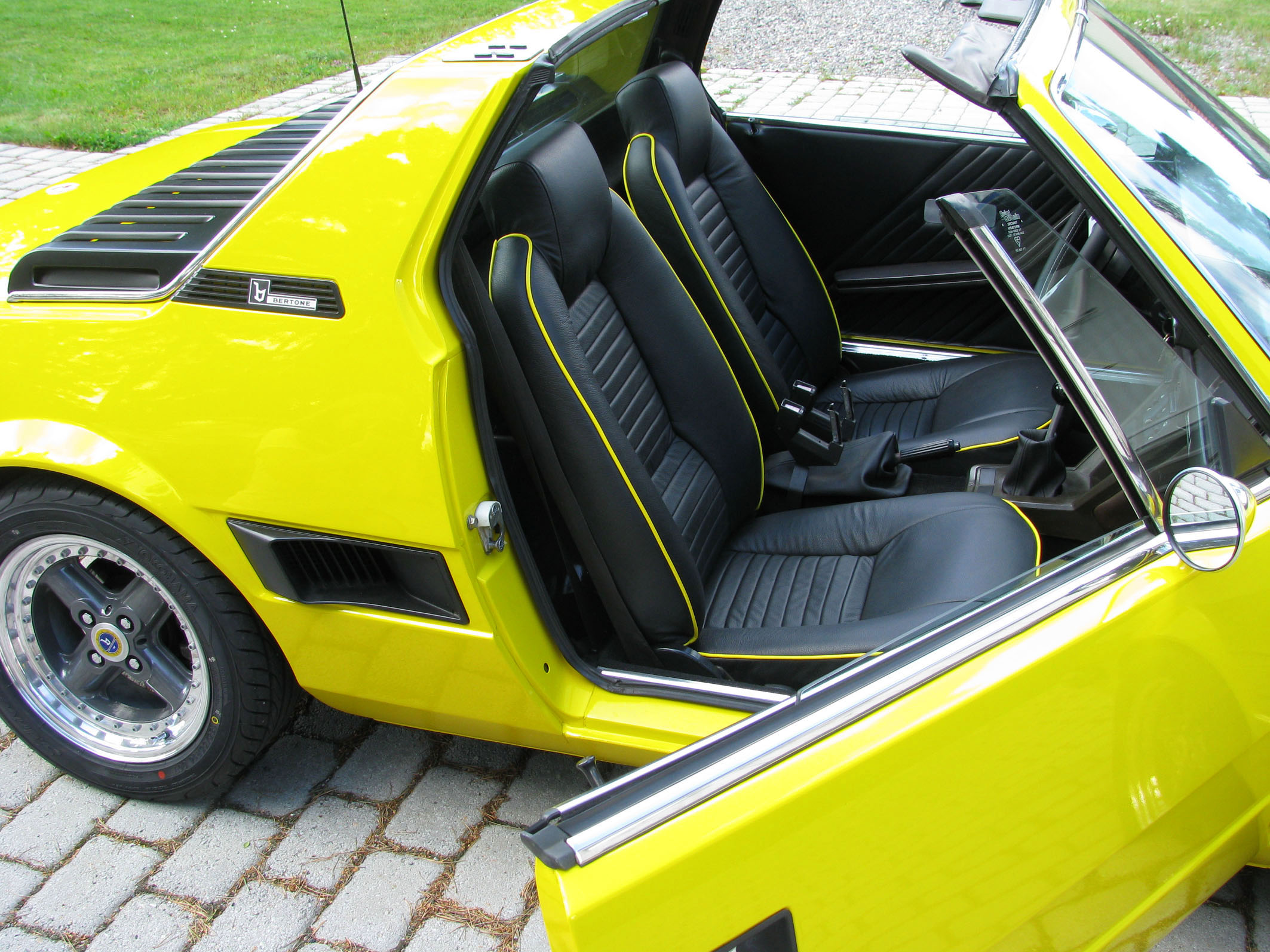

A few years ago I restored the bodywork and this year I also upgraded the interior with leather seats among other details.
Here are some pictures of the car. Hope you enjoy.

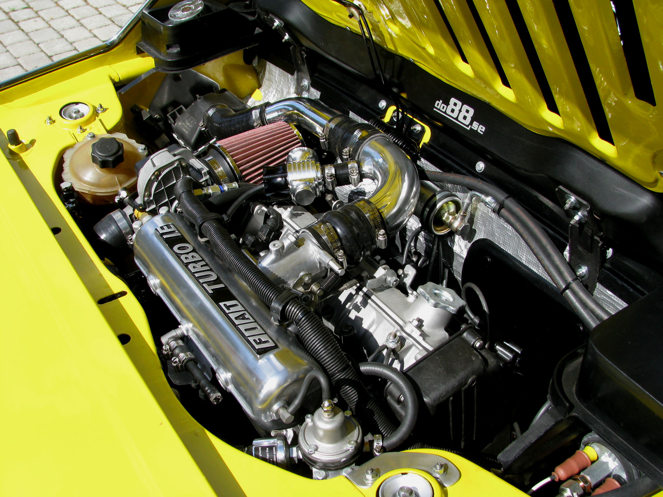

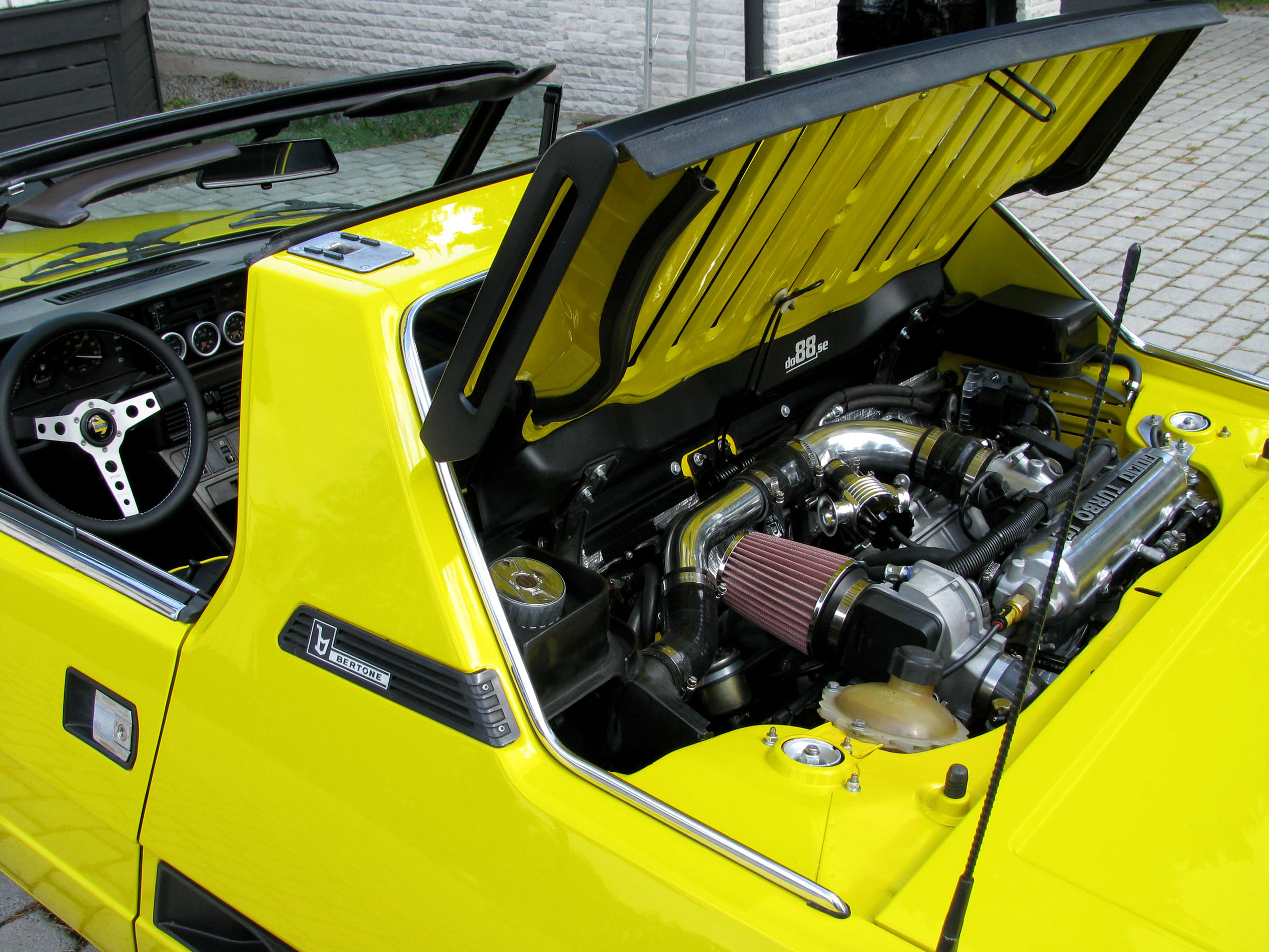

This looks very good. Are you running an intercooler, if so where did you fit it? The convertion looks very professional, i like it. Please let us have some more pics.

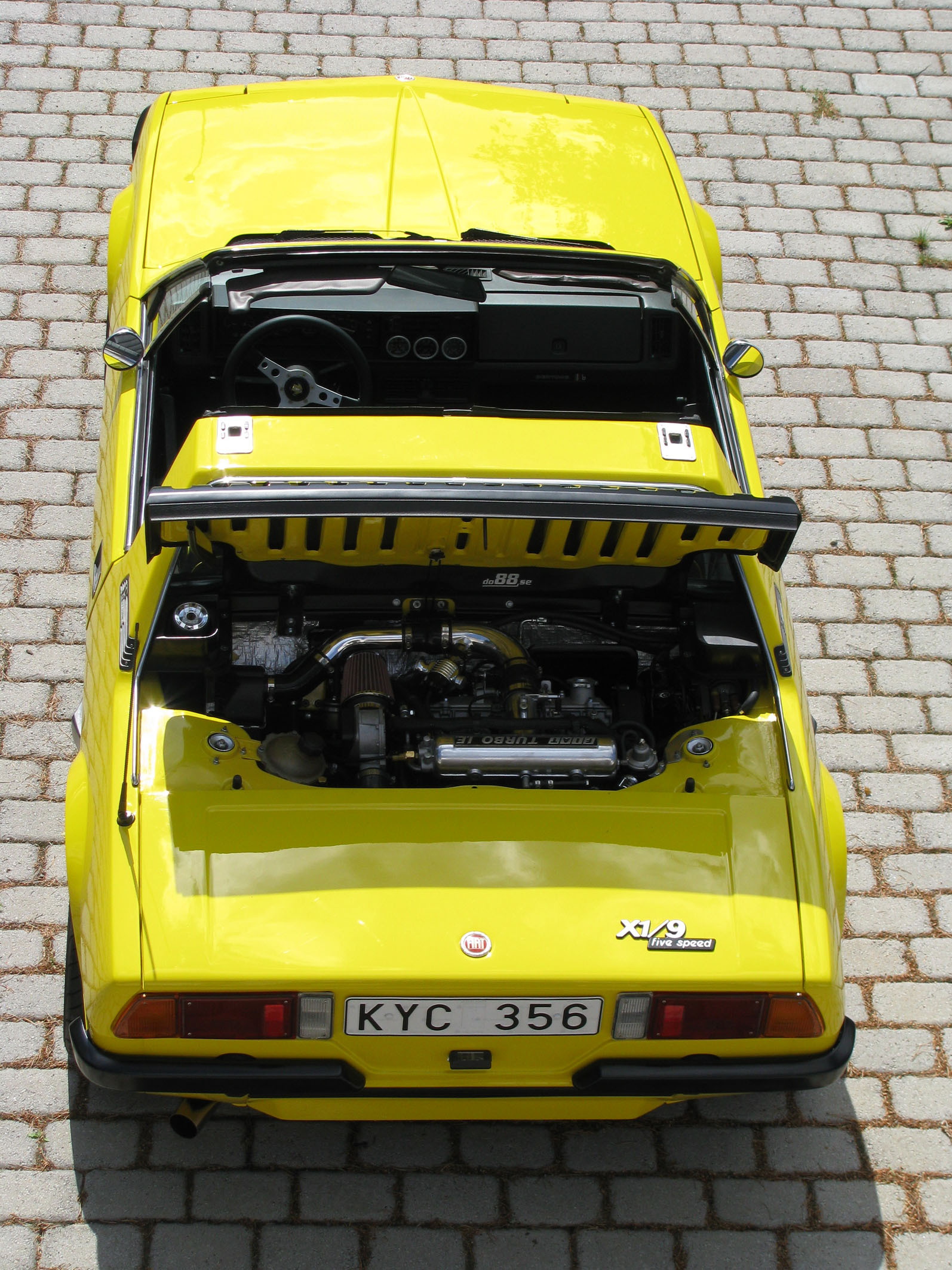

Yes, I'm using the Uno standard intercooler. It's fitted on the left side of the engine bay and breathes through the air intake on left wing. It can be seen on a couple of the engine bay pictures above. It's not an ideal location when it comes to air flow, but it's hard to find alternatives if you want to keep the bodywork intact.

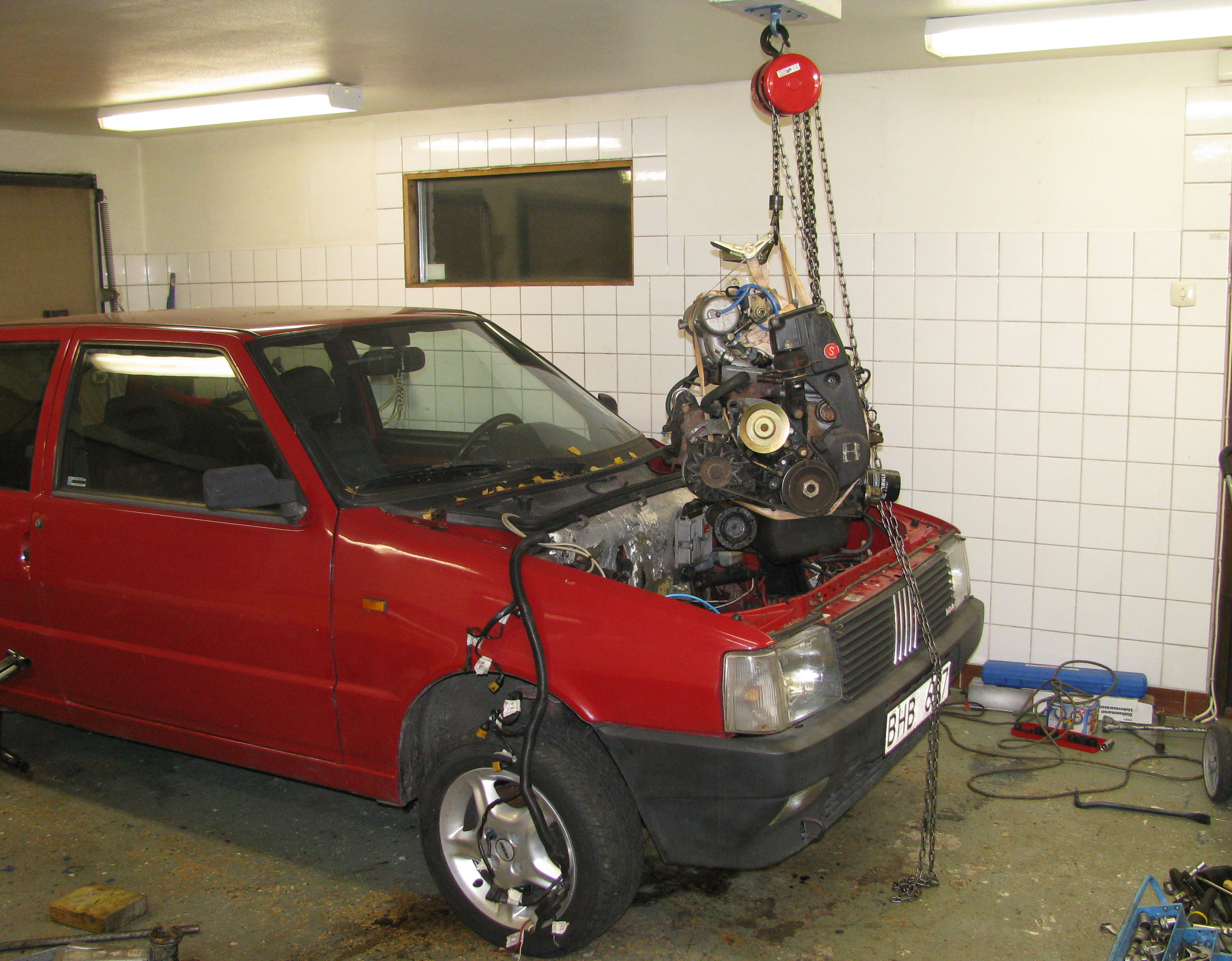

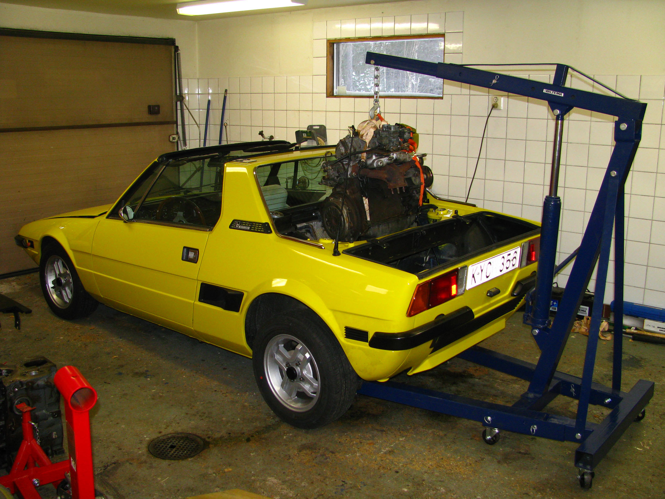

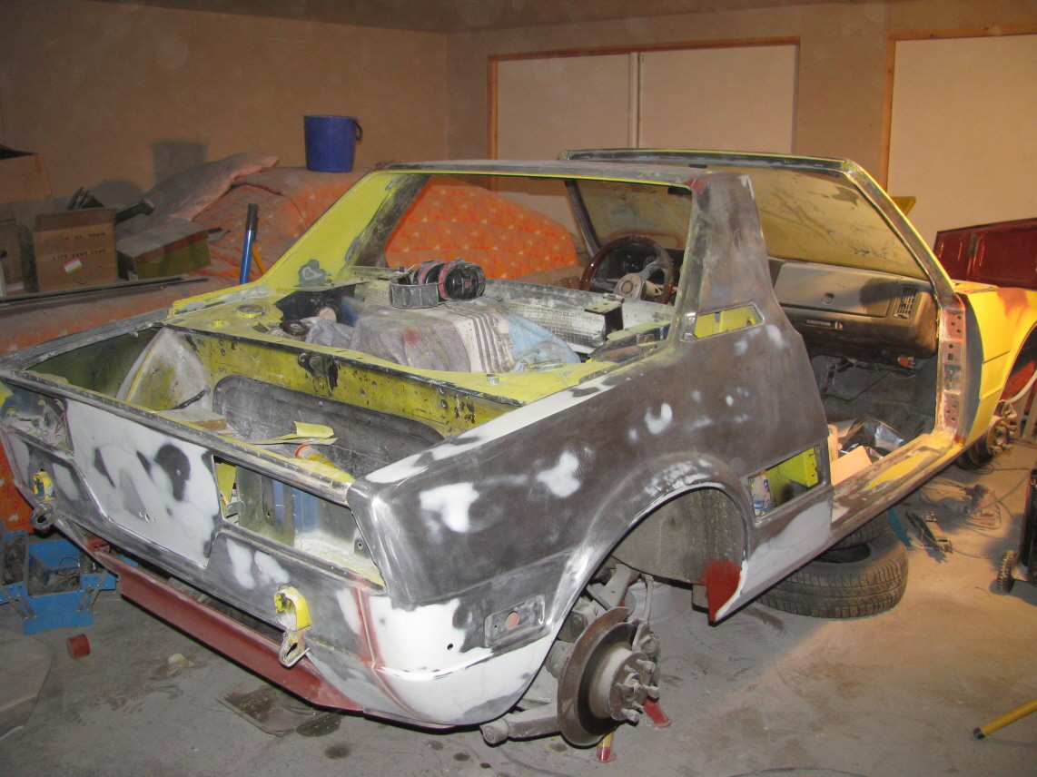

Hi all, some more pictures as promised! A few from the bodywork restoration also, and a glimpse of the engine doner and a glimpse of myself.

have you thought about charge cooling. this is where the air from the turbo is routed though a liquid cooled core to the inlet plenum. it gives full boost all the time rather than losing boost through heat. You need an additional radiator core at the front, a charge cooler, and pipework. Toyota Celica GT4's are chargecooled to give you an idea of what you need.
Hi, not seen the pics but thought I would just chip in! I have had 2 of these in slightly various forms. On both my cars, I located the intercooler below the body to get full air. If the car has not been lowered, don't worry about catching it (That only happenes when you mount a curb too fast!!).

About the intercooler location: Yes, I have considered using liquid cooling but it's just a thought so far. I'm aware of the not so ideal location of the air IC on the left in the engine compartment, but that was the only way to go to get the car ready and running for this last season. Since I live in a country with hidious winters the car is locked in for several months and then suddenly the summer is over us again and EVERYTHING is supposed to be ready, because soon the season is ended and you have to wait til next year ... again ... Kind of a stress factor.
Before mounting the IC where it is today, I actually tried to find a location under the car, but there is not much space ... at all! This is a car used on roads so it simply can't be fitted too low.
