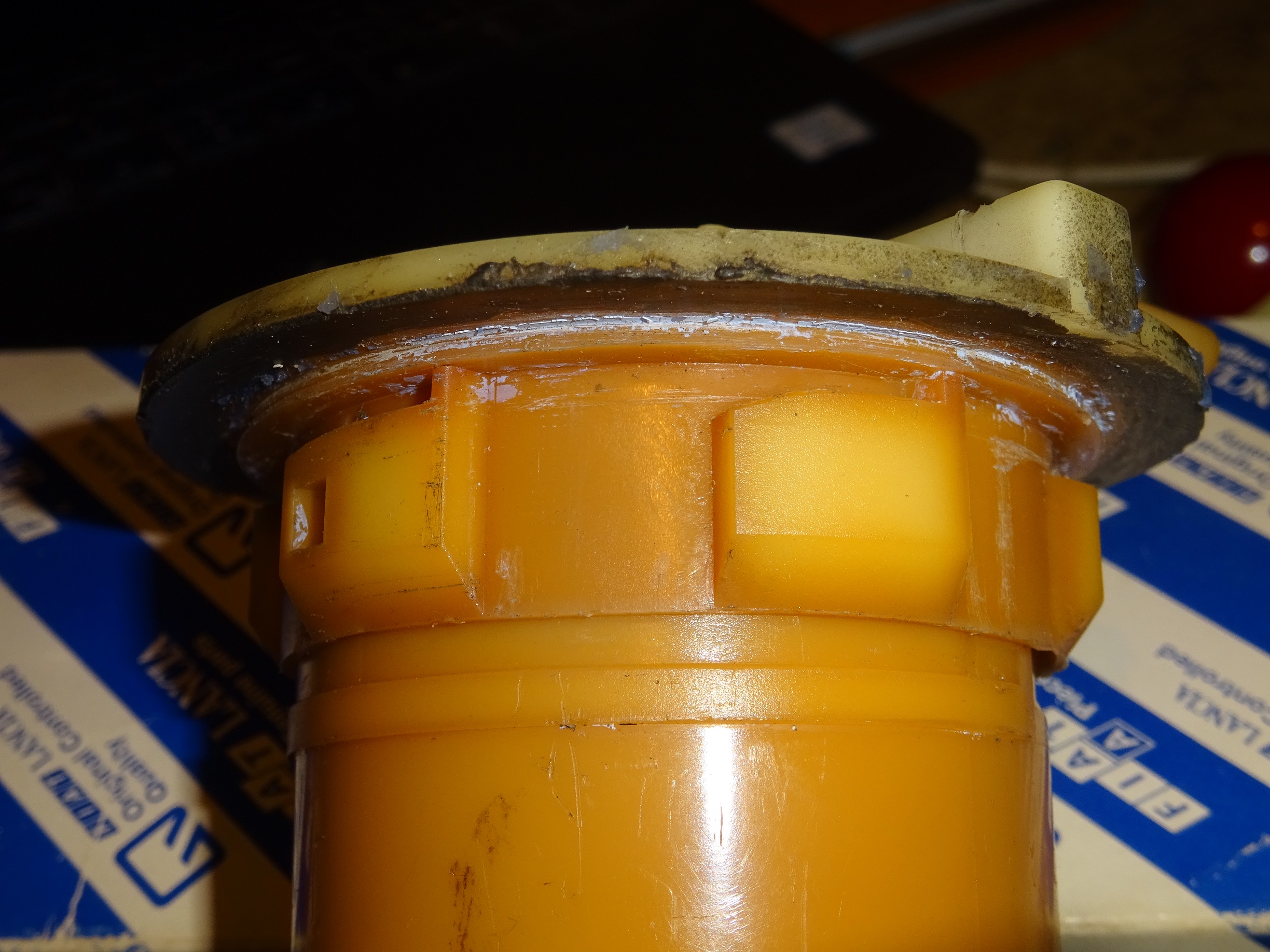

I have an `89 uno 45 with a leaky fuel sender unit. I bought one off ebay, genuine BNIB, and according to my research the part No fits all carb models 83 on. But looking again at pics it seems to be a plain round body at the top - ie without the 6 `bayonet` tabs which locate in the hole in my tank. My question: are there 2 types of tank, are the plastic ones different to metal, which ones have a circular retaining ring? Any info welcomed as it seems this new unit is completely wrong (not arrived yet)

Thanks for your reply. The original fits in a steel tank, circular hole with 6 cut-outs which align with the 6 tabs on sender. Like a bayonet fitting?

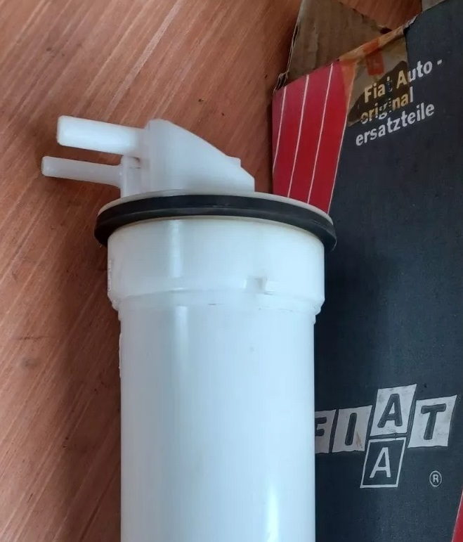

The new one (which hasn`t arrived yet) seems to be a plain round case, as though it is retained by a ring of some kind
Does the 2nd type fit the plastic tank or something? The part No shows as fitting ALL uno 999s `83 to `95. Also All the tanks on ebay seem to have the 6 cut out hole - except the inj. ones which are a rounded off rectangle with studs.... Any ideas?

View attachment 447808 The new one (which hasn`t arrived yet) seems to be a plain round case, as though it is retained by a ring of some kind
Is there any chance the new plastic one can operate like a bayonet fitting like yours, I can't see clear enough from the picture?

Many thanks for your help, sorry for my delayed reply, was rather hoping the new sender would come yesterday and I could see what`s what.... It is bewildering. Haynes talk about early mpdels having a sender with retaining ring until `84 when they had plastic tanks! Mine is an `89 with a metal tank & bayonet fitting so Haynes are completely wrong. I`ll just have to see what comes in the post, at the moment I`ve smothered the perimeter of sender with silicone, I know it won`t last but at least it`ll keep the smell down till it comes off the road for winter. Incidentally this will be its 3rd sender. I have an older Ford with basically the same arrangement for the sender, tabs which locate in tank, bayonet fashion, never been a problem. The difference is, that`s made of steel so it can stand long term stress whereas the Fiat`s is plastic and over time deforms due to constant stress and the pressure on the gasket relaxes. Annoying.
