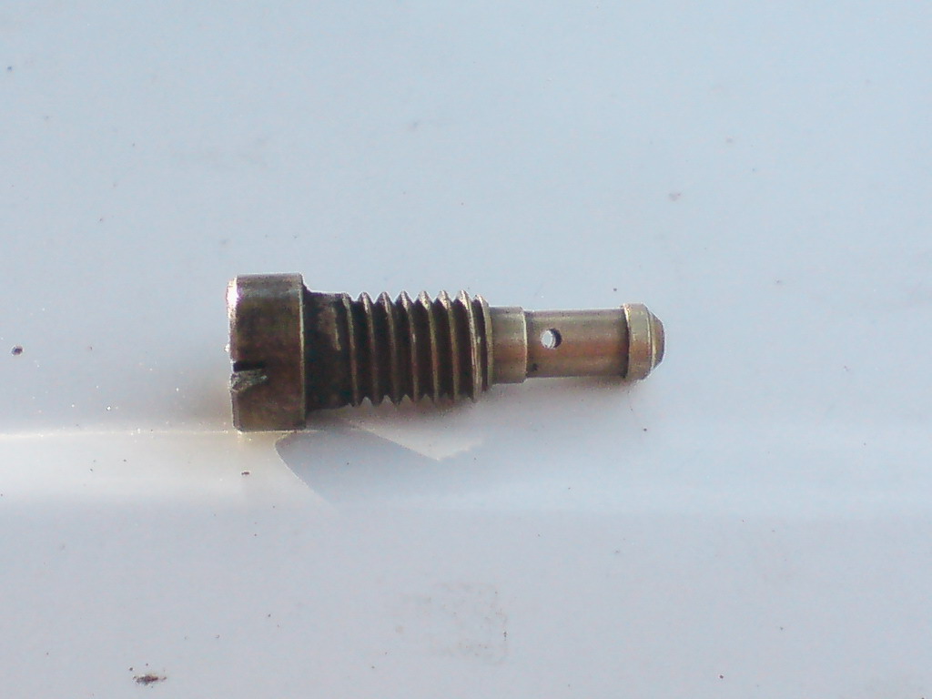

Just a question.
My Idle jet is loose in the hole so I can ajdust it and the car works fine for a bit then it vibrates tight again.
Any suggestions? (I have tried replacing it to no avail)
Alex thanks for the above info on carbs :)
Just a question.
Hmmm... odd problem. I think it should have a little O-ring on it. If yours doesn't, fit one. If it does, coat it with some non-setting sealant of some kind, to make it 'sticky'.
-Alex
I made 2 very slight dents in the thread and that seems to be keeping it where it belongs.
After doing the above trick with the drill my car is (so far, around 26km's worth of driving later) still running very smoothly and much better idling. Also seems to be running cooler :)
I had a spare carburettor in the garage so used the jet from that (it already has parts missing. I keep it for spares).
Not sure where an O-ring would fit on the jet?
Hi, nice close-up pic there.
The O-ring fits under the screw-head, on the flat part.
-Alex
Thanks, I'll go see what the local shop has.
The Carburettor Kits I have bought so far never come with something like that.
Thanks on compliment about the pic :D . Cellphone camera (S-E K810I)
