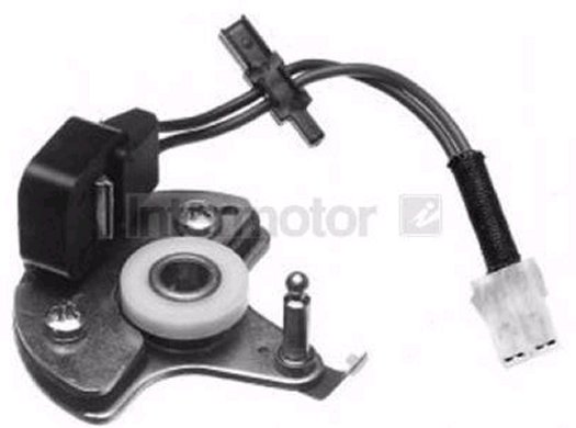

After an hour of further searching I found this, which crossreferences to the Duna, Fiorino, Regata, Delta & Strada 1.3 with Marelli distributors, see if the pic (at the bottom) is the same as your pick up....
http://partfinder.smpeurope.com/index.html?p=156&partid=14022&from=153&recordset=208&value=14022
Replaces
Fiat 9939788
Fiat 9941231
Fiat 9941693
Hüco 138193
Lucas DPB812
Marelli 71328401
Marelli 71347301
Marelli 71349101
This is the dizzy breakdown for that pick up on eper:
http://www.spangerum.com:7080/navi?...INT_MODE=0&EPER_CAT=SP&WINDOW_ID=1&GUI_LANG=3
And if it is that one, you can pick it up here for £15 delivered:
http://cgi.ebay.com/ebaymotors/Lanc...ptZMotorsQ5fCarQ5fTruckQ5fPartsQ5fAccessories
Or here (in the UK) for £27 delivered:
http://cgi.ebay.co.uk/NEW-Gen-Fiat-...arts_Vehicles_CarParts_SM?hash=item5885f47a7d
Hope that helps :)
