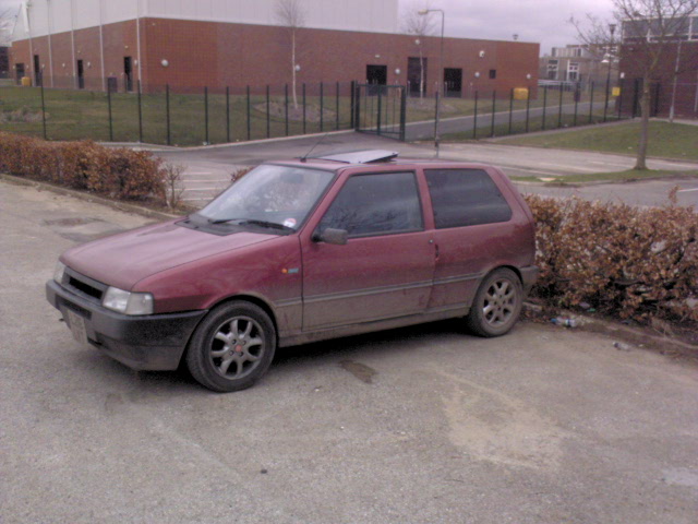

my 3 door R.I.P
Bit dirty but nothing wrong ( except the no. plate). lowered 30mm on standard 14in seicento sporting alloys and tyres ( had to use extended bolts on the rear wheels, as the original bolts only went in about 3 threads )

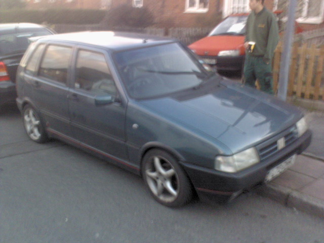

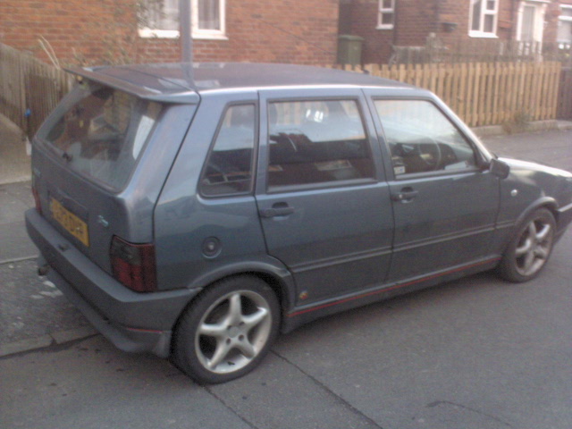

My 5 door ( Thanks 1.4 ies )
lowered 60mm on 15in tsw alloys (195/45/r15). turbo kit, dials etc. full fiat coupe leather interior.
