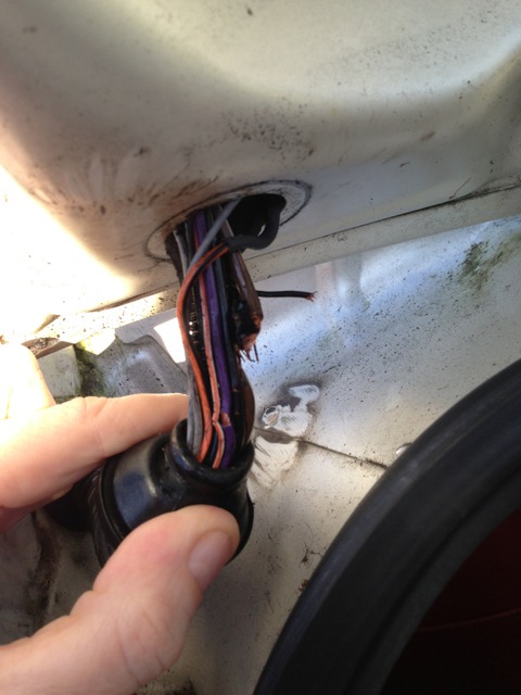

best way to tell is to very gently pull back the rubber hose covering the loom from one end to the other, if you see broken wires you hit the jackpot!
then its up to you how you repair, though like some of us on here we bought an improved loom on ebay that is made with more flexible wire! and basically cut out the rot and replace
time consuming (took me a whole afternoon) but not difficult
or you could just soldier and sheaf the broken wires though it will prob go again!
Inside the rubber boot on the tailgate it could look as nasty as this!
