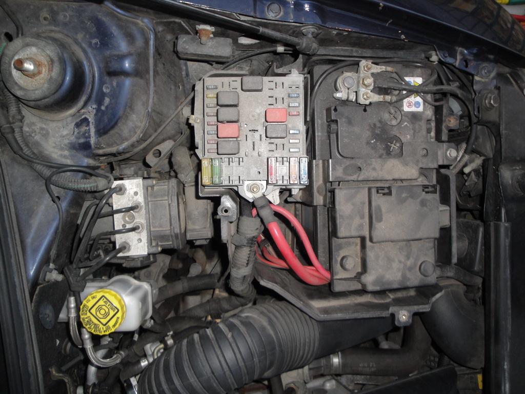

I came home a little earlier today and figured out I might as well give it a go, the instructions did not seem very hard.
Turns out I'm really stuck. I've opened the battery cover, and with the printed instructions I tried to find the bleed nipple. I couldn't find anything that even remotely resembles the part i should be disconnecting. I'm thinking it's more and more a dealer's job, and if it's something simple I should be able to run out with only 20 pounds fee.
I've posted some pictures of what I saw when I opened the battery cover.
Can somebody please direct me to the right place?

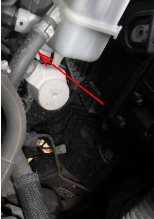

Also, because it was almost dark when I made them, after downloading the pictures I saw there is some kind of leak from the part pointed by the arrow in the last picture. What is that? :confused:

It's a little tricky as everything is in a different place on lh drive car than we're used to here.
But this hose from the brake/clutch hyd reservoir will lead straight down to the clutch master cylinder
It looks like you have a rigid metal pipe rather than a flexible hose which leads from your clutch master cylinder to the slave cylinder
And this pipe guard above your slave cylinder may be obscuring your view
The brake and clutch systems share the same fluid resevoir as a safety feature. The clutch supply pipe it located part way down the resevoir so that if there's a fluid leak from the brakes, the clutch will stop working before the brakes do.
The clutch master cylinder supply pipe for your LHD 1.8 is the one with the yellow arrow in the bottom picture. If you follow it, it will go to the clutch master cylinder which should look something like the first diagram.
The only other pipe on the clutch master cylinder (1b in the first diagram) goes to the concentric slave cylinder which is inside the gearbox. You may need to remove the metal plate shown in the second diagram to see where the pipe goes into the gearbox.
