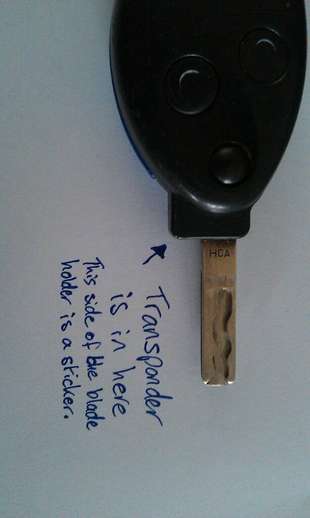

Hi, does this help?
Thanks - transponder fitted, programmed! Now have two keys that will start the car - BUT NEITHER will open doors/lock/unlock! Same problem as you have. Bugger.
