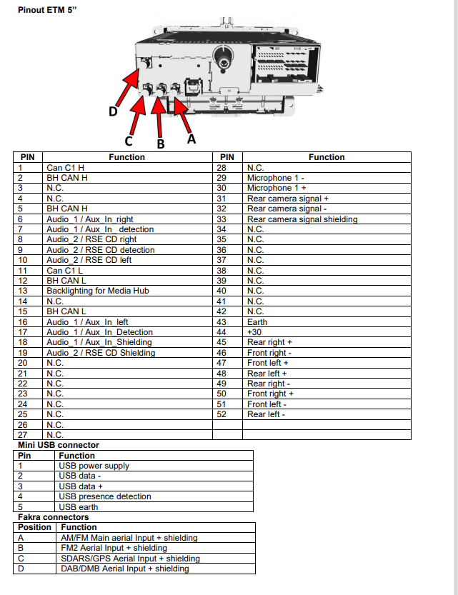

I'm pretty sure there are alternative (i.e. Not uConnect) systems available, with or without Nav, compatible with the USB ports etc, for much less than £1k, the problem (as I understand it) is maintaining the Settings functions and Hands Free for your phone.
There are connectors on the net which claim to retain these functions but I'm not savvy enough to read through the gobbledegook.
