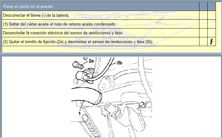

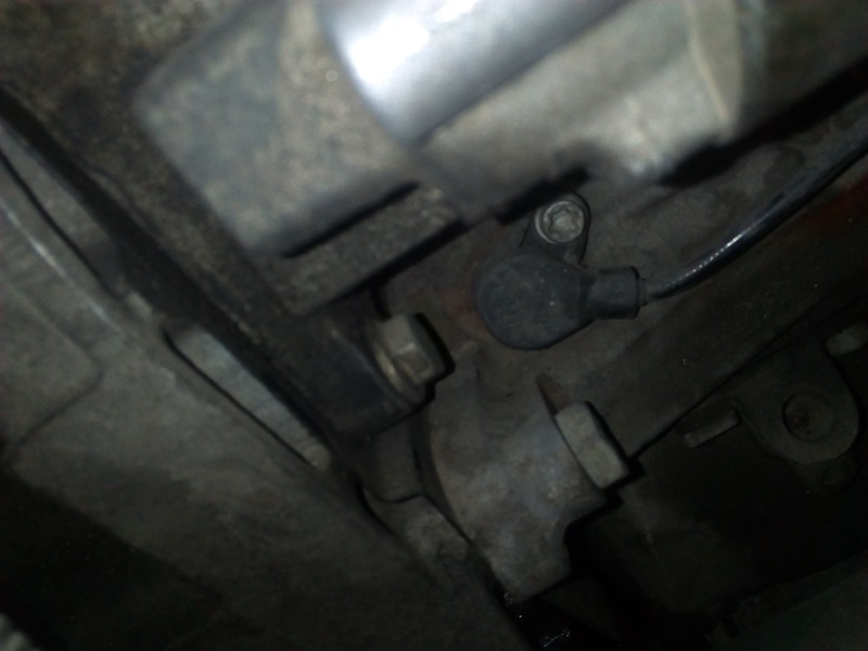

L Luiscorti New member Joined May 10, 2022 Messages 1 Points 1 Location Lugo May 10, 2022 #1 Tengo un Fiat multipla 19 jtd 105cv donde va colocado el sensor del cigüeñal para cambiarlo gracias
B babay Member Joined Mar 3, 2022 Messages 15 Points 53 Location Lesz May 11, 2022 #2 similar engine:
T Txuchin Member Written a guide Joined Feb 20, 2011 Messages 100 Points 70 Location Las Tablas (Madrid) May 11, 2022 #3 The location is slightly different in the Multipla but it is in the same area: La ubicación es ligeramente distinta en la Multipla pero está por la misma zona: Nº 3 y 4
