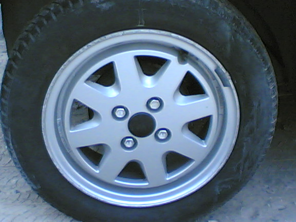

hi guys
i just got a really nice set of original lancia alloy wheels
they are 5.5x14
i`m gonig to change my current tyres very soon
i know that the right size for the 5.5-14`s is 185/60
but what about 195/60
i just wanna know if there would be a problem fitting the 195
my car have standard suspension - no lowering and i just wanna
make sure that with the 195`s there will be no rubbing in wheel arches
or inside parts of the arches
thanx all

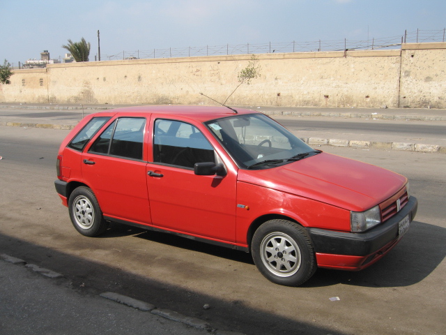

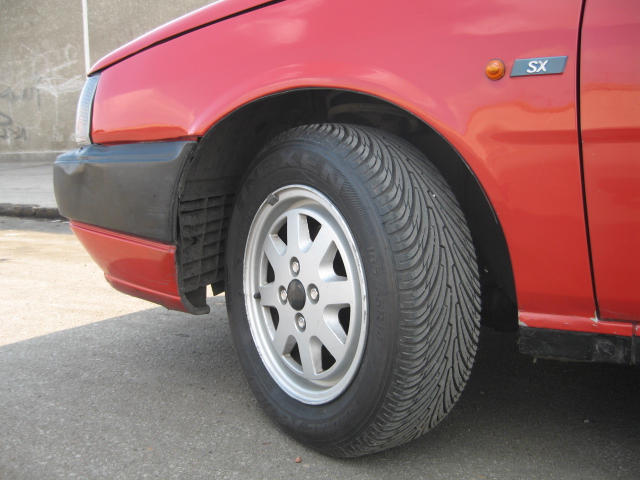

hi all
here`s my car after the tyres swap
sorry it took me so long to post the photo
thanx again
